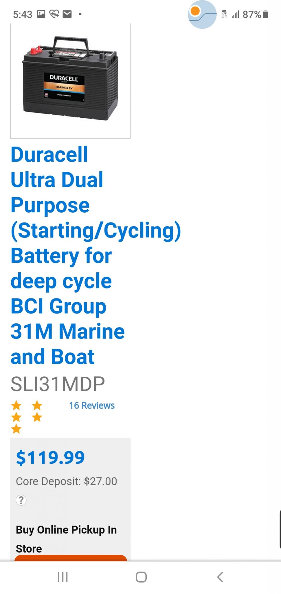

Myself, I'm running four wet cell old school Duracell group 31 in the battery box, $99 ea from Batteries Plus, they were just a few weeks old. In the sleeper, one deep cycle AGM battery that is connected to the battery box with the solar panels... Even one 100 watt panel with a controller will keep all of them fresh, even on cloudy days.

I've got four of the wet cells, and one deep cycle AGM hybrid battery in the sleeper, I looked into this when I hooked up my solar set up, and everything I could find was that they all charge the same. So, as long as they are all fresh, mixing an AGM should not be an issue. I have not had any problems with my set up.
I have run this setup for quite a few years, wet in the box, AGM in the cab. I really delved into all of this when I put the solar panels on the truck.

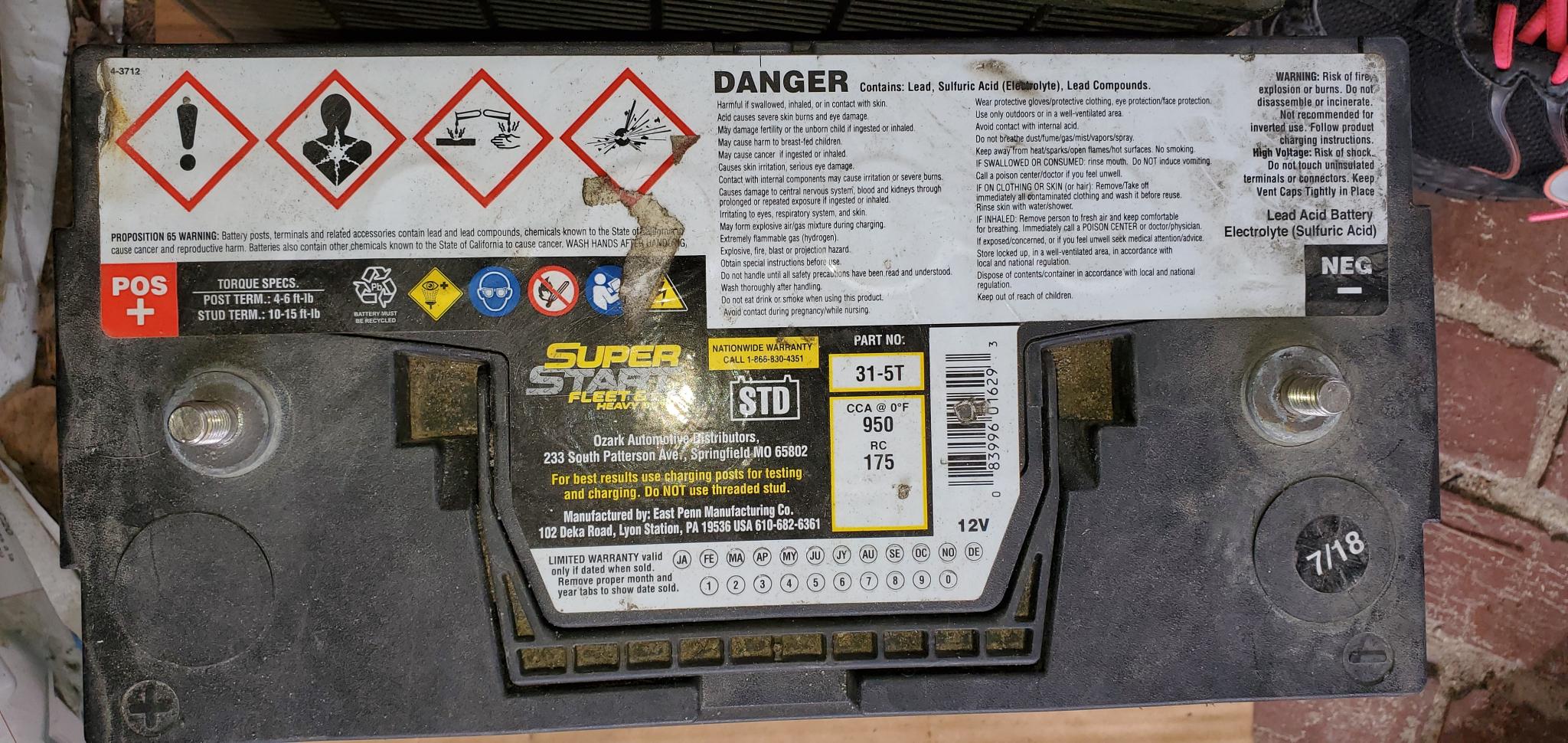

I bought the last batteries at O'Reilly and they lasted around 2 1/2 years. But I do run a pretty big inverter. I have been upgrading everything and will all the great advice here it's coming out great. This is the O'Reilly batteries, I think they did good. I think the ones I just got from Batteries Plus are just what I need. The CCAs are lower but so far it's been more than enough. When I change my starter I'm going with the smaller high torque starter.
