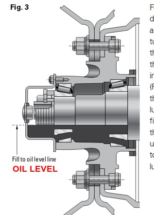

Background: 1984 Fruehauf trailer with a Pro-Par axle
The hub caps have a line molded into the plastic but I can't find an explanation of what it is. Is it a "Fill to Here" mark or a "Needs More Lube" mark. How much oil is enough, or too much?

I haven't seen a hubcap like that in a hot minute, but if I remember correctly it's is a minimum fill mark...that's the minimum needed to keep both wheel bearings submerged in oil. I suppose that makes the maximum the fill plug hole.

the marks are at the "critically low" indicator.
just fill it to the bottom edge of the black plastic and your good to go.
./uploads/202103/post_2_1615094781_a938b74cbcc7dec2c679189064f67ae9.jpg
(image is from an old Timken bearing service catalog).

Thanks guys
That makes sense
