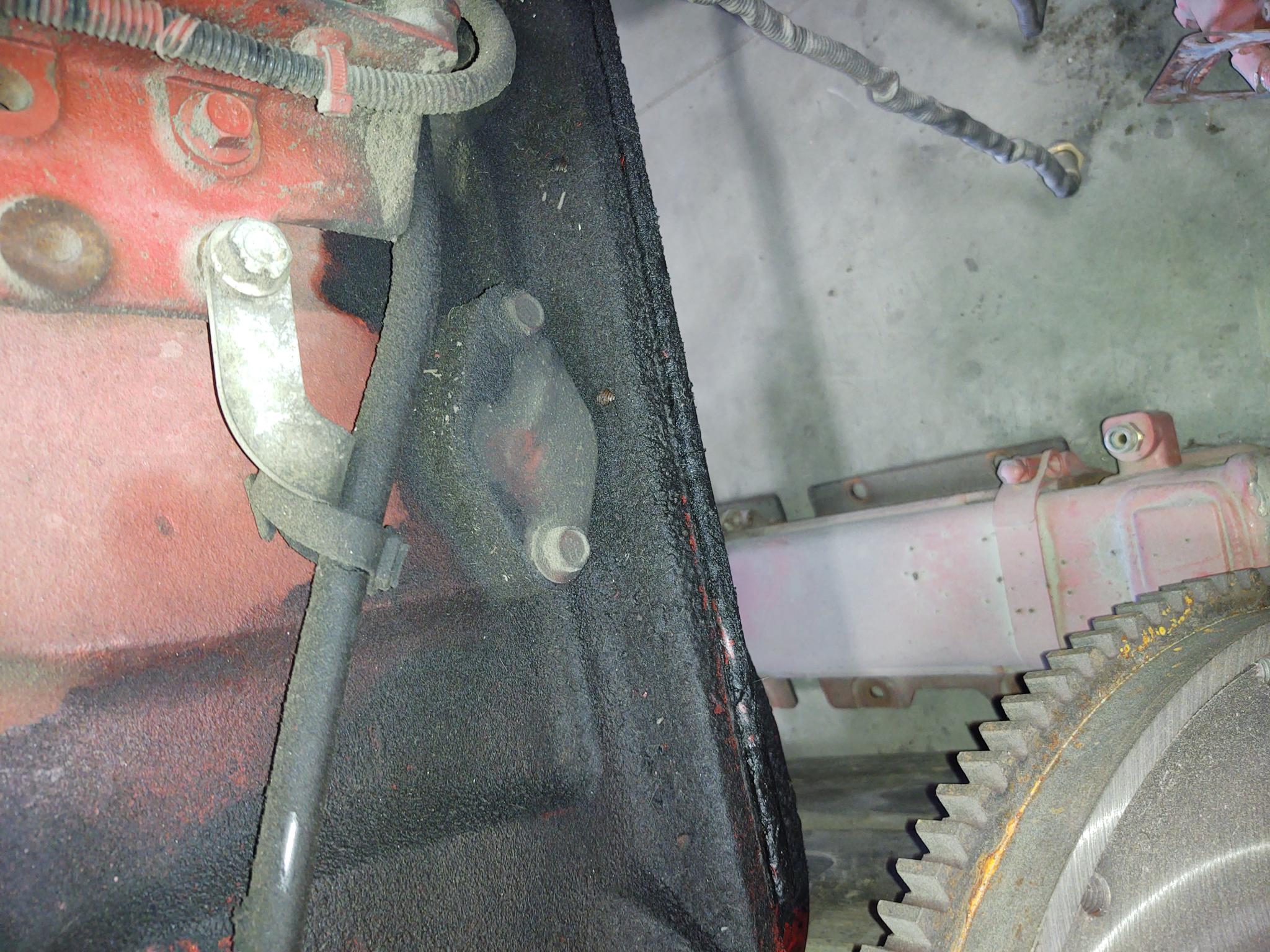

I'm having a hell of a time trying to find a gasket for this rounded diamond shaped block off plate at the passenger rear of the block, under the oil cooler. Can't find it in quickserve nor can my local dealer find it, and cummins is practically useless. The old gasket deteriorated but there was no part number on it. Anyone happen to know what it is?
I'm also trying to find an o ring for the coolant heater plug. Cummins doesn't list a separate o ring, just the plug. I ordered a plug, assuming it came with the plug even though it's not listed... hopefully it comes with one.

Picture I took of a newer ISX sitting around of the plate, for clarification.

Here you go, part number for the gasket you need is 3104119. You'll find this in the oil fill arrangement section on quick serve. It's used if your truck uses the rear oil fill option.
