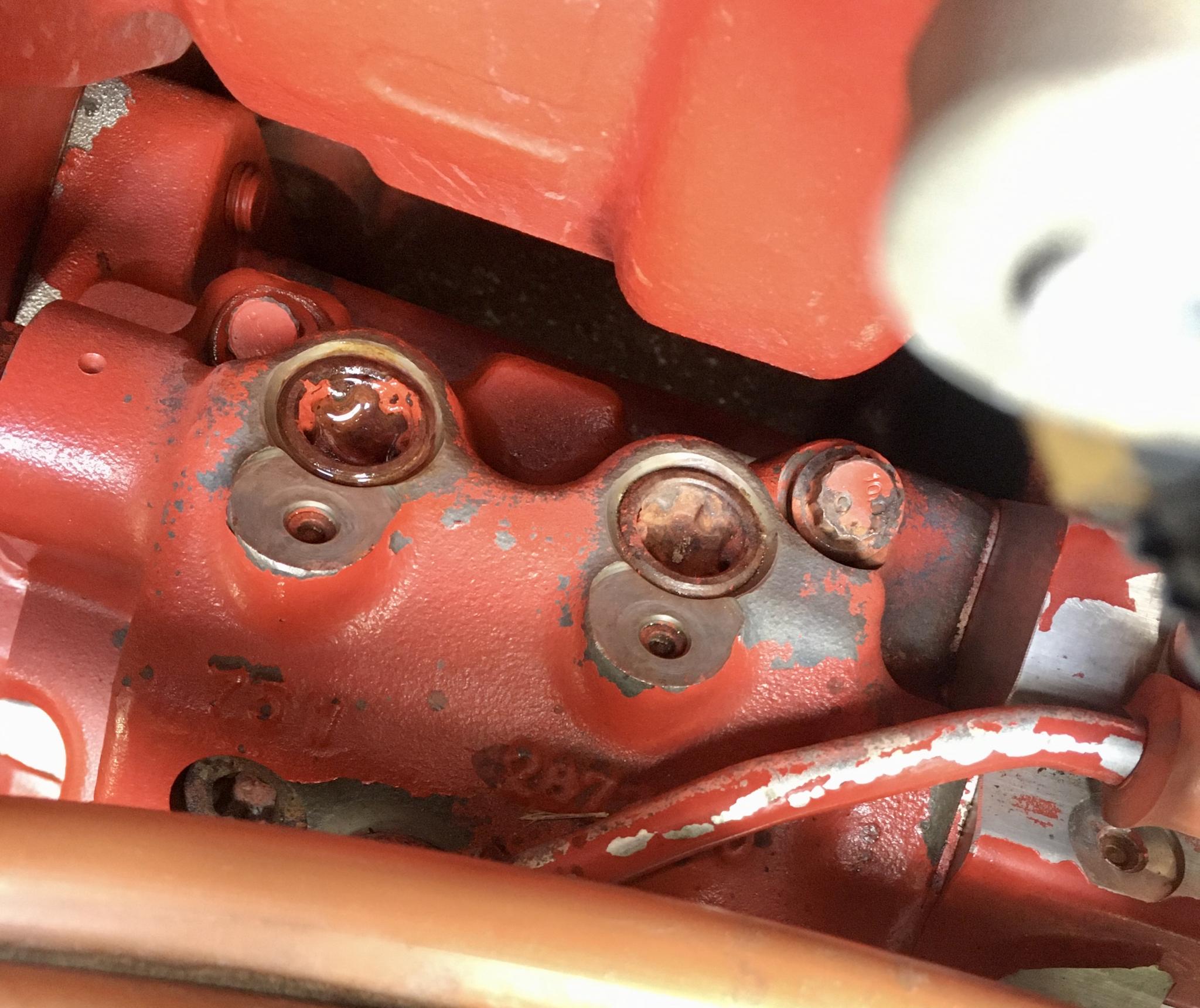

| Fuel leak from top of gear pump head Anyone familiar with these plugs on the top of the fuel pump head? Noticed a very slight fuel smell when I shut down for the day, upon further inspection, and after a clean-up, it appears the fuel is leaking through the torx plug shown in the pic. Don't see any info on Quickserve about it either. Only info I have found is they are not serviceable and can only be repaired by replacing the head----which would be ridiculous, but not at all surprising. - What is their purpose, and has anyone removed one to see what seals them? Figured I'd ask before diving in blindly and needing a 'backordered' part. BTW, This is on a cm2350 w/ about 490k. Replaced the guts of the FP a few months back again as a precaution. Haven't had any fuel or leaking issues other than this today. Performance has remained the same (although I haven't run a leak down test with insite yet with the discovery of this leak). | |||

RE: Fuel leak from top of gear pump head (04-16-2021 )tree98 Wrote: I don't have the answer but if it's just leaking a few drops like that, maybe just leave it alone and keep an eye on it. Yea, def will keep an eye on it ...just got it to the house and did some more inspecting.. Little wet on the bottom of the pump from the Torx plug leaking and running down. Couple of drips made it to the front axle (so it's leaking at higher RPM). What you see there happened within 25-30 miles after I cleaned it and ran it home. Leaks of any kind drive me nuts and I address them ASAP, but it would really be some $hit if I had to change the damn pump head for this, especially after just having it off and replacing the P/B assemblies....where's the hand to face icon when ya need one lol | |||

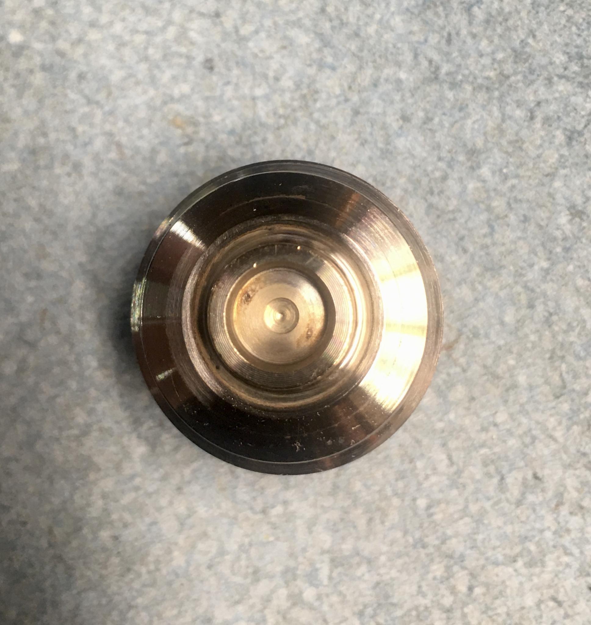

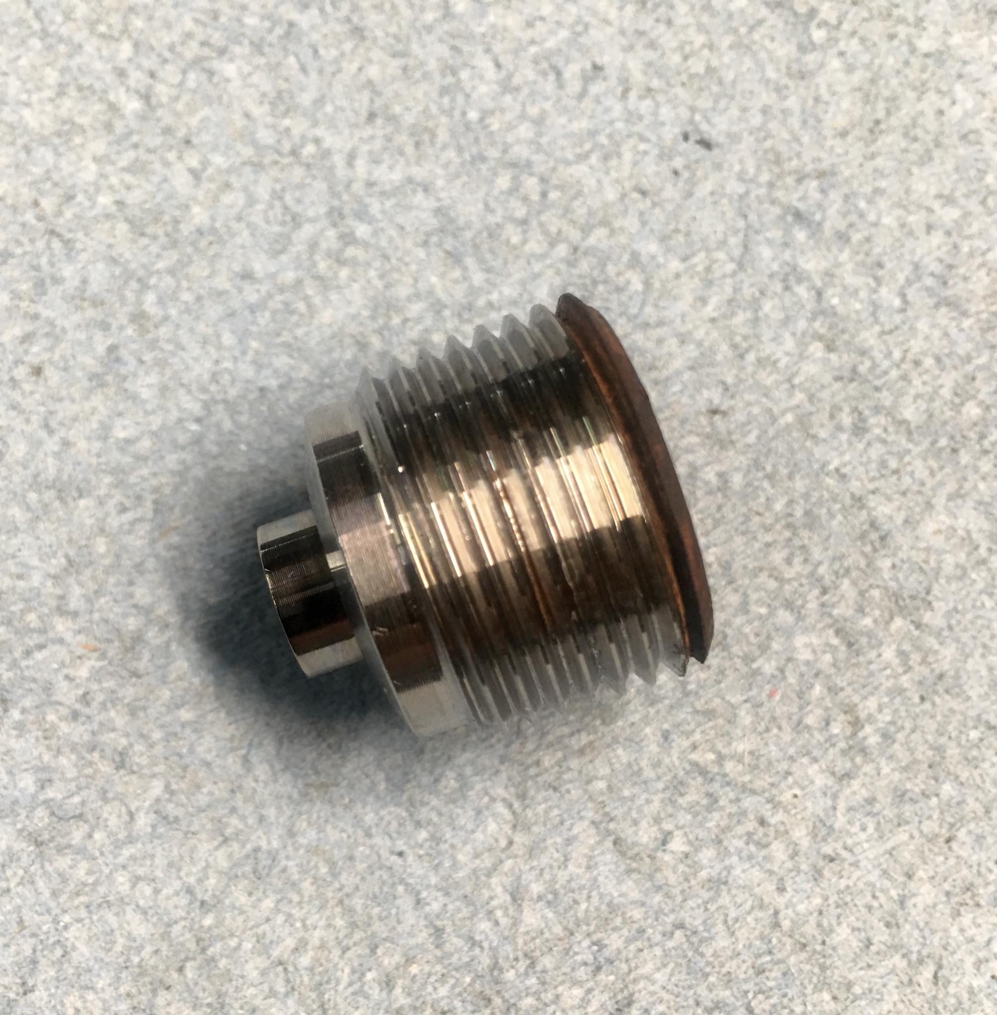

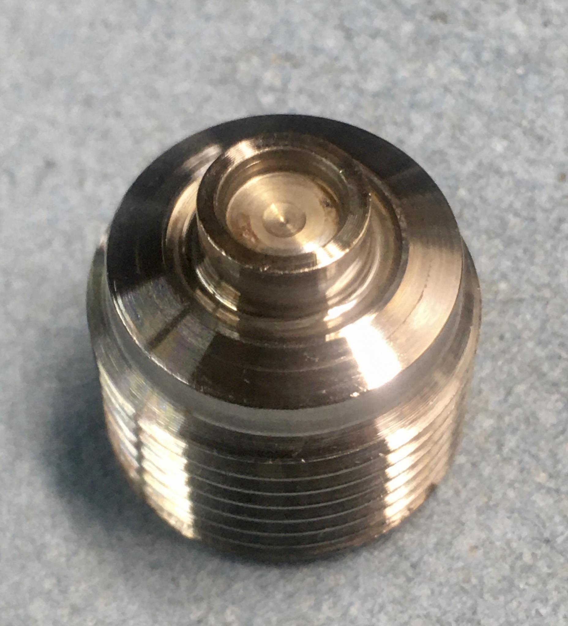

| RE: Fuel leak from top of gear pump head So, once again cleaned it thoroughly and let the truck run. Very very subtle, but looks like the fuel is creeping through the threads of the torx plug. Grabbed the torque wrench and moved up in small increments to see the force it would take to remove it. Seems like it broke free at about 85ft/lbs. (I used a t60 socket....I believe a T65 would be perfect, but only had a 60 and 70 in that range. Cummins may have a specific tool as the ends are squared rather that pointed like a traditional torx bit). Here are a couple pics I took of the removed plug. Seems to press on a spring loaded valve below inside the cavity. Also appears that it’s a machined surface seal. The plug has some very light marking within the center (maybe this is the issue?). Once tthe weather clears I’ll get some more pics and try to clean, reinstall and torque. | |||
