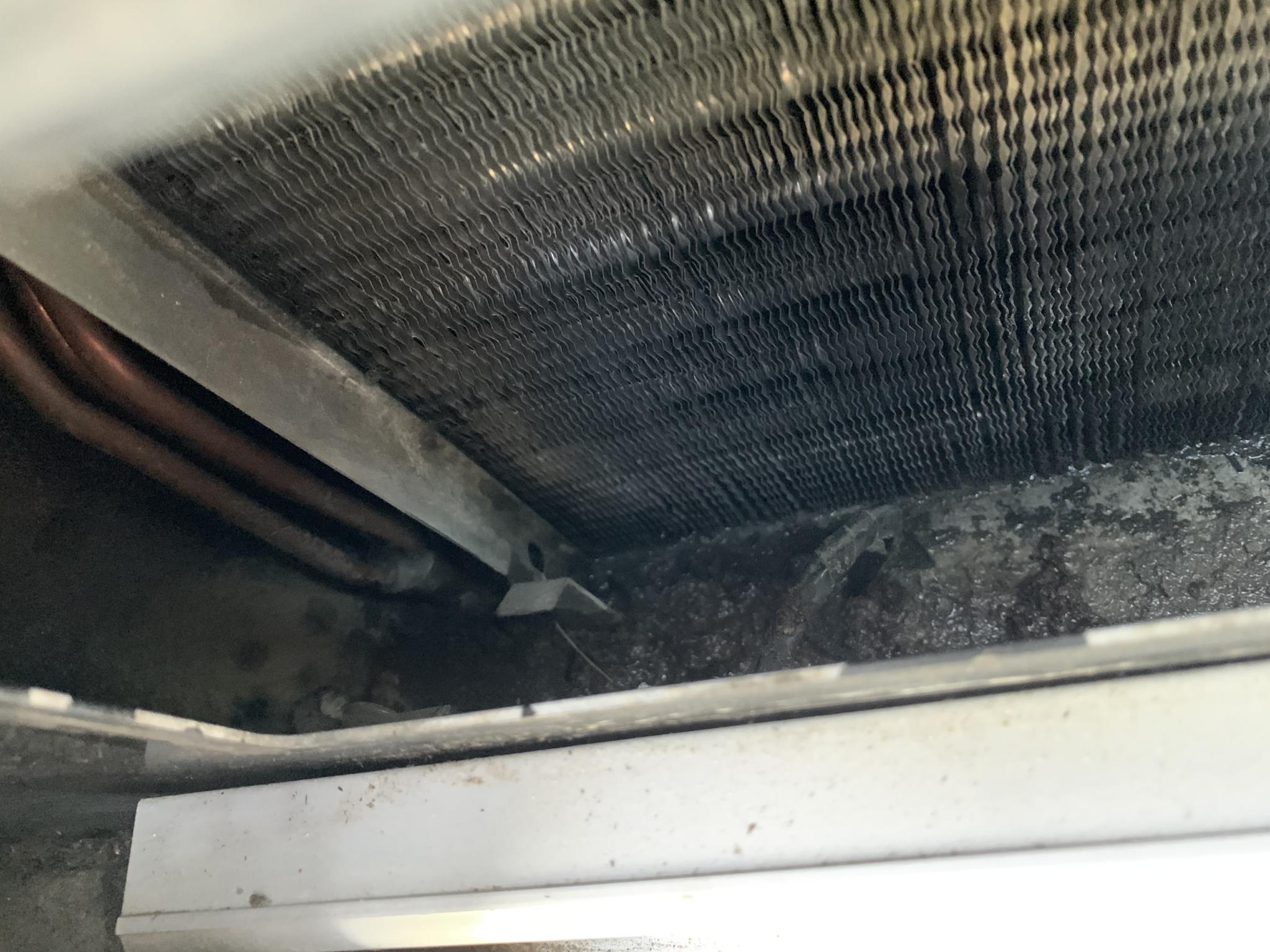

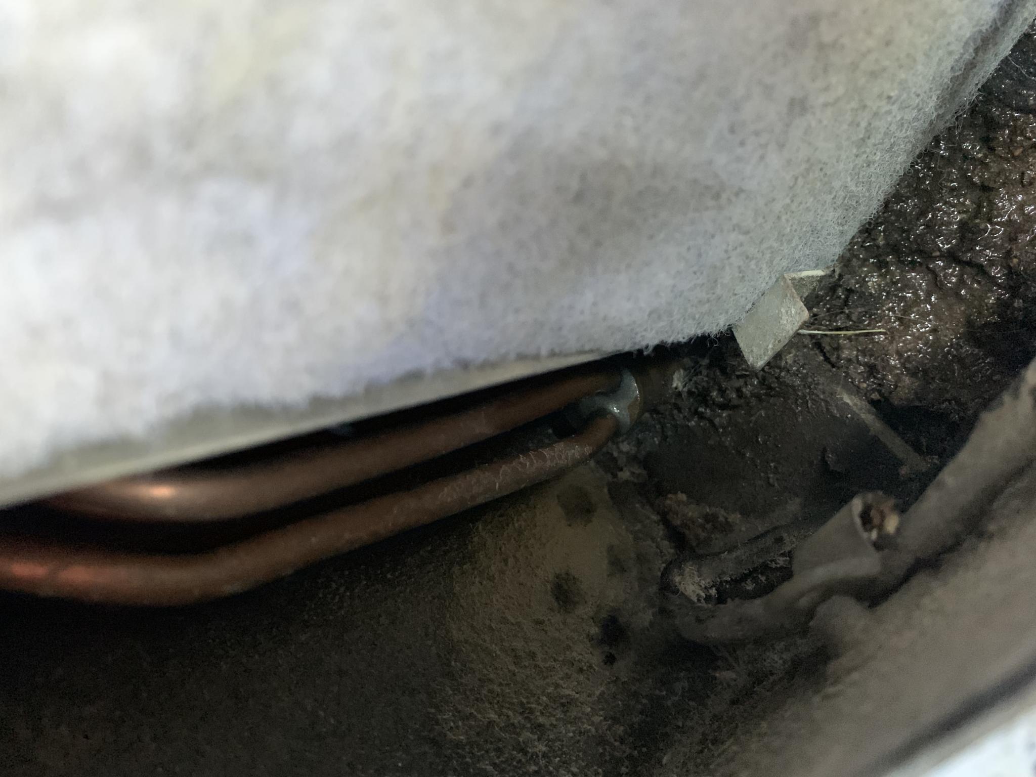

What could be causing this? I know that the A/C lines under the truck sweat like crazy and also the fan has been kicking on a lot more frequently.

Check for a drain being clogged. That area is going to condensate because of the ambient air being pulled across the evap coil.
- There will be a drain at the bottom (usually at the lowest point in a corner). Those drains will often get clogged from dirt and debris (much like whats in there now). When you bounce around down the highway the dirt falls down, collects at the bottom, and causes the drain to clog.
- If the A/C lines are sweating, that's fine....you should still see a consistent drip out of a particular area under the truck. Thats where you'll find the drain.

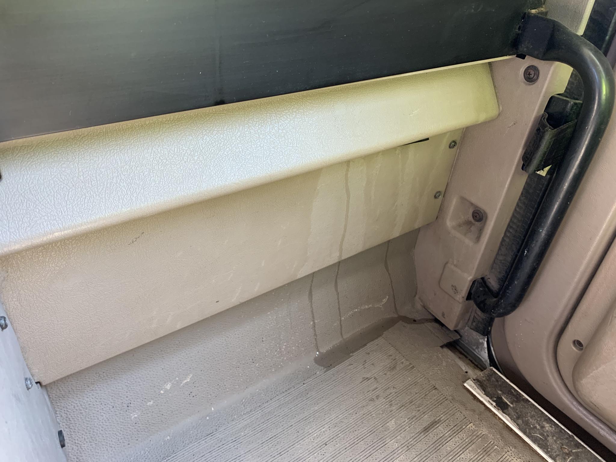

How about this?

If the drain is clogged, the condensation will begin to find the next path of least resistance. Usually that’s on the floor. If your HVAC is above that area, I’m betting on the drain being clogged.
Without proper condensation drainage, the evap coil can freeze up as well. Have you been having any issues with cooling or air flow lately?

I'm assuming that is the front passenger side floorboard and dash area? Do I see a tinge of coolant in that water? If there is, more than likely the heater core, if not, I'm with SqOne, clogged drain.

I found the drain hose and when I pinched the sides so that the ends could open a piece of sludge came out so I ran a skinny stick up it followed by compressed air.Hopefully that fixes it.Also ordered a new cabin air filter and looking into getting one of those exterior pre filters.
