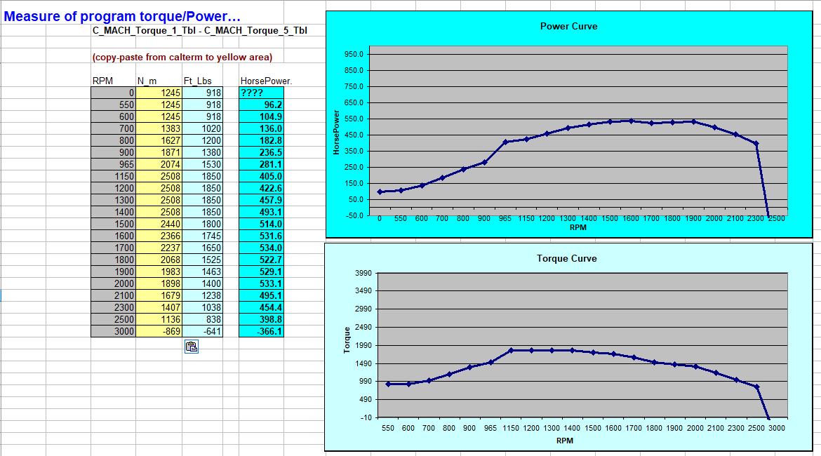

As far as the engine goes. According to that ser#, your supposed to have program HD10389 in it. That program is advertised at 565HP/1850 torque. Here is the actual torque curve of that program however...
./uploads/202105/post_2_1621021250_54a3c066ec5079be67ac99049836063c.png
(right click and choose "view Image" for a larger picture).
As can bee seen in the screen shot, at 1650RPM, it is programmed to produce 532 Horsepower to the flywheel.
90% throttle would be roughly 477-478 Horsepower output to the flywheel.
- Lag in the gearing accounts for up to about 12% - 15% of the engine output, so this puts it at roughly 405 - 420~ish HP out of the gearbox and into the hydraulic system.
- Now you must account for lost heat (friction) in the drive-line/gearbox, etc. and in the hydraulic system.. and your likely not too far off from what you estimate.

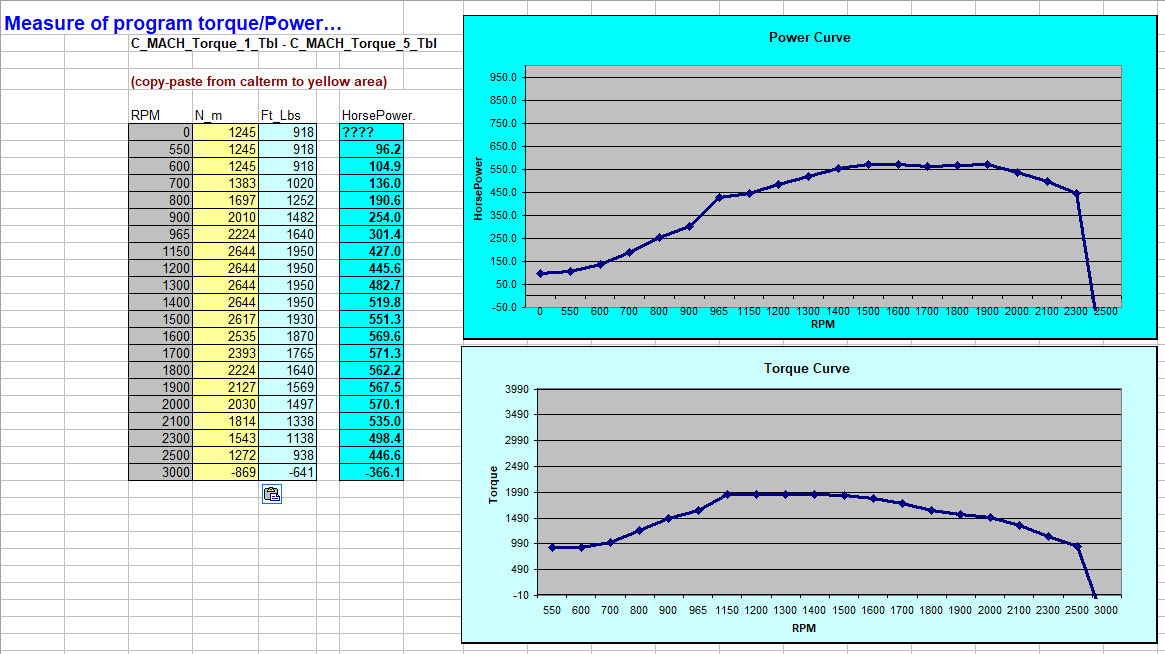

- Factory Program HD10400 is 100% compatible with that engine. It is advertised at 605-HP / 2050 Ft.lbs.
- Just have the engine flashed with this factory program. here is the profile of program HD10400 ...
./uploads/202105/post_2_1621023386_a93a35a6bcb55ea775f8dc0b96cbf9cd.png
At 1650 RPM, it reaches 570HP output, and this is considerably higher than the HD100398 program at the same RPM.
