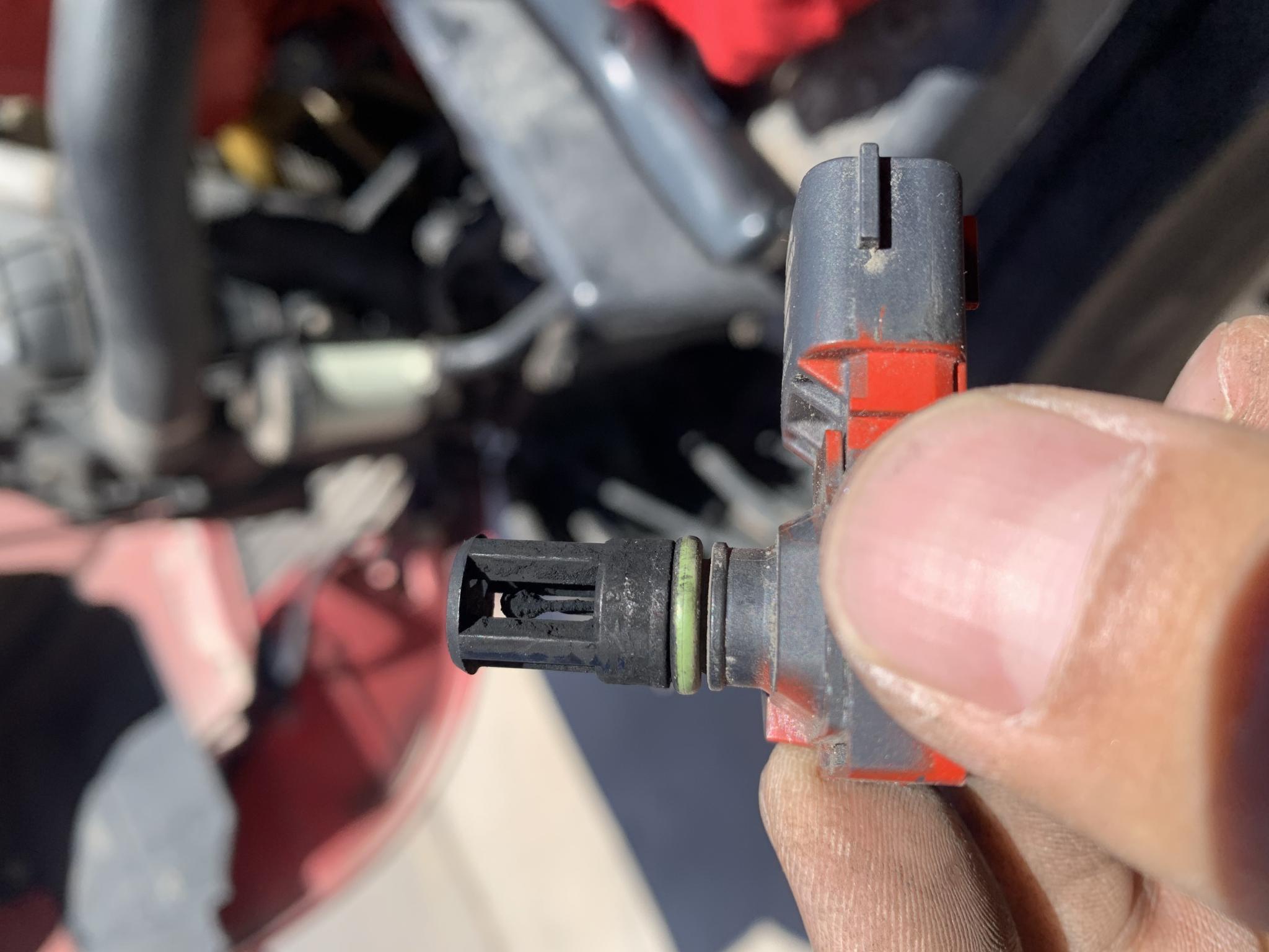

Just swapped out my imap, something I didn’t even know existed until I got on this website. I’m really grateful for all the guidance. Really excited to start copying your work and hope to get the results I want. And if all else fails I’m going to mr haggs in griffin GA. I used to live in GA when I was a kid I’m from Dallas GA.
Next up is the fuel pump because looking at the imap i know it hasn’t been fixed. I will have time to get it done on the weekend.

(05-24-2021 )John Doe Wrote:  Just swapped out my imap, something I didn’t even know existed until I got on this website. I’m really grateful for all the guidance. Really excited to start copying your work and hope to get the results I want. And if all else fails I’m going to mr haggs in griffin GA. I used to live in GA when I was a kid I’m from Dallas GA.
that thing painted red like that tell me that it likely has never been changed.
