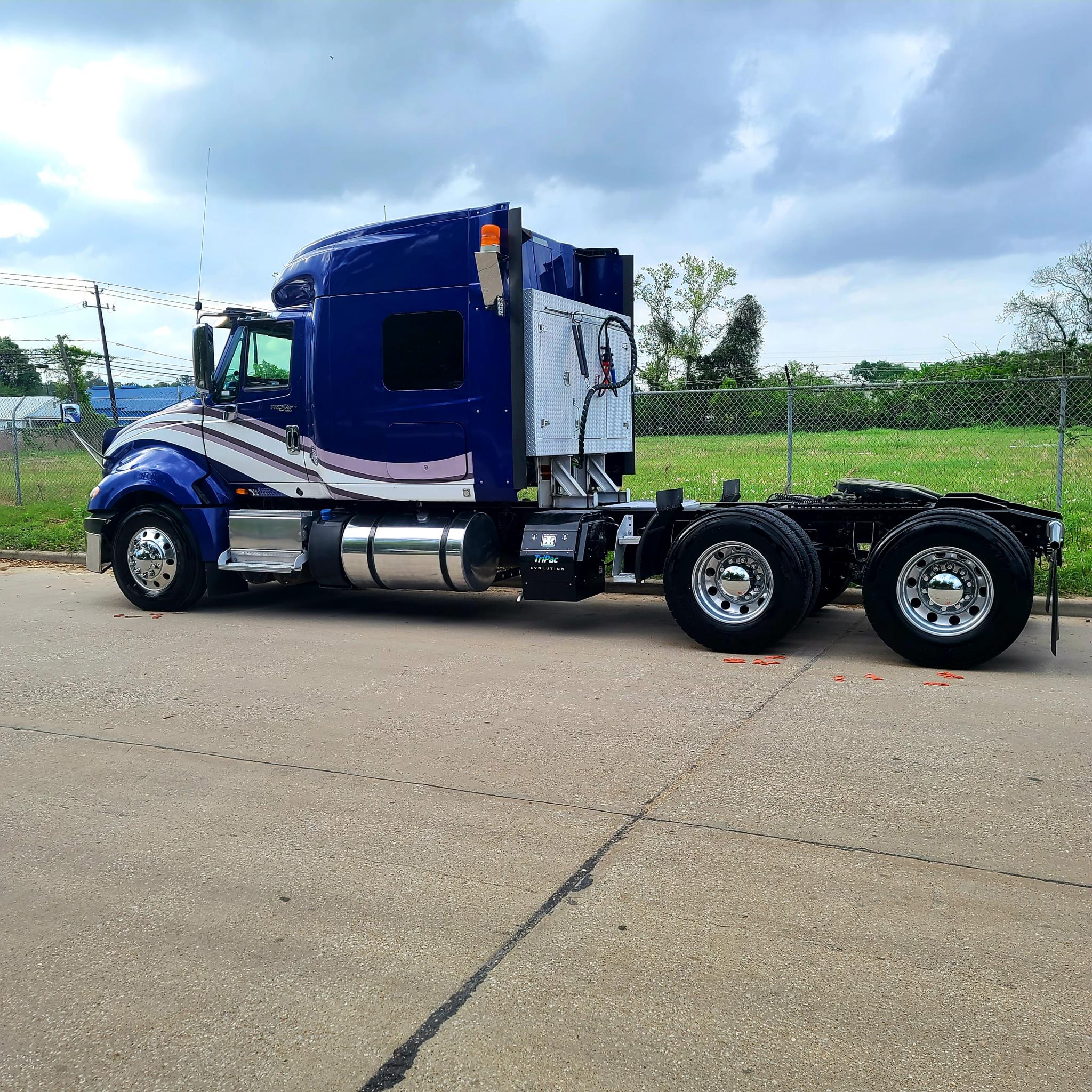

I'm heavy on my steers!!!! With empty trailer and tanks at 3/4 I was at 12,380lbs. My axle rating is 12,350. Now I know I get an allowance of 400 hundred or so depending on the state for my apu, but is there anything else I can do to help move the weight back? Should I Slide tanks back a little in the straps? they are not under the doors like some prostars they're under the sleeper pretty much. Replace the axle for a higher rated one (this is the option i see being best for peace of mind at weigh stations)‽ My truck is 274 wheelbase. I have my 5th wheel back a few notches before the rear or one or two notches from being centered between the drives, but being a longer truck it makes it tougher to maneuver through places like DC, NY etc when I do go so i want to try to avoid going back any further IF possible. Any suggestions or help is appreciated. Also, I pull flatbed so yes I have a headache rack and chains/binders in there. Going home next week and if there is something I can do or have done I'd like to try to do it while I'm home for a week. Thanks for your help. Picture of truck is attached.....if I did it right lol.

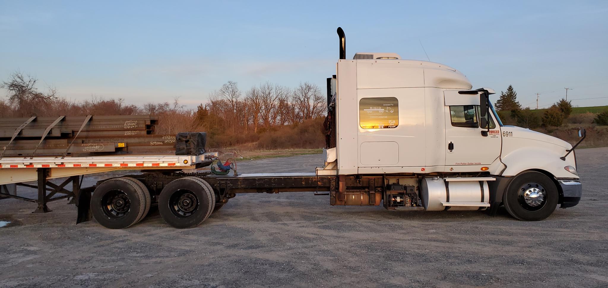

my prostar is the same way. I got all my chains hung on a chain rack on opposite side of apu and reduced as much weight in the cab as I could. - I have that heavy Hendrickson front end, and mine is 12,300 bobtail with full tanks.
BTW: In that photo ... your fifth wheel looks like it right where it is supposed to be so that it does not add weight to the front end.
I know that I cannot load more than about 45,300 or so with most box trailers or I will be over 80k with mine. Some shippers complain about that, but i tell them to go screw themselves if they do.
Your def tank, and the batteries are in front of fuel tanks... where mine are behind them at back of cab. My APU is further back, right in front of the axle mud-guard as well. Those things are is likely putting yours heavier than mine. you also have that headache rack adding some weight.

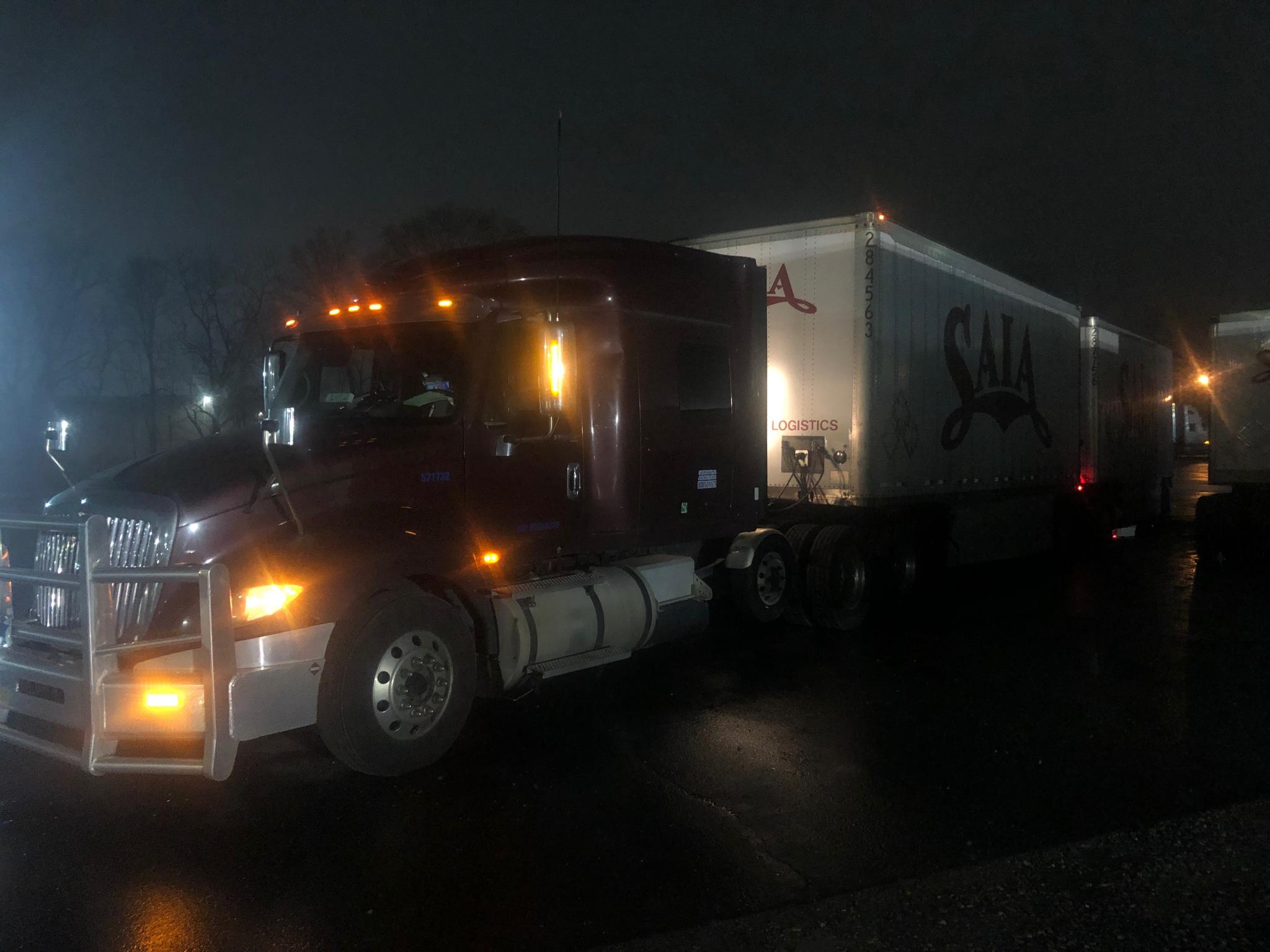

I'm up there too, roughly 13,000 or close all the time, big Herd Defender bumper and forward tanks on my ProStar. I run the 16 ply tires vs the 14 ply, 12,000 lb front axle. Never had an issue, been just about every state accept CA...
Not the best photo, but at least you can see what I live with. And that is a steerable lift axle on there too... She is HEAVY ;-)
