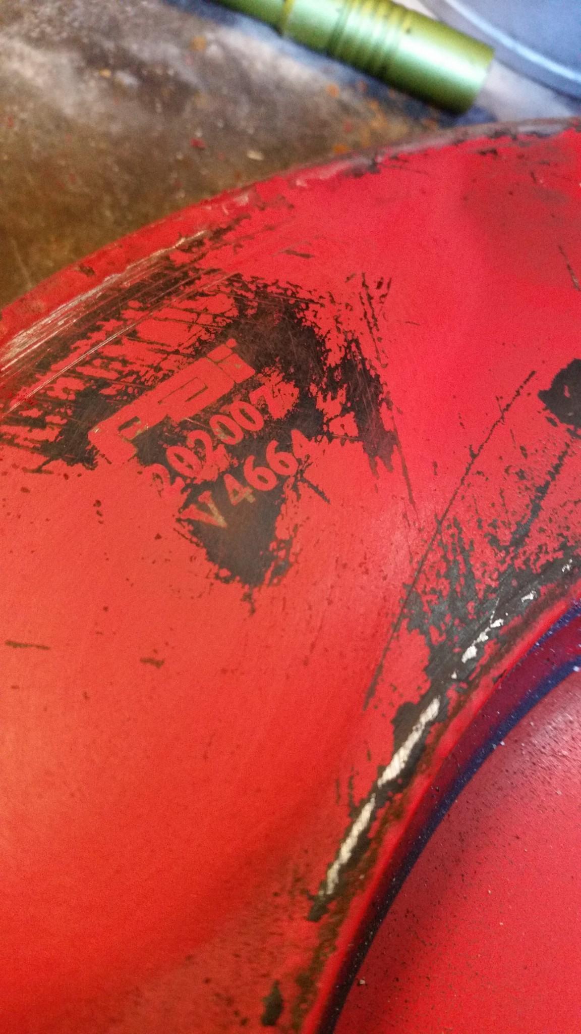

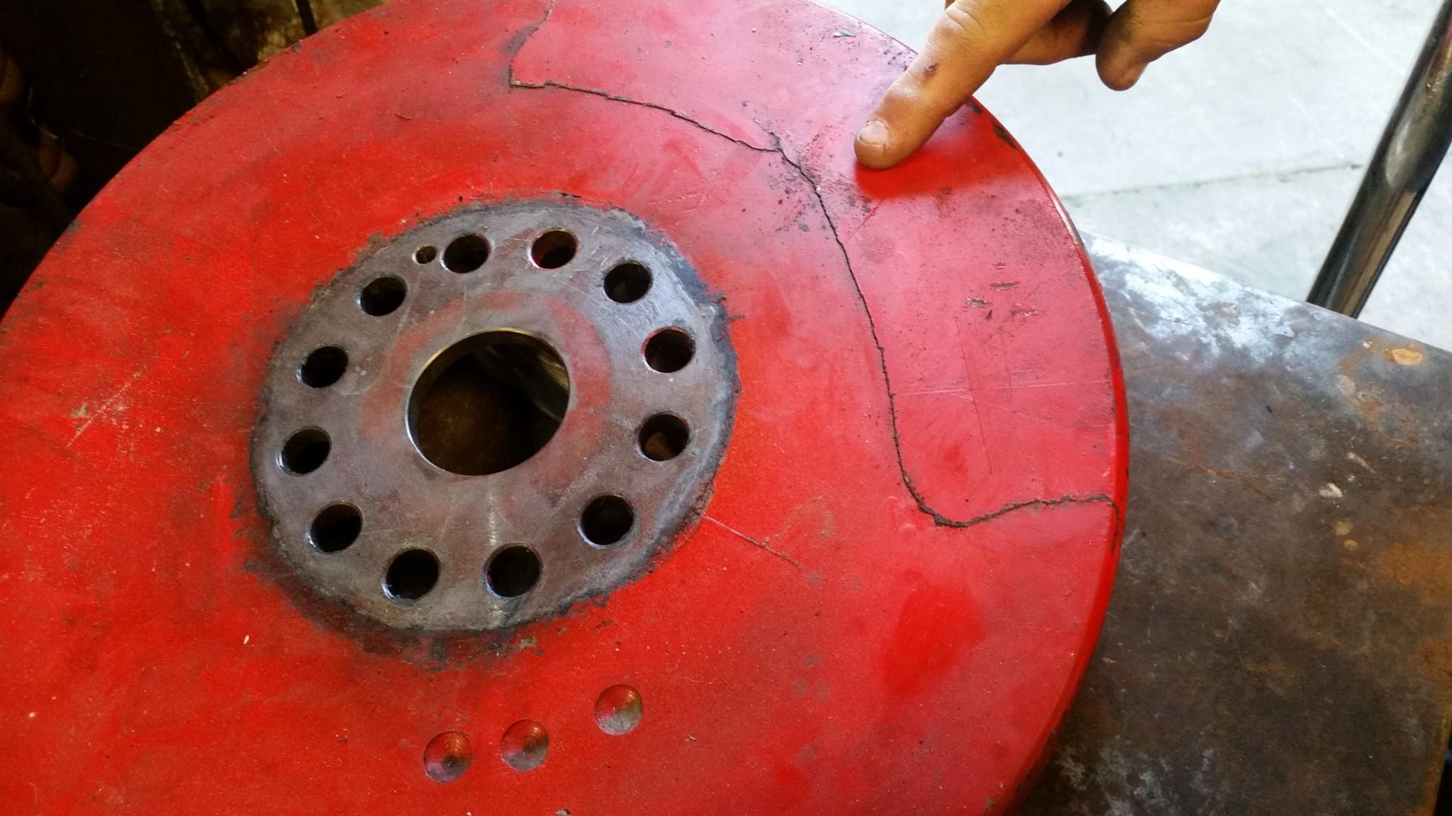

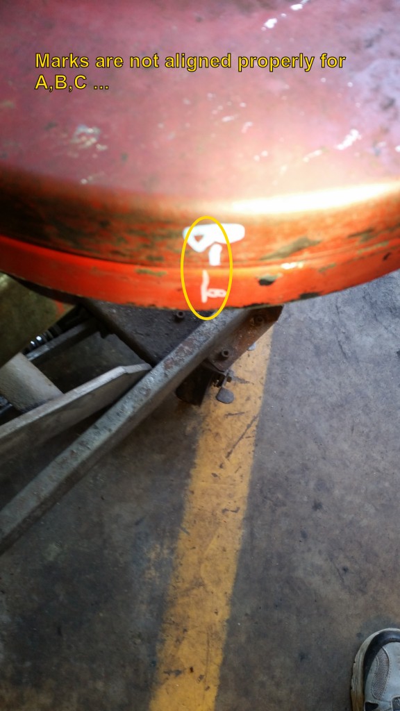

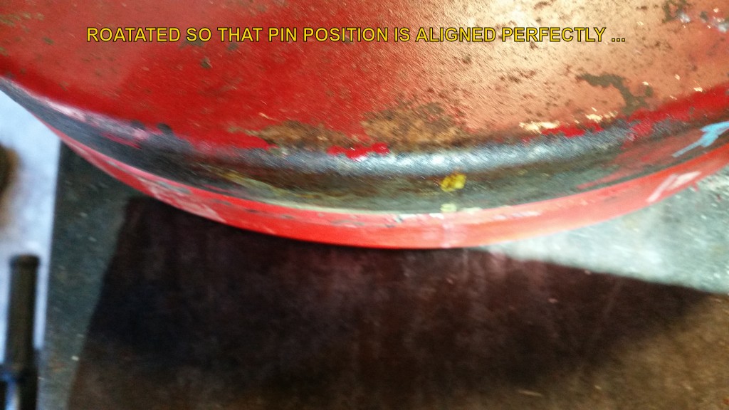

RE: Ting / Metallic Sound (06-03-2021 )kozakvod Wrote: BTW, I found the SAME tensioner through PAI for $144 ... not sure about the tensioner but {brands like those} around here has been known to be nothing but pure engine garbage components... just be fore-warned. Don't trust those so-called "good reviews"... your drinking the cool-aide on that one. here is a recent failure seen on one of their garbage dampers. This one was less than 2 years old... The markings for A.B.C did not align quite correctly either on it. When I stacked it on top of an official cummins damper and aligned the pin position marks,... all three A,B,C were off by a few degrees. ![]() ![]() .. and Yes, I was looking at the stamped markings, not just what someone had painted on it. --- and don't even get me started on their garbage overhaul kits. User's Signature: ->: What I post is just my own thoughts and Opinions! --- I AM Full Of S__T!. | |||

RE: Ting / Metallic Sound (06-03-2021 )Rawze Wrote:(06-03-2021 )kozakvod Wrote: BTW, I found the SAME tensioner through PAI for $144 ... Good to know Rawze, thank you! I do agree that I wouldn't put on an off brand dampner or other critical engine component. I have never used a non-cummins OEM part, but I figured for the 50% savings I'd give this a shot and see how it does, we shall see. | |||
