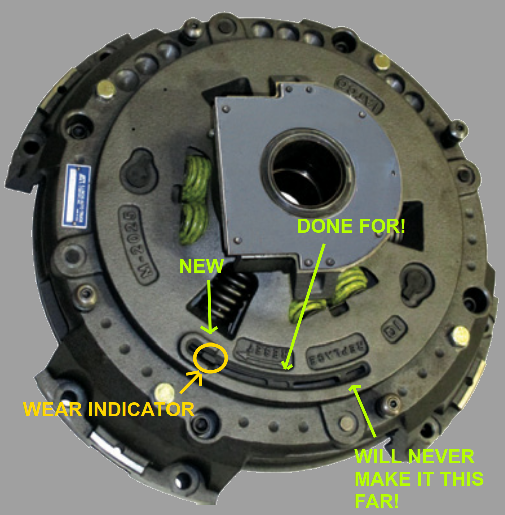

If you have a self-adjusting clutch... then pull the inspection plate off it and check the wear indicator (long curved groove similar to smiley-face with a tab sticking out). You might have to bump the starter to rotate the clutch, get the wear indicator to the bottom to see it.
If the tab sticking out is all the way to the left... that is a brand new clutch. If it is all the way to the right.. then there is no more material in the clutch.
HOWEVER....
- You'de be really hard pressed to get that wear indicator past about the half-way mark on those model clutches before it fails completely. Those type clutches are known for failing when the wear indicator gets to about the half-way mark or so... seen it many times.
So ... if you look at it and its about the half-way mark... REPLACE THE CLUTCH and everything else that the tranny needs to come out for while your at it.
./uploads/202106/post_2_1622908681_35550073c53b4b7328be7bde3ae4e97f.png
The symptoms you are describing are exactly what they do once the wear indicator gets much past the half-way mark. The tip of a spring breaks off and rolls around in the clutch, making it randomly hard to get into gear .. It acts like like the clutch-brake is not working sometimes.
It may or may not be your issue .. but if that wear indicator is half way or more... its time to replace it any ways, so nothing is lost.

This exact issue happened to me about a month ago, had self adjusting clutch, waited too long to replace, it died before i replaced it, was almost impossible to get into gear from stop, had to float the other gears. Get it done asap.

The last couple auto adjust clutch I had would do this randomly. The guys are correct if the tab is half way or more. The auto adjust just doesn't work well after half way. I was able to drive mine for quite a while everytime it would do what you describe. I would start the truck in gear with the clutch pedal pushed in if it would get too bad and then work the clutch violently to get it to act right. So you'll probably be able to get your 2 week time frame out of it. Just be prepared for it to act up.
Now if the clutch pedal sticks to the floor on one then your time frame is way less. You would be operating it on borrowed time if this occurs. It's still drivable if your good at floating gears and in terrain that allows you to stop the truck using just the foot brake while its in neutral but the next destination once this symptom starts is directly to the shop to have a clutch put in it.
