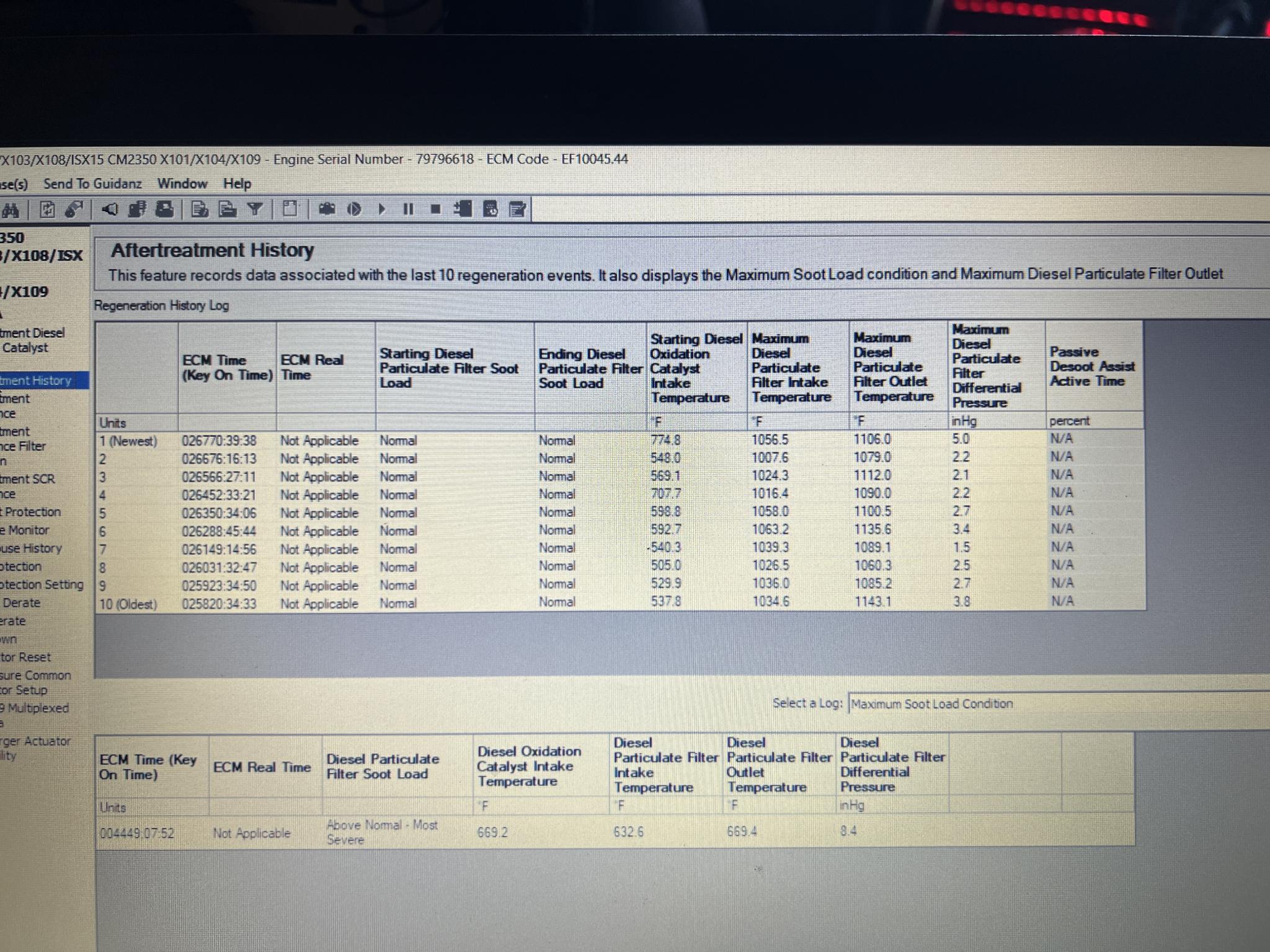

* What does the regen history in Insite show>?. how often is it doing a rilling regen cycle and what are the resulting numbers on the far right?. -= Maybe post a pic of the regen history. + compare it to the engine hours to see if it is properly active.

Here is the regen history.
