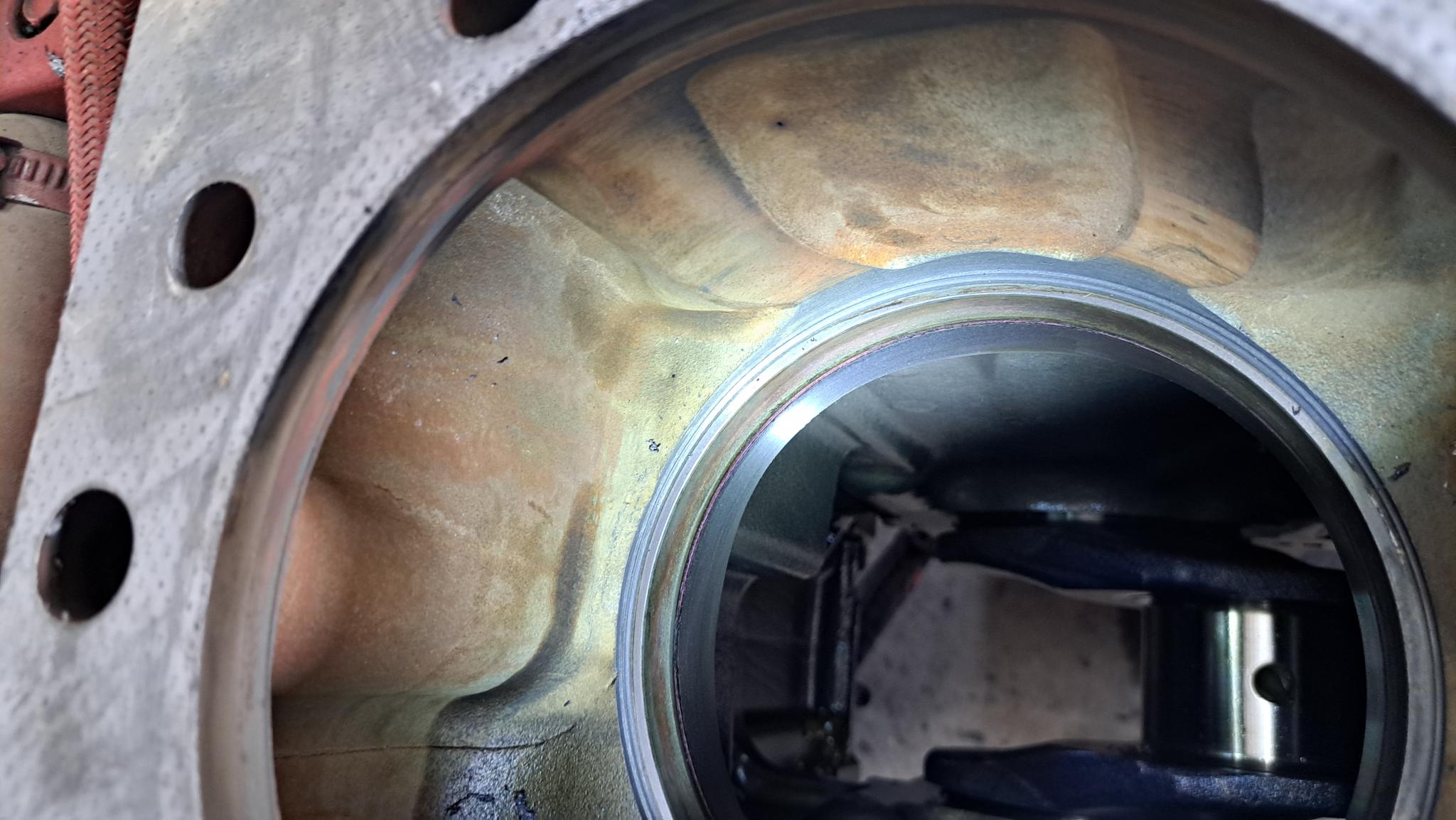

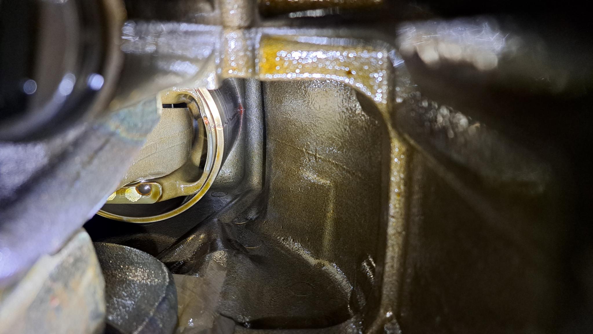

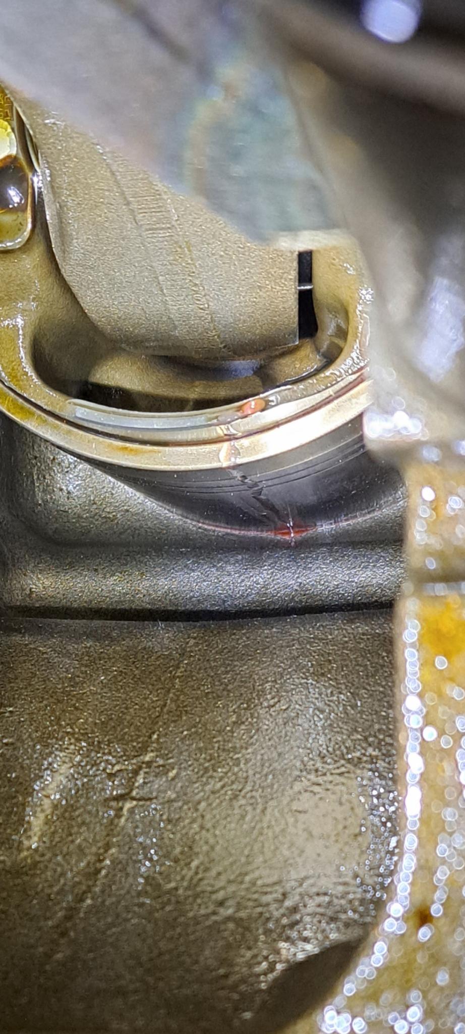

I have a 2017 CM2350 720k mi. that I just purchased and within 2 mo. started losing lots of coolant, turned out to be a failed O-ring on #2 cylinder liner on the exhaust side, Even though all the internals showed very little wear I am doing a full overhaul with all the extra steps this forum teaches. What keeps rolling through my mind is why did the o-ring fail? The abuse history shows the highest coolant temp was 230 for less than 2 minutes so doesn't seem that caused it. If I go all out on a rebuild how can I prevent an early failure putting me back in the same position? It does appear like it had waterless coolant at some point before I had it as the inside of the block looks rusted but is actually a brown film with the texture of dry grease that can be wiped off. Also I had a transmission heat exchanger fail mixing lots of gear oil in the cooling system and I've seen engine oil and coolant mix deteriorate rubber hoses, seals etc but didn't know if gear oil does the same? Also the o-ring looks like it was falling apart long before the trans cooler failure. I will attach pics

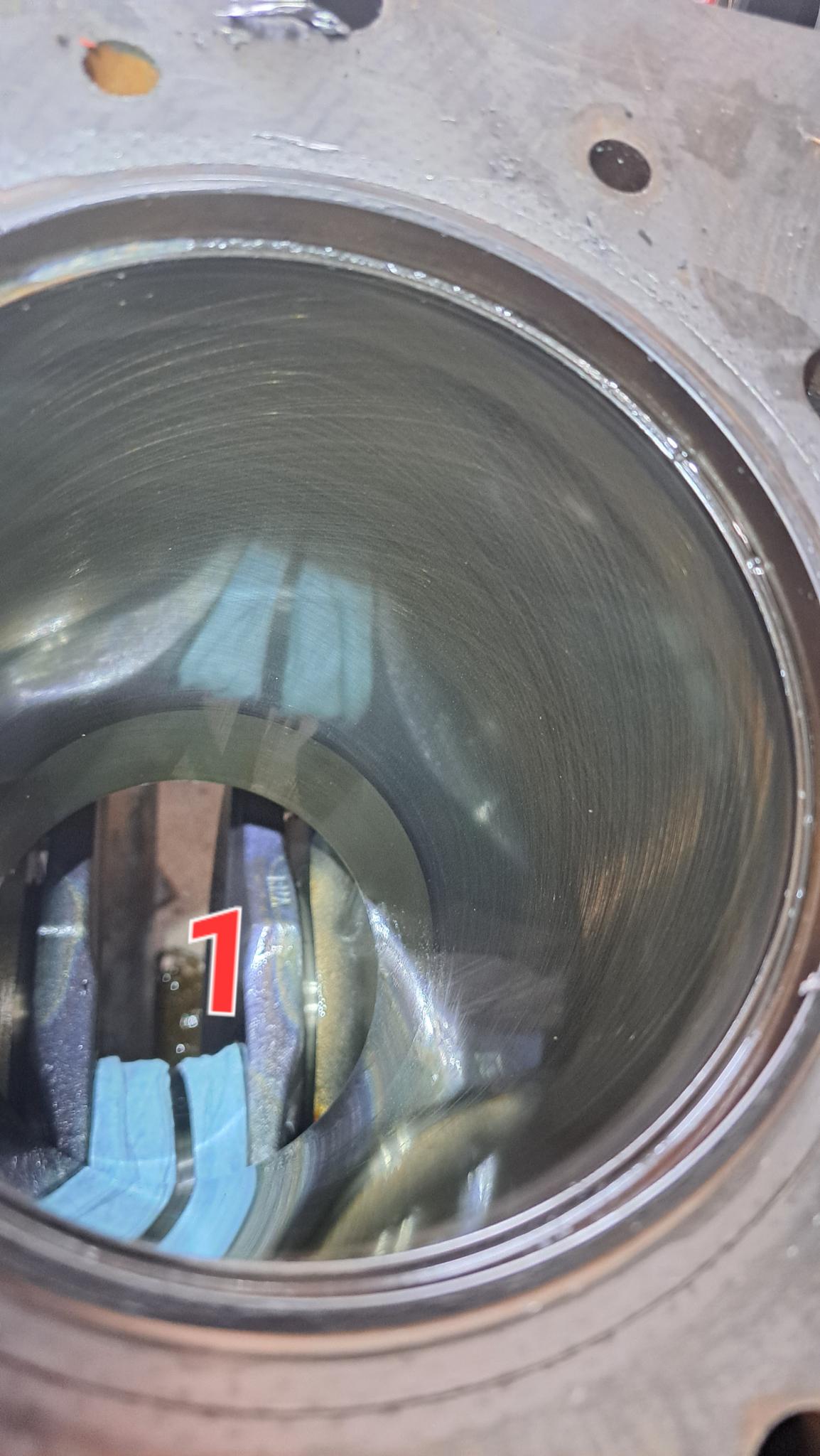

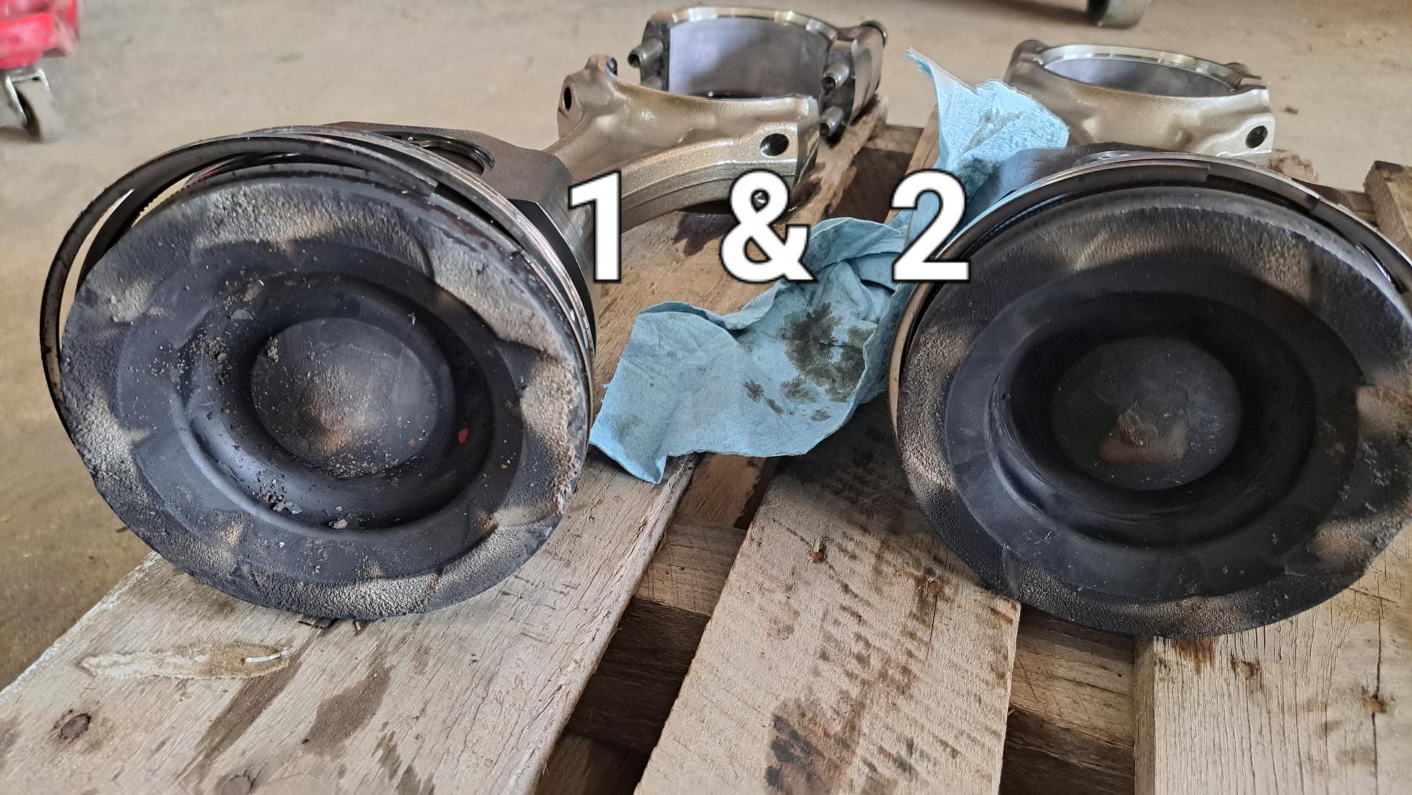

Interesting for sure. WHen I look at the brass shim here I see either signs of combustion gas or sludge from mixing coolants or something. What does top of pistons look like? What does inside liners look like? You see any heat marks on inside liner? The first few things I look at is friction how was piston and liner looking? Was there heat internal that maybe ECM didnt see? Which would lead to looking at tuning first see what kind of power we trying to make. Look at tops of pistons to see if you see the spray pattern? Was it flashing the liner on top of piston? I wish I could point you into the know but what we have thus far we can only speculate whats going on.. Please post more pictures, top of piston, inside liner, maybe more than one cylinder. Also what do the rest of the liner orings look like?

I had no signs of a dropped liner, no head gasket failure or pressure in the cooling system, when I dropped the pan I didn't even need to pressurize the cooling system to find the leak it was a steady streak running down the outside of the liner, see pic.

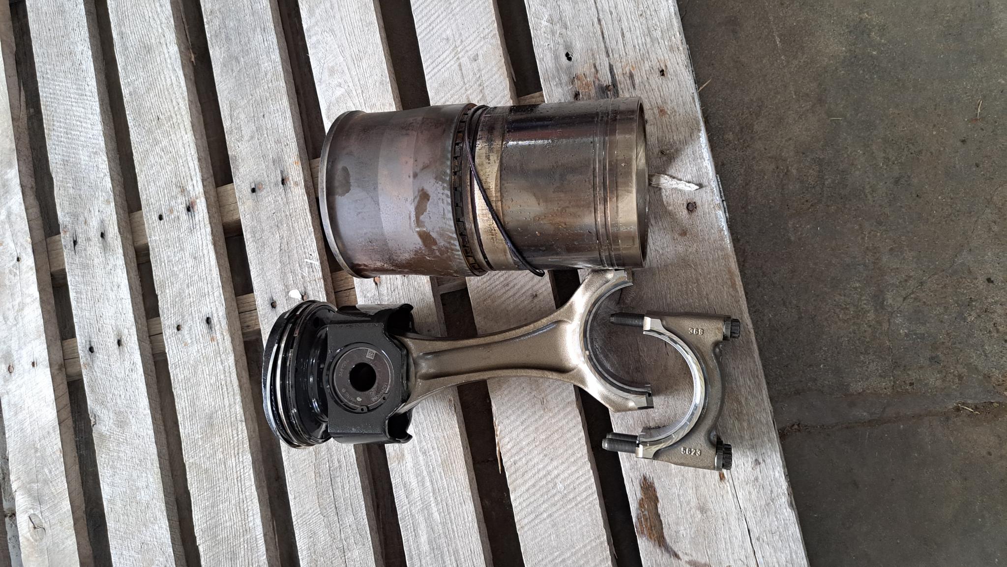

First and foremost, that o-ring will not normally leak unless the liner started dancing in the block. The brass shims will always hold back the coolant unless someone installed the liner with debris on its brass shim, or the liner was dancing in the block. The o-ring is simply a back-up to this.
I.E.> The liner o-ring is a 'back-up' o-ring, and not the primary means that keeps the coolant held back in that area of the engine.
The pictures show that o-ring is deteriorated heavily due to rot alone (oil or some other contaminant in coolant at one point) so badly, that if it were the only thing holding coolant back, it would have failed a long ago. The fact it started letting coolant past it at this point, is the liner moving around .. not the o-ring itself.
The mid-stop in the photo shows that it is also heavily fretted on the thrust side, pointing to this as well.
So all things in the photos so far heavily points towards a liner starting to dance.
Any signs of a head gasket failure too?
How about micro-etching in the bottom side of the head where that liner sat? head is likely fretted too. - This would give it away, even if there were no other visible signs.

I looked at things closer and Rawze seems to be correct about the dropped liner, but there were no signs of a blown head gasket. I looked closer at the thrust side on the Block and there is definitely fretting there, I'm glad to know that the O-ring is only a backup seal therefore if I counterbore it correctly I won't have to tear it down again for a deteriorated o-ring. I looked at the head and didn't see any steps worn in the head, but when I peeled the gasket off there was a space on each cylinder where the gasket wasn't stuck fast as if it was working at blowing through the seal?? Also while looking at the head closer I noticed every cylinder has cracks in the head between the valves, some have cracks between every valve on the cylinder, a new (not reman) OEM head will be here this week.

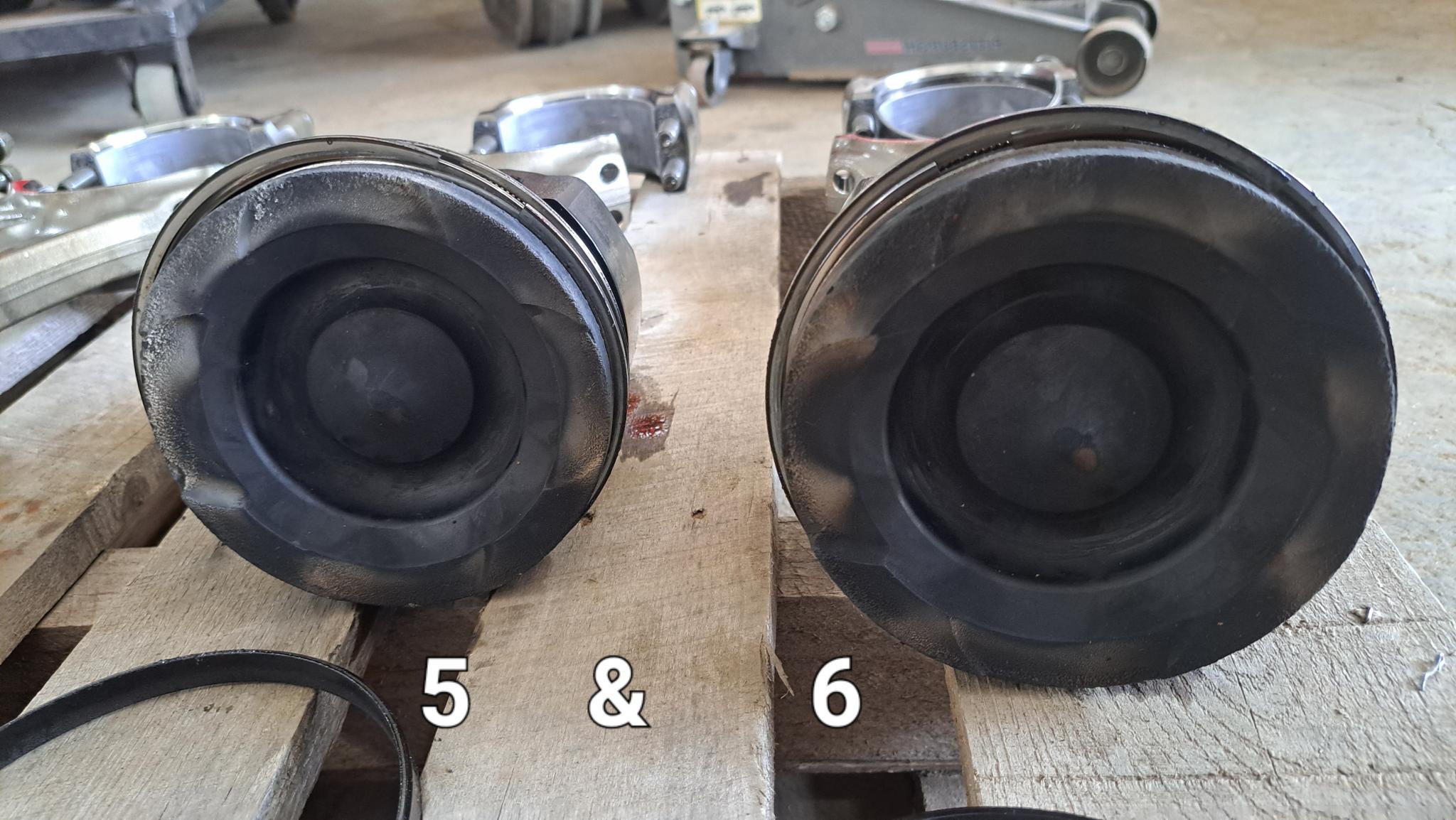

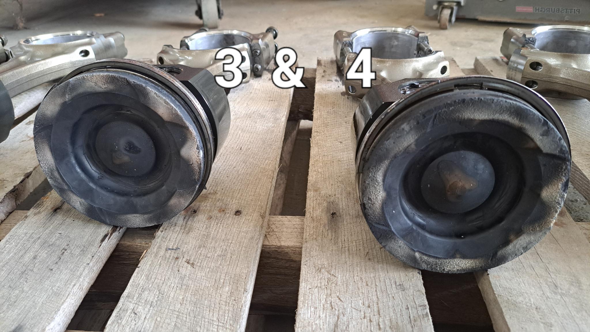

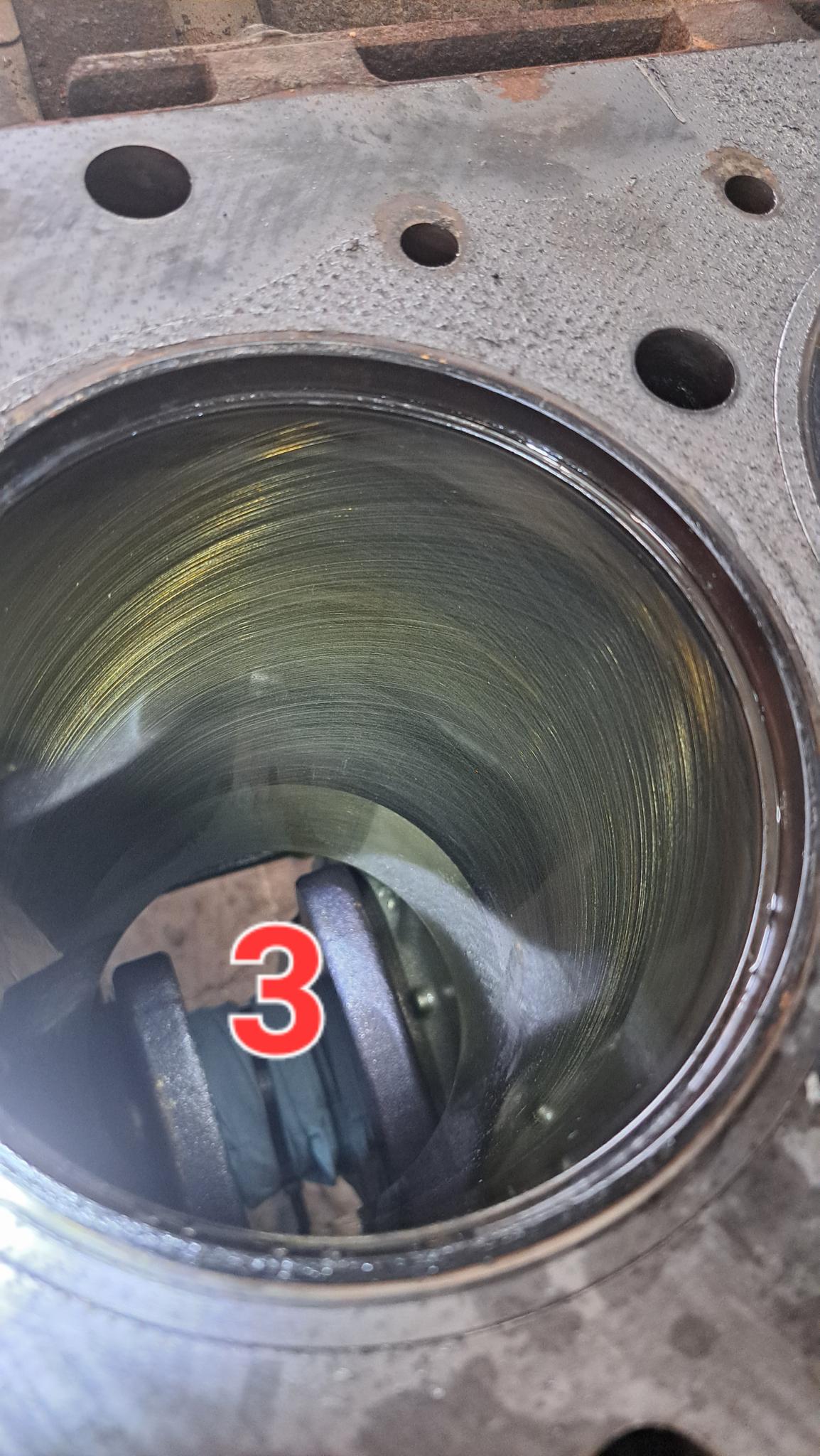

Here are pics of the piston tops

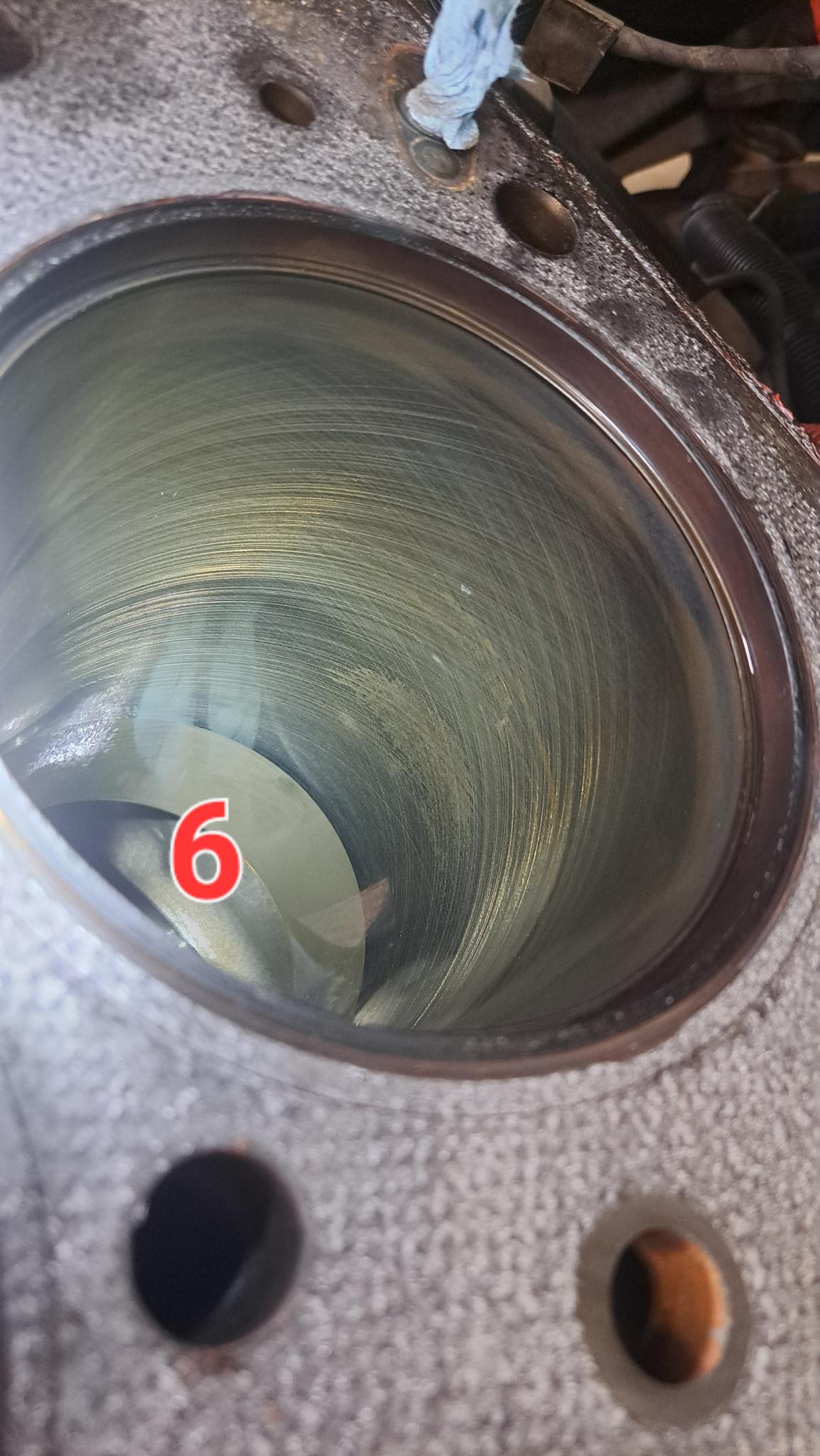

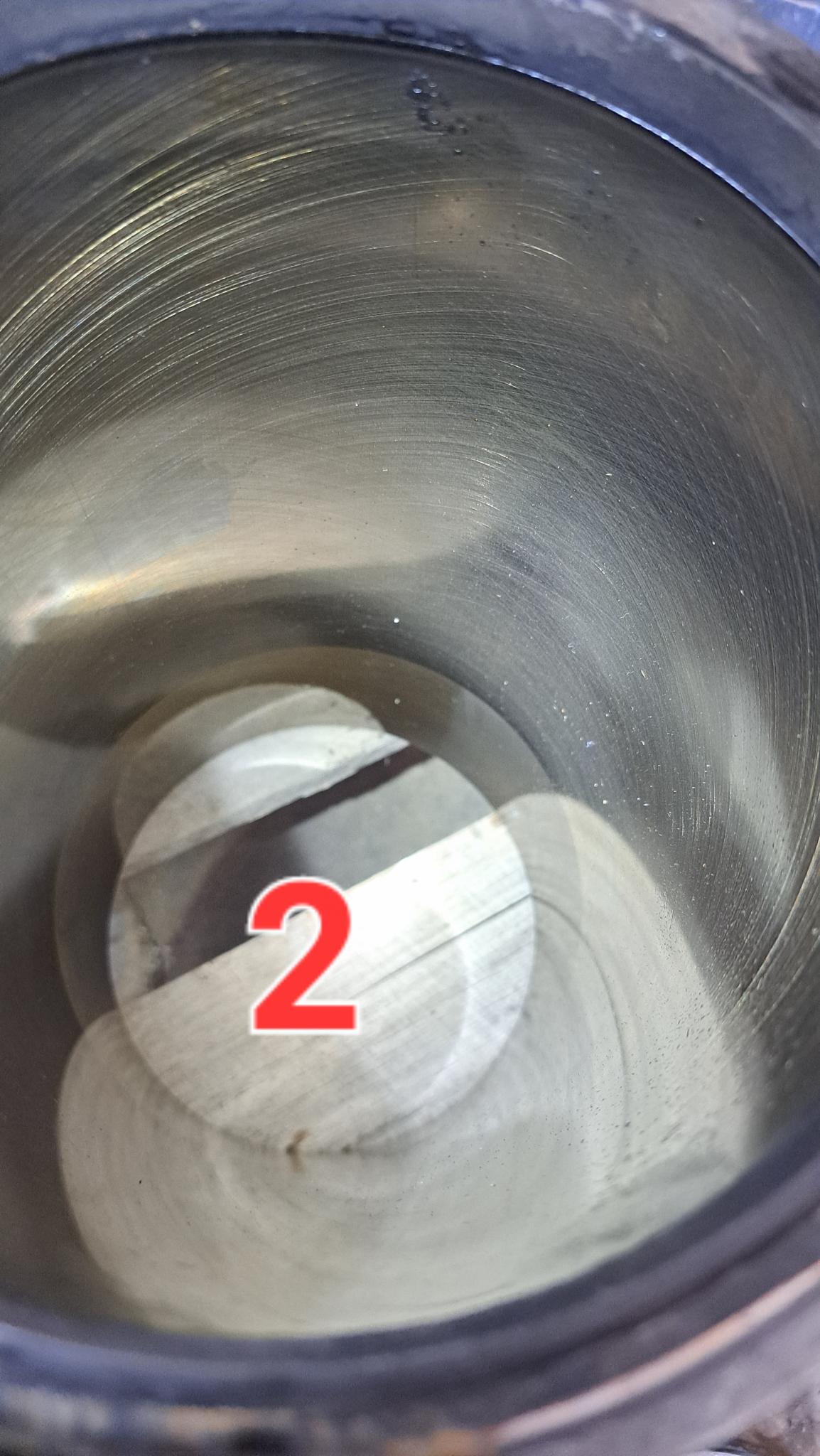

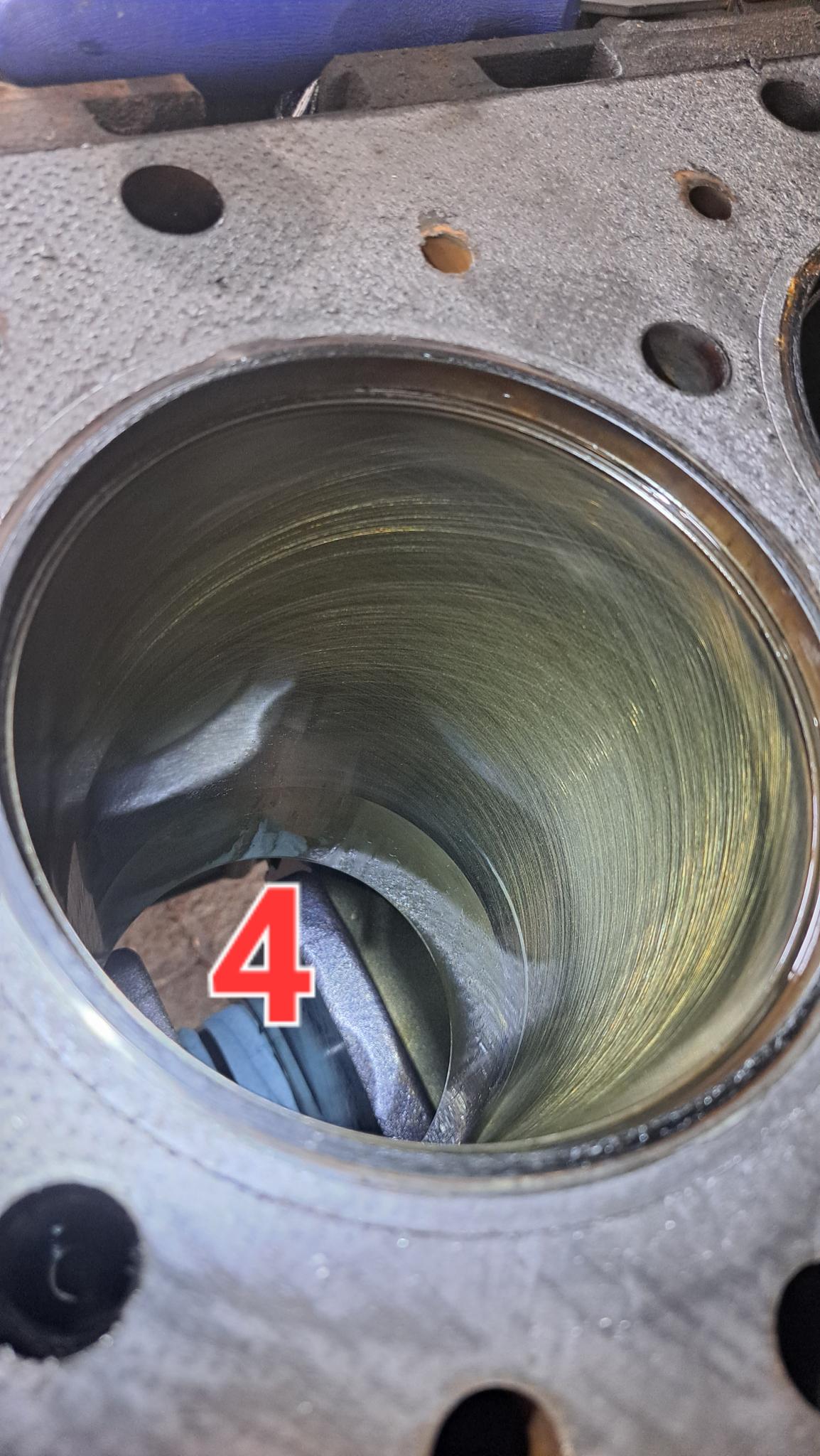

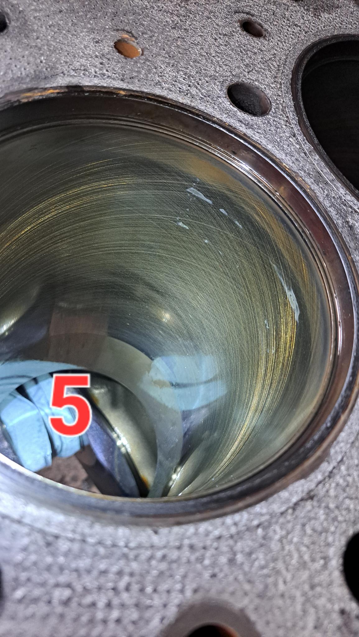

Here are the sleeves
06-19-2023, (Subject: Liner O-ring failure )
RE: Liner O-ring failure
And number 6
