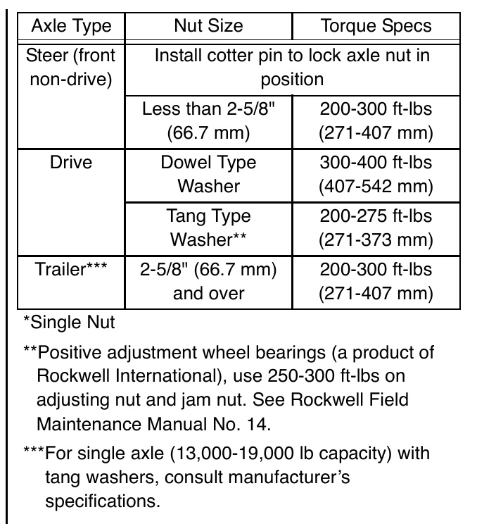

Final torque recommendation depends on what nut you had. here is a chart from the Comnet service manual for max torque on the different nuts types. It shows the tang type washers having a lower torque range...

 Thanks given by: JimT

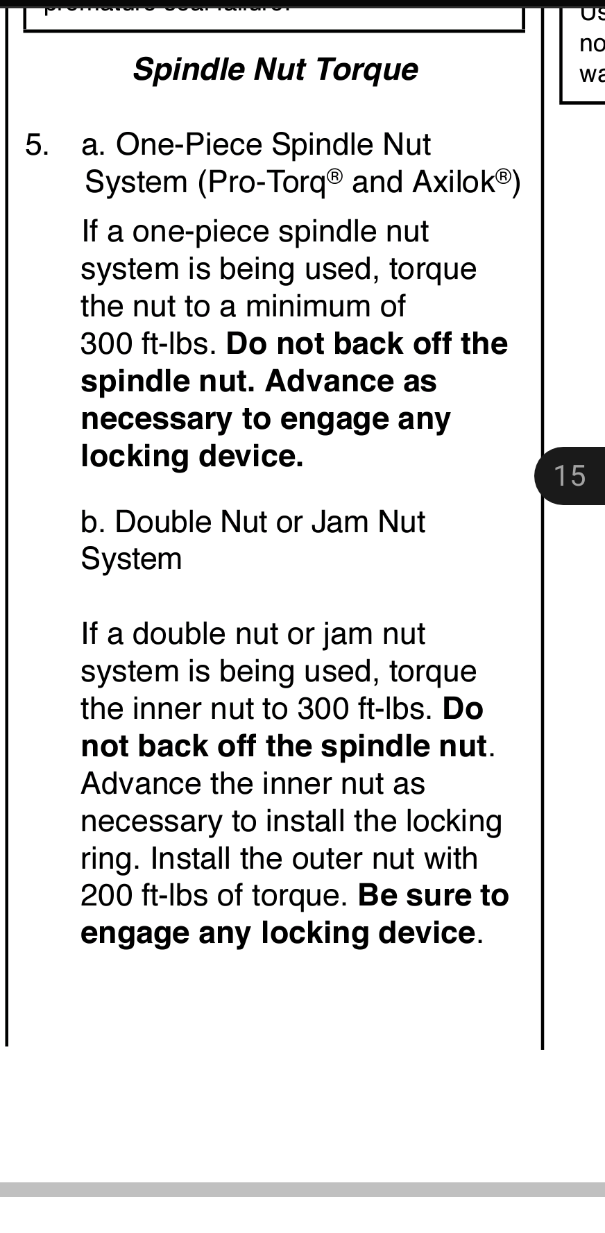

Just thought I'd add this for future reference for anybody else while the pro torque and the axilok are tang style conmet does have them specifically outline in the service manual as 300 ft lb. I did remove axilok nuts and replace them with pro spindle nuts mostly due to availability.

Yauchout that was a good move. IMHO Axiloks are dangerous. Over the years I have seen quite a few where the locking part breaks. They start to back off. About 20 years ago Holland was having "wheeloffs" on new Sterlings with Axiloks.
