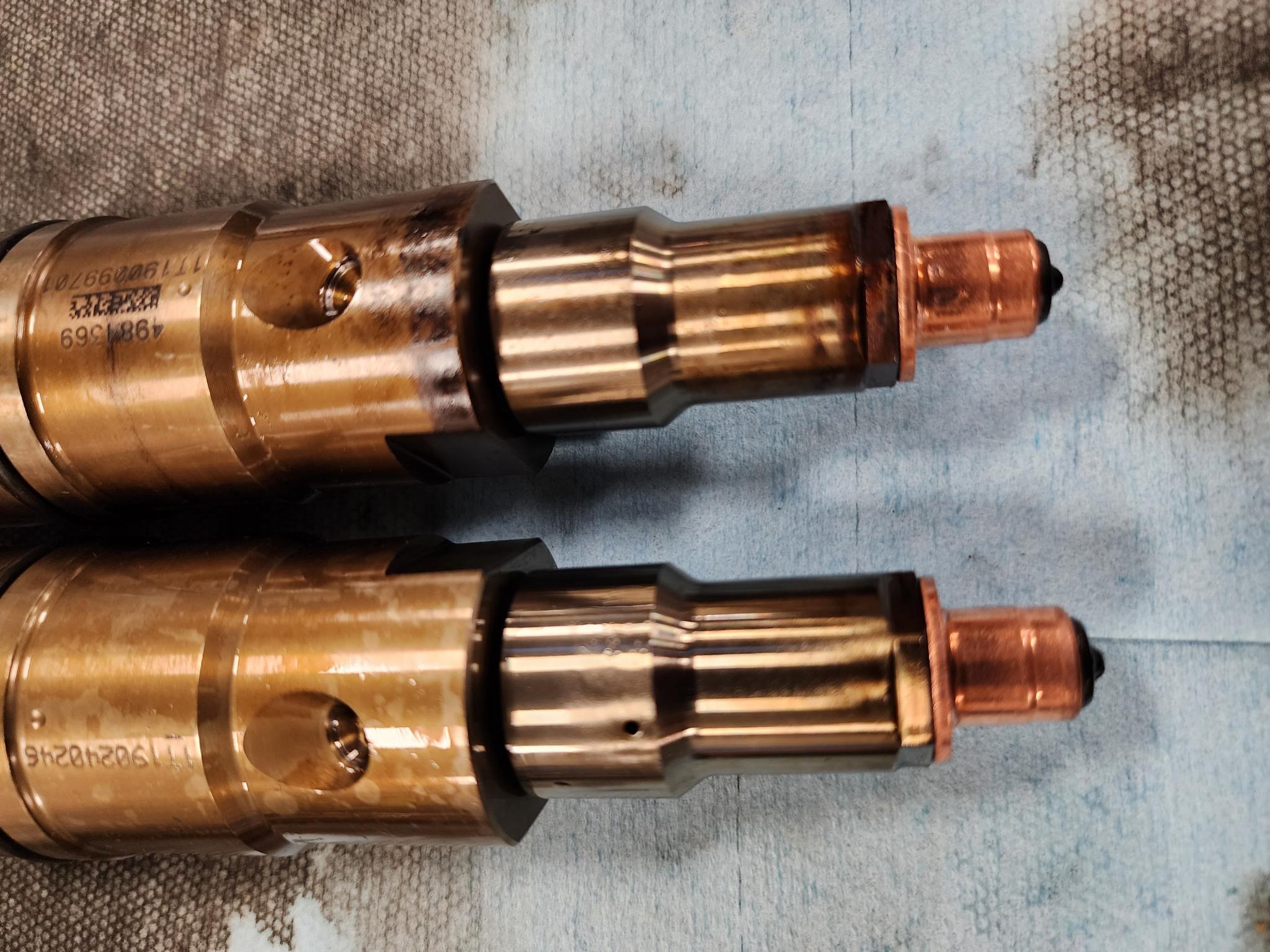

| RE: X15 connecting rods replacement?  Injectors 5 and 6, curious what caused 6 to be darker colored, currently in framing due to head gasket failure at #1. X15 530k miles  | |||
|  10-11-2023, (Subject: X15 connecting rods replacement? )  Post: #5 | |||
| RE: X15 connecting rods replacement?  That injector ran hotter than the rest, most likely for the same reasons that its being inframed in half the expected time it is supposed to be. = Big power + low rpm, high torque abuse from bad driving habits, ... and/or bad delete programming... Take your pick of such ... An abuse of the engine that defeated its expected longevity, in one way or the other. ==================== Lets put it this way ... Do you think that if I owned it, that it would have only lasted 530k miles before a liner danced in the block like that?. I Don't know about anyone else, but I actually want to make a long term profit off of my equipment,.. and not drop $25,000+ into it 2x more often than it should be... I don't care how much slower it has to go up the hills!. hence, the first da$mn thing that I would have done after purchase would have been to RE-GEAR THE REAR ENDS CORRECTLY vs. the freight/weights I was hauling .. AND TURNED THE DAMN TORQUE DOWN TO ABOUT 1760 OR SO MAX!. And any PTO operations would have been re-geared so that the engine ran 1500-1600RPM to operate that too!. User's Signature: ->: What I post is just my own thoughts and Opinions! --- I AM Full Of S__T!. | |||
|  10-13-2023, (Subject: X15 connecting rods replacement? )  Post: #6 | |||
| RE: X15 connecting rods replacement?  I think it’s very common on 2350’s and 2450’s to burn the 5th and 6th injector since they removed the 7th injector the 871’s and 2250’s had.. right?  User's Signature: Anti-seize EVERYTHING, Except injectors...Use Petroleum Jelly!!! | |||
