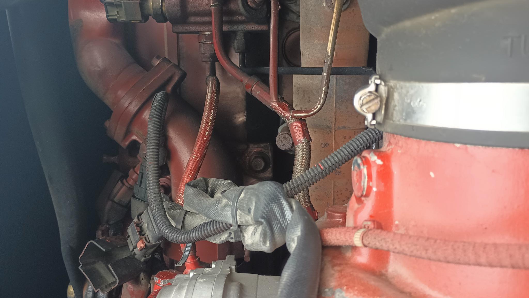

My mobile mechanic buddy was working on another person's unit, near my truck and pointed out a slight soot buildup in the turbo EGR area. He immediately diagnosed it as a leaking exhaust manifold gasket. Do you have a video or thread for opening this and replacing?
I'm told there is a main or "center" gasket, and four "endcap" gaskets also. Correct my terminology as needed. This is brand new to me.
Will post pics of that engine area shortly

I put a fingerprint in the soot

yup ... exhaust leak that needs to be fixed. Will make you sleepy .. less fuel mileage.. and dangerous to you and the motoring public.
Also.. why is you turbo connector not locked properly. For all anyone knows, the connector might not be seated all the way in.

Gaskets and the top six bolts are ready. The six with the studs on the heads are somehow scarce where I am and are a few days away. Yes, I have been yawning the last few weeks in the seat and didn't know why. Ignorance is not bliss. Glad I ask a lot of questions.
The soot layer is a week or less old. Before it appeared I noticed the gradual power loss first, of course. Then there was a different sound to the turbo as it was overworking. Finally the hissing, usually at stoplights or while warming up, not there one day and there the next. Which made me leap out and see the deposits there. I was a thousand miles from my headquarters and limped back. Now sitting and waiting for the delivery man. Got someone knowledgeable to look over my shoulder. Will update with pics this coming week.
