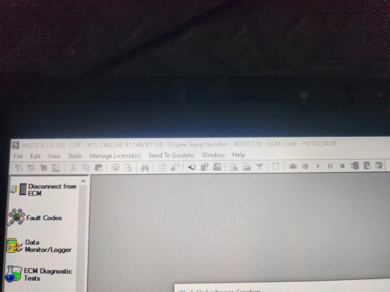

| RE: T880/Endurant kicks into neutral When connected with insite, what program does it say is in the ECM? it's at the very top of your screen. | |||
| 02-24-2025, (Subject: T880/Endurant kicks into neutral ) Post: #9 | |||
RE: T880/Endurant kicks into neutral (02-24-2025 )tree98 Wrote: When connected with insite, what program does it say is in the ECM? it's at the very top of your screen. | |||
