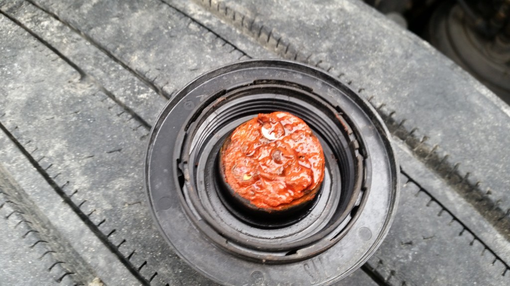

First I sealed my radiator cap completely so that it could not relieve pressure OR let air in...
[attachment=2592]
NEXT ...

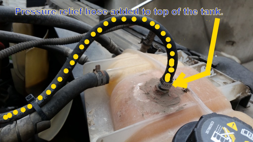

I put a relief fitting and 3/8" coolant hose from autozone into the top of my coolant reservoir at its highest point so that it only relieves air/steam pressure, and coolant does not go through.
[attachment=2589]

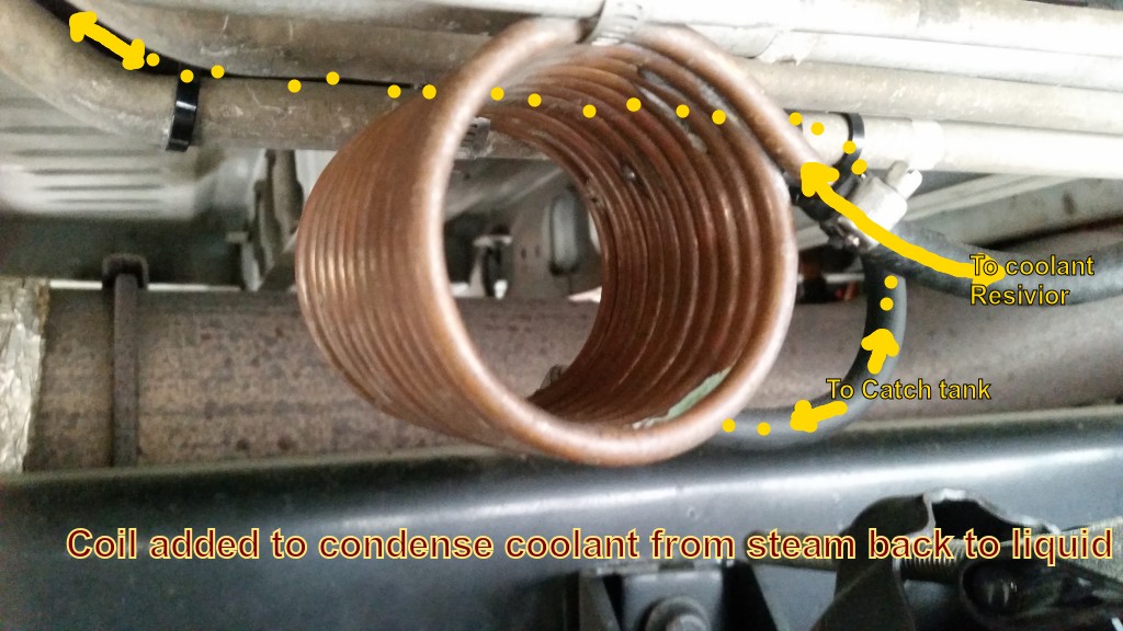

This is connected to a coil made from copper tubing I got from home depot. Oddly enough, it was a 1/4" copper tubing that fit the ID of the 3/8" hose. I simply wrapped the tubing around a spray-paint can to get it into a coil shape. I then just hose-clamped it under the cab of the truck in the air-stream somewhere convenient. ...
[attachment=2590]

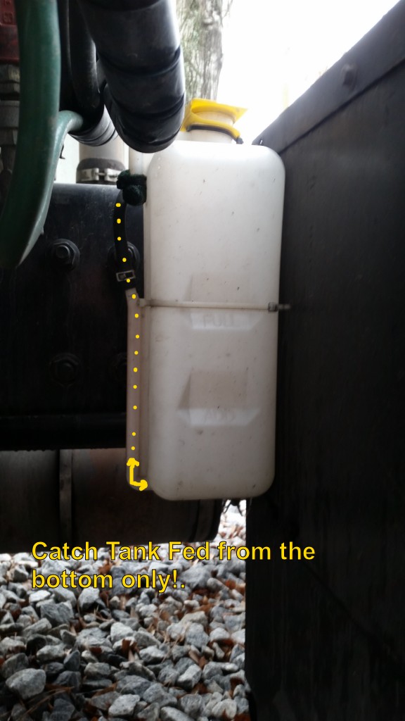

Then from the coil, I feed the tubing into the bottom of a catch-tank I got off amazon ( https://amzn.to/2Y3BDUp ). ...
[attachment=2591]

As the engine heats up and/or pulls hard up a hill, it will make some extra pressure and steam. This pressure and steam is relieved into the 3/8" hose. It then travels through the copper coil towards the catch tank. The coil cools and condenses it, turning the steam back into a liquid. The liquid travels into the catch-tank. Once the engine is finished pulling a hill and the system cools down a bit again, it will make a slight vacuum at the reservoir and suck the liquid coolant that has built up back into the system. This is why the catch-tank is fed at its bottom, and also why I had to seal off the coolant cap totally. The coolant cap normally will relieve any bit of vacuum, kind of like a check-valve in the system so it had to be blocked. Otherwise the coolant will not get sucked back into the system and just keep building up in the catch-tank.
