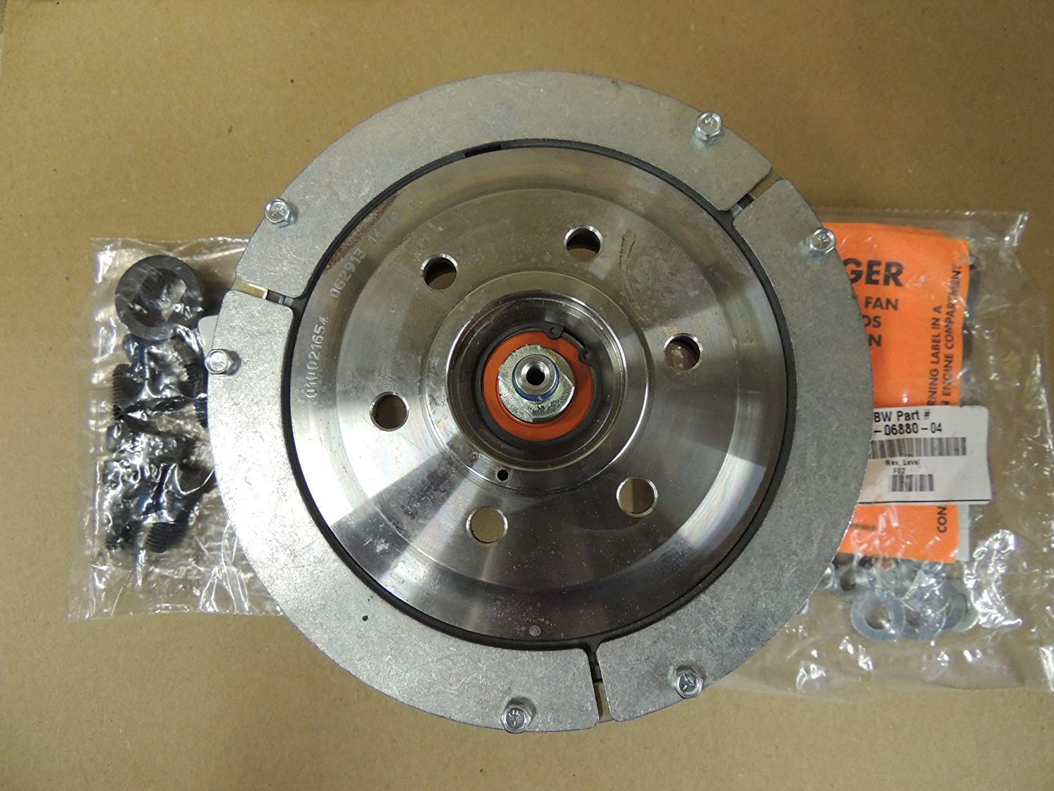

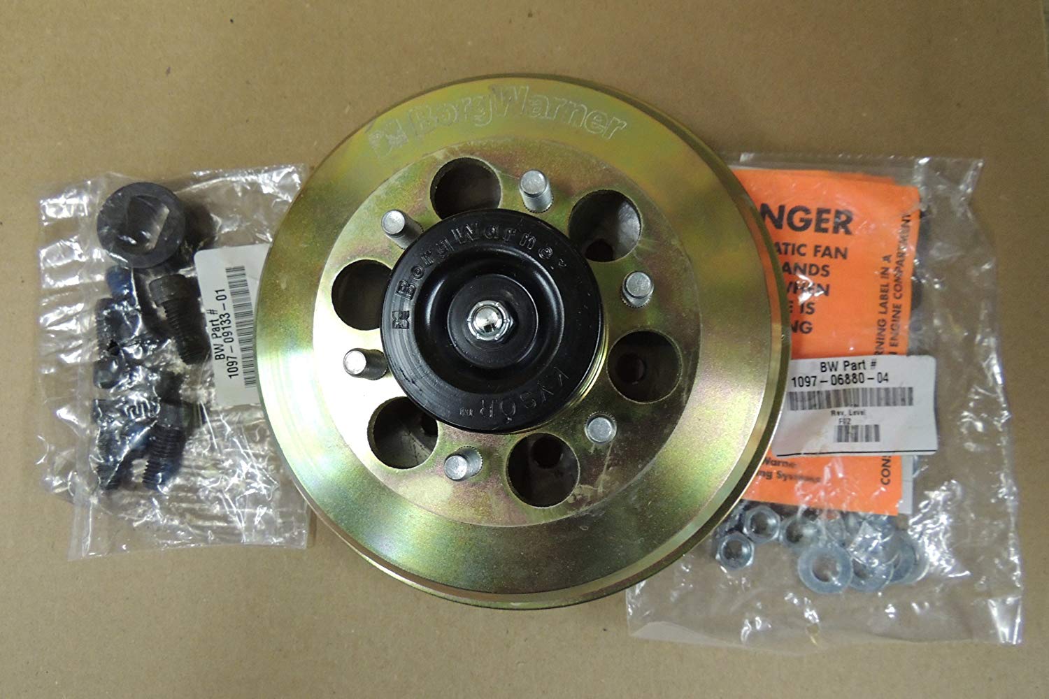

Here is my fan clutch and how it works, to help better understand what I was doing, with photos. The fan clutch uses air pressure to stop the fan from turning. When air is tuned off to the fan clutch, the fan starts spinning. This link is very good at explaining this. https://kit-masters.com/tech-tips-auto-lock/

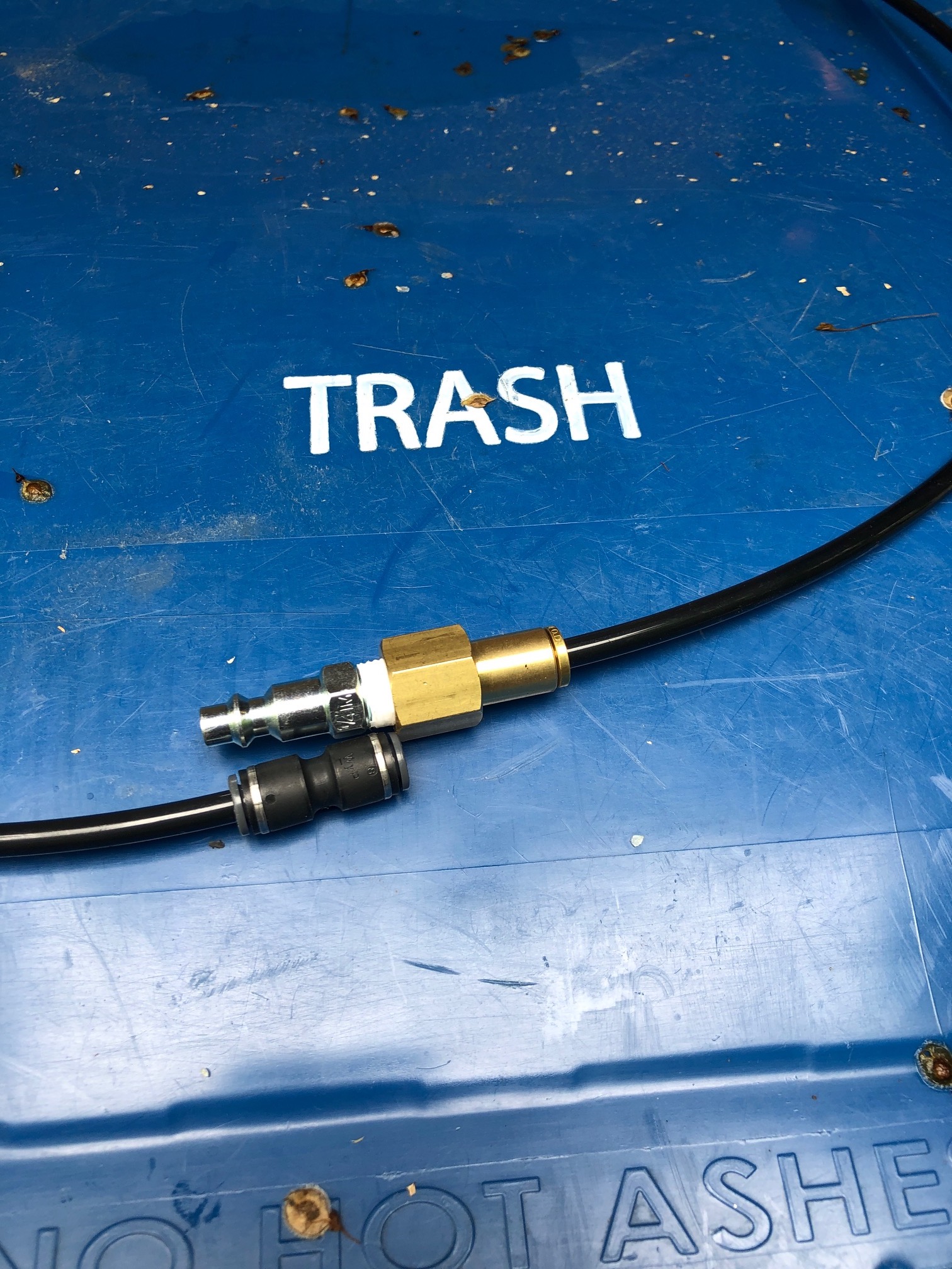

Well, I tapped on the fan clutch with a small brass hammer, nothing. I needed air. I called up to FleetPride and spoke with Jeff. He told me to come on up, he had the fittings I needed. Sure enough, he had a push pull fitting that adapted to a male air compressor fitting, 5 feet of 1/4" air line and a 1/4" push pull union to join my fan clutch air line up near the firewall. Perfect! All cost around $15

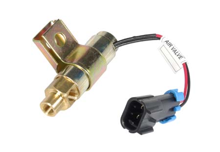

I disconnected the two airlines to the solenoid, there is an inlet side from the firewall, and the outlet side going to the fan clutch. I then removed and inspected the solenoid, it looked good, wiring was still intact and not brittle, plug intact at harness and solenoid.
I hooked up my new air line adapter to the air line that heads up front to the actual fan pulley using that 1/4" push pull union fitting I just picked up. I plugged the other end of the 1/4' air line into my little Lowes air compressor and turned it on to build pressure.
I just let her gently build pressure while gently tapping on the fan clutch body with a small brass hammer. Right around 90 psi the fan clutch popped! it was disengaged!

I then tested the solenoid, I wanted to be sure that was not the problem or had issues. I plugged in the solenoid to the motor harness. I then used the 1/4" push pull union to connect to the inlet air line going into the solenoid to my shop air compressor. I started the motor, and turned the fan override switch on and off. I could hear the whistle of air when I turned the switch off, and it stopped whistling when switch was turned on. Everything was working.

Here is what Jeff at FleetPride sold me.

Here is your fan clutch solenoid... At least on a ProStar.

Are the clutch disc's in the back replaceable? If it's like the old keyser hubs, you can easily pull the clutch disc out and give it a real light sanding to get the pieces of steel that embedded in it smoth again. This has kept mine from sticking for quite some time. Also, if it is held in by plates and 5\16th or 8mm head bolts, you can loosen these up real quick, give a tap or a spin of the fan to free it, then tighten everything back down.
Front view (side that faces the radiator)[attachment=5080]
Back view (with clutch plates and 5\16 or 8mm head bolts)[attachment=5081]
The actual clutch disc behind the plates that gets metal and steel and rust that you can lightly sand[attachment=5082]

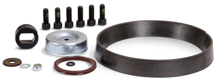

Also, many of these kinds of hubs are called extended duty hubs. Because if your clutch is worn down to where it wont grip anymore, you can sinply flip the clutch plates and bolt them back on. They will push the clutch disc in even further and give you much more use out of it.

(05-30-2019 )Chamberpains Wrote: [ -> ]Are the clutch disc's in the back replaceable? If it's like the old keyser hubs, you can easily pull the clutch disc out and give it a real light sanding to get the pieces of steel that embedded in it smoth again. This has kept mine from sticking for quite some time. Also, if it is held in by plates and 5\16th or 8mm head bolts, you can loosen these up real quick, give a tap or a spin of the fan to free it, then tighten everything back down.

I don't know if you can flip the plates, but I do know there is a rebuild kit available through FleetPride for my particular clutch. I just did not want to go there, as that would entail taking the darn thing off, and I need to get this truck into service this week, LOL! I'm McTurtle when it comes to mechanics, LOL!
