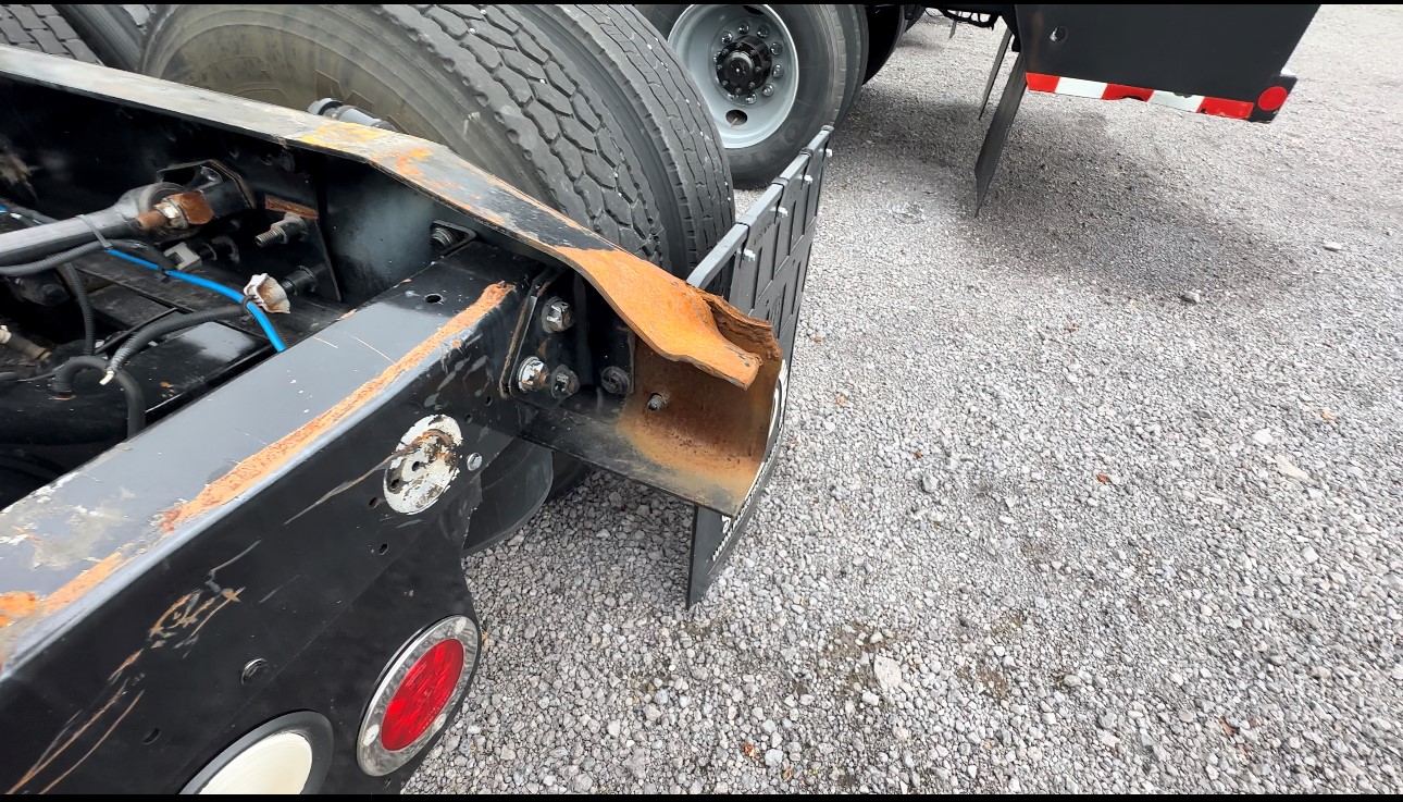

I am new to this forum and I am also a soon to be new O/O. I am looking at purchasing my first truck and I have found this 2014 Cascadia with 449,177.5 verified miles and 14,300 verified hours (3,753 hours are idle). The truck is a 10 speed with 3.55 rear end. I'm thinking/hoping I can get this truck for around $25,000 (they are asking $33,000) but wanted to get some opinions on a few things to possibly use as bartering chips. The truck will need new rubber all around, I will address the fuel pump immediately, do an EGR tune up, and full fluid change (engine, gear box, and rear end). It looks like the turbo has been replaced and possibly more, plan on calling Cummins in the morning to see if they have any records on it. The frame in the rear has been damaged, would that keep it from passing DOT? Attached is a phot as well as a video of a walk around, if you happen to look at it and would be willing to give thoughts, I would greatly appreciate it. I'm green and I'm trying to learn as much as I can as I go.

Change all pressure sensors, if demandated then have the program in the ecm checked by someone recommended here, and pull an abuse report with insite, look at all regen history.
The frame is a minor 20 minute repair that should be the least of your worries. If the truck looks like anything was neglected then everything was neglected. If you are looking at a truck and they tell you the engine just been rebuilt and don’t have documentation in their hand then walk away because chances are they are full of shi#t and just want to sell the truck, happens more than you would believe.
I'll see if I can find someone with insite that can pull the engine data. All mandated stuff is still there and should still be hooked up. I ran a RigDig report and it came out of the UPS fleet. The dealer doesn't have any info on the truck, it came from auction. I was initially looking at trucks double the price with about 100K less miles. My thought was if I can get this for $25K and I end up having to inframe it, I can. I have the funds set aside to do it if needed. This particular dealer appears to not do much to the truck after acquiring it, so I don't think they are painting everything and slapping lipstick on a pig. I have learned that trying to buy a used truck sucks and it's like throwing dice up in the air. Thank you for your thoughts.

-- As far as the frame damage to the back goes .. Shi$it happens.. Its a damn truck!. .. Get over IT!!!>...lol

About that 2014 Cascadia, you're right to think about the rear frame damage. That could be a big deal for DOT inspections. Your plan for negotiation looks good, primarily pointing out the need for new tires and all the maintenance you're planning.
