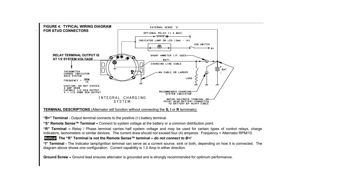

The Large top post is the B+ to the battery, Then the "R" terminal is for operating a relay to illuminate a charge indicator, etc....The "I" terminal is to illuminate charge warning lamp on the dash, the last bolt at the very bottom is for a ground cable. This model does not use any remote sensing wire,
Found a picture that illustrates the wiring on that alt.
[attachment=9346]
