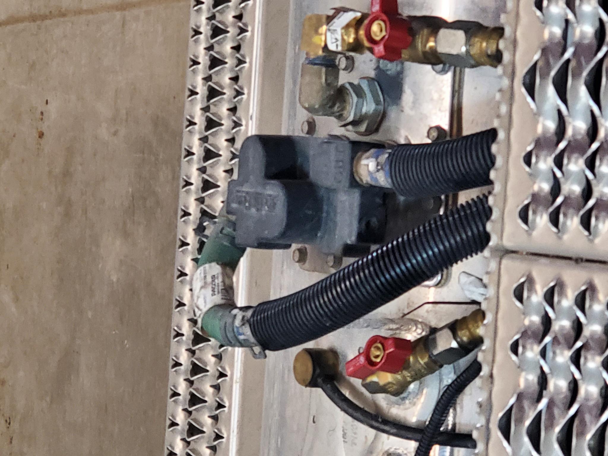

Wow. Thank you all for your responses. So as I sit here and scratch my head I'm wondering... the return line splitter was visually an open "t" as is the intake. I replaced them both but I was able to get one for the return that has plates and springs to help equalize pressure. Now that I have a valve on top of the tank I could put the original t back on and restrict flow back but I don't see how that could help the tank draw. Am I missing something? Thanks guys

Ok guys. Here's the update. I crawled under the truck again I unhooked the fuel lines. The splitter valves are brand new draw and return. The fuel lines are brand new with no obstruction and no kinks or breaks. The draw tubes are steel inside the tank and are not blocked or cracked. I also have restriction valves that I can adjust installed on top of tanks for the return lines. It had not been drawing at all on passenger side tank which is a120vs driver side is an 80. I am going for a 1 day run tomorrow and I'll let you know if the truck starts to draw on passenger side now. Thanks for all your suggestions, i appreciate it

With valves on the return and draw both tanks, it works great
