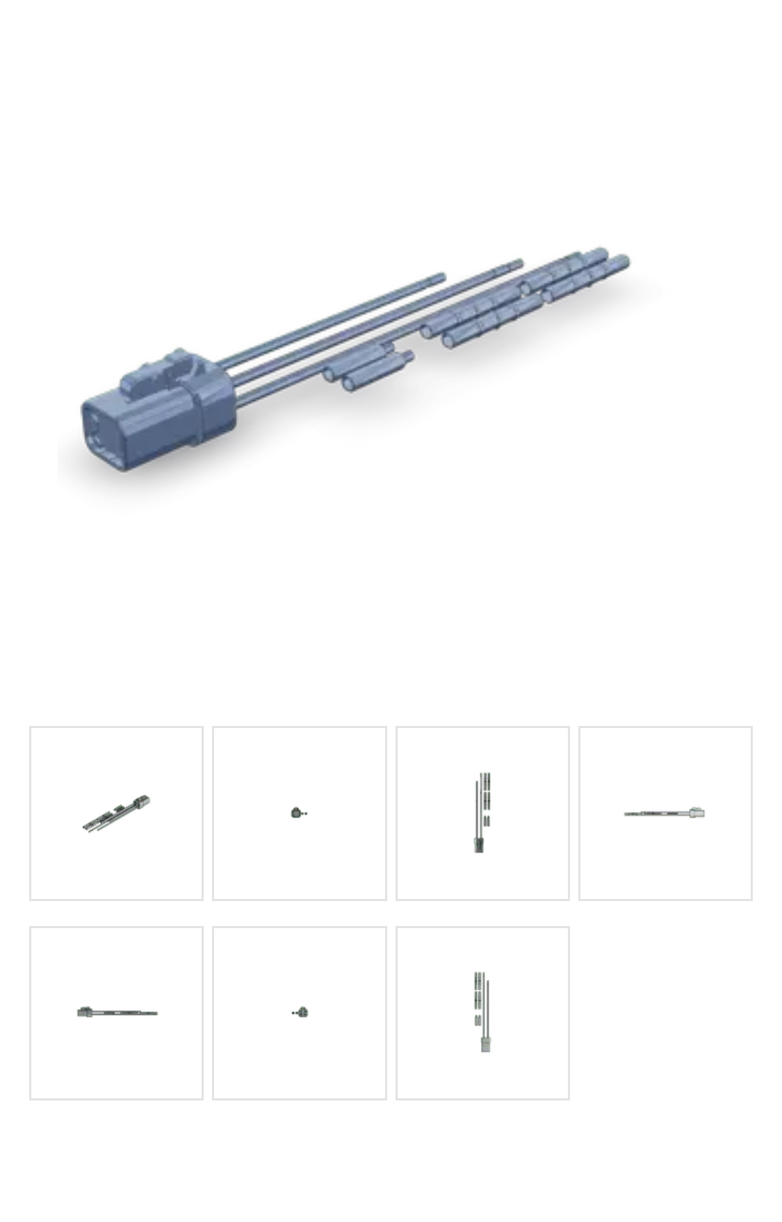

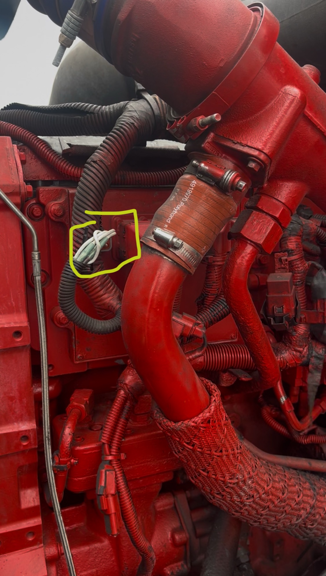

RE: Cm870 - 3406E - 05-02-2026
Forgot to update this
Issue was bad ECM connecter. Part number 5501850. Plugs into left side of computer.
