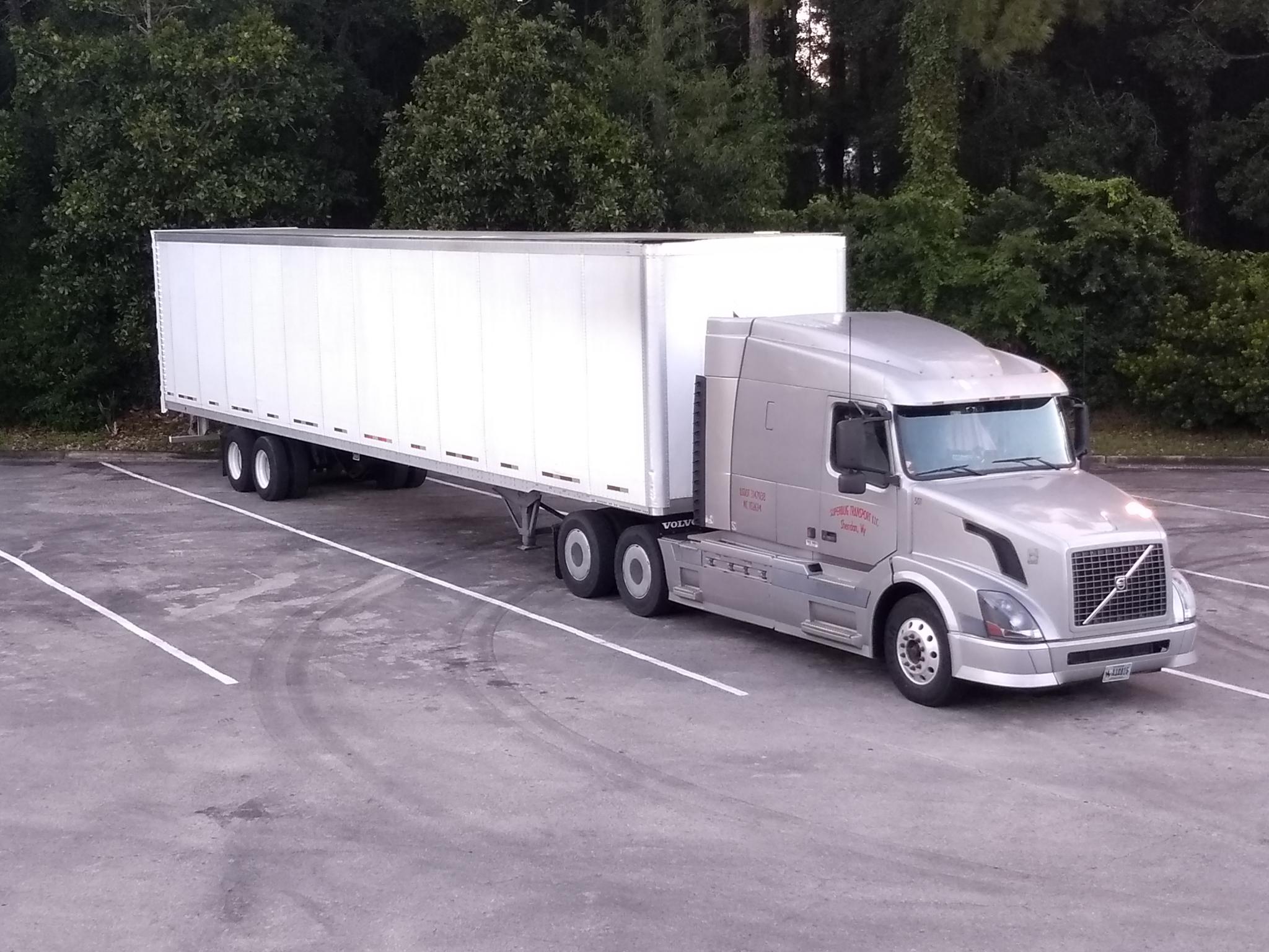

Been awhile, been busy with the move. Got the truck back to Wyoming with all of our stuff and the trip was great. Learned some more about the truck. Had 18K in the box and got 7.1 for the trip. Stopped by Mr Hagg's and had the program checked to see if the engine was still a 400hp, It was and I had him reprogram it to a 435hp. Was a great visit talking to the family. Very nice folks.
I'm not planning on adding the top fairing to the tractor, I want to put the nose cone fairing on the trailer and a rear cab spoiler that come on the newer trucks. I added extended side fairings before leaving Florida and put air tabs on them.[attachment=4184]
RE: Getting started with a 2005 Volvo with the ISX. - DKenworth - 08-28-2018
LOOKING GOOD VOLVO Mate! 7.1mpg is not that bad, do you think air tabs really works? I was thinking to put them on truck aswell a while ago.
