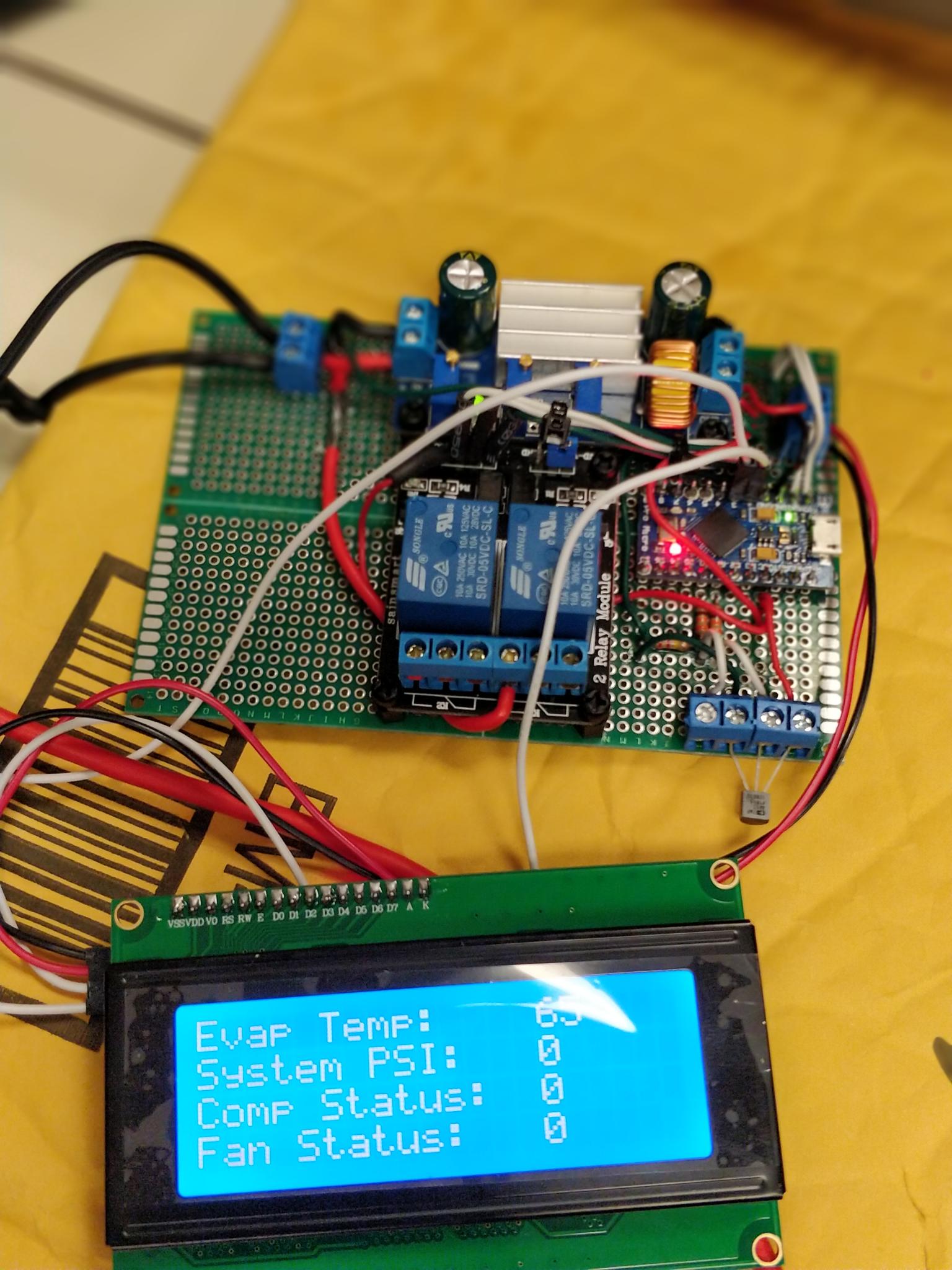

RE: Prostar ac - 74bassman - 06-26-2018 Im looking on Amazon and there is 100s of sellers on there selling pro micro. Which one do i want? RE: Prostar ac - Nilao - 06-26-2018 Any that's 100% compatible with arduinio. If your a poor solderer I think I would get one with the post preinstalled and a solderless breadboard. Then it will just about all be plug and play. But the proper way for long term reliability is soldering the components in place. RE: Prostar ac - Rawze - 06-27-2018 I updated the post to include the parts that I used. RE: Prostar ac - 74bassman - 06-27-2018 thank you Rawze. I will be ordering the parts tonight. Rawze i saw in one of your post that the Blend door actuator is the as a Jeep Cherokee, is this the same for all the actuators? I have my passenger seat out, and access to the blower motor ect. I am going to replace all while this is apart. RE: Prostar ac - 74bassman - 06-27-2018 parts are order. Thanks Rawze. To hot in Oklahoma to playing around with this AC. RE: Prostar ac - INTERPRO - 08-29-2018 Hi everyone, First of all, I want to thank you Rawze for all your work. I added some lines to display all these values in an I2C LCD display (4x20). I think its a great troubleshooting tool when you are on the go and cant hook up your gauges. It displays your System PSI, Evaporator temp, fan status, and compressor status. You only have to add 4 more cables to this screen and add this library (LiquidCrystal_I2C-1.1.2): GND> to your ground VCC> to your 5vdc supply SDA> to pin 2 SCL> to pin 3 Parts needed: https://amzn.to/2GT5eJr RE: Prostar ac - Rawze - 08-29-2018 lol, nice. I have LCD screens on a few different Arduino devices I have made too. Thats the beauty of them. RE: Prostar ac - INTERPRO - 08-30-2018 Yes sir, I love those I2C LCDs. Once my brother comes back from his trip, we will start installing it. Because of this, I haven't seen where those two A77B wires come from. I do not know if you meant to type A77B and A77 or I have the wrong schematic. According to this schematic A77B comes from J1 and A77 from J3. RE: Prostar ac - Rawze - 08-30-2018 (08-30-2018 )INTERPRO Wrote: Yes sir, I love those I2C LCDs. The AC compressor on/off is wire A77 The feedback for the high pressure sensors is A77B Both get cut away from the controller and wired to the arduino circuit instead. |
