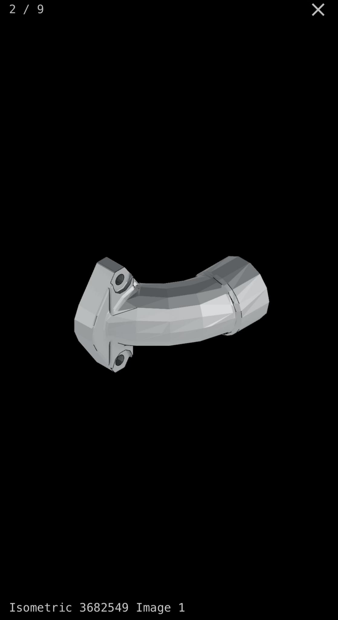

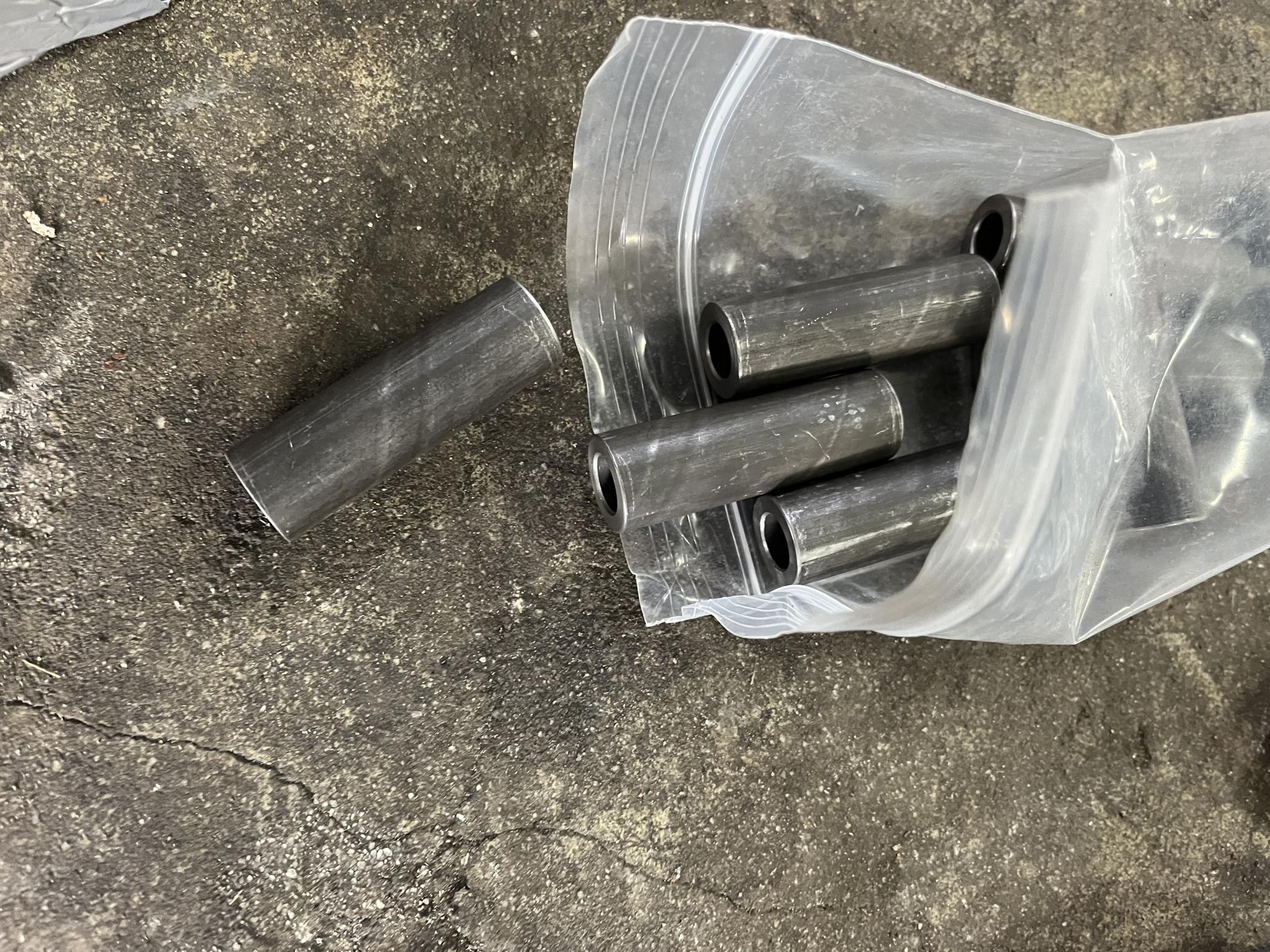

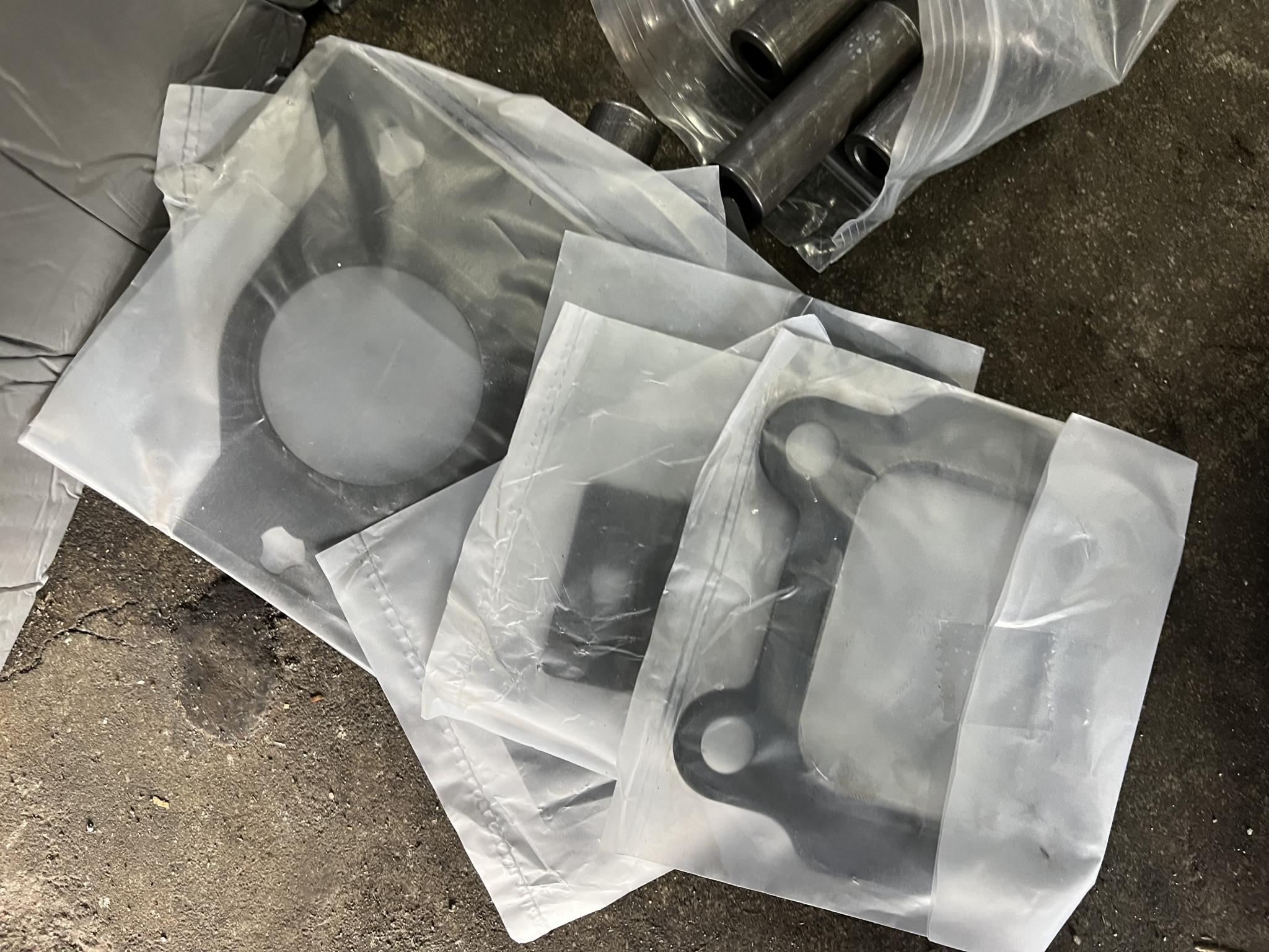

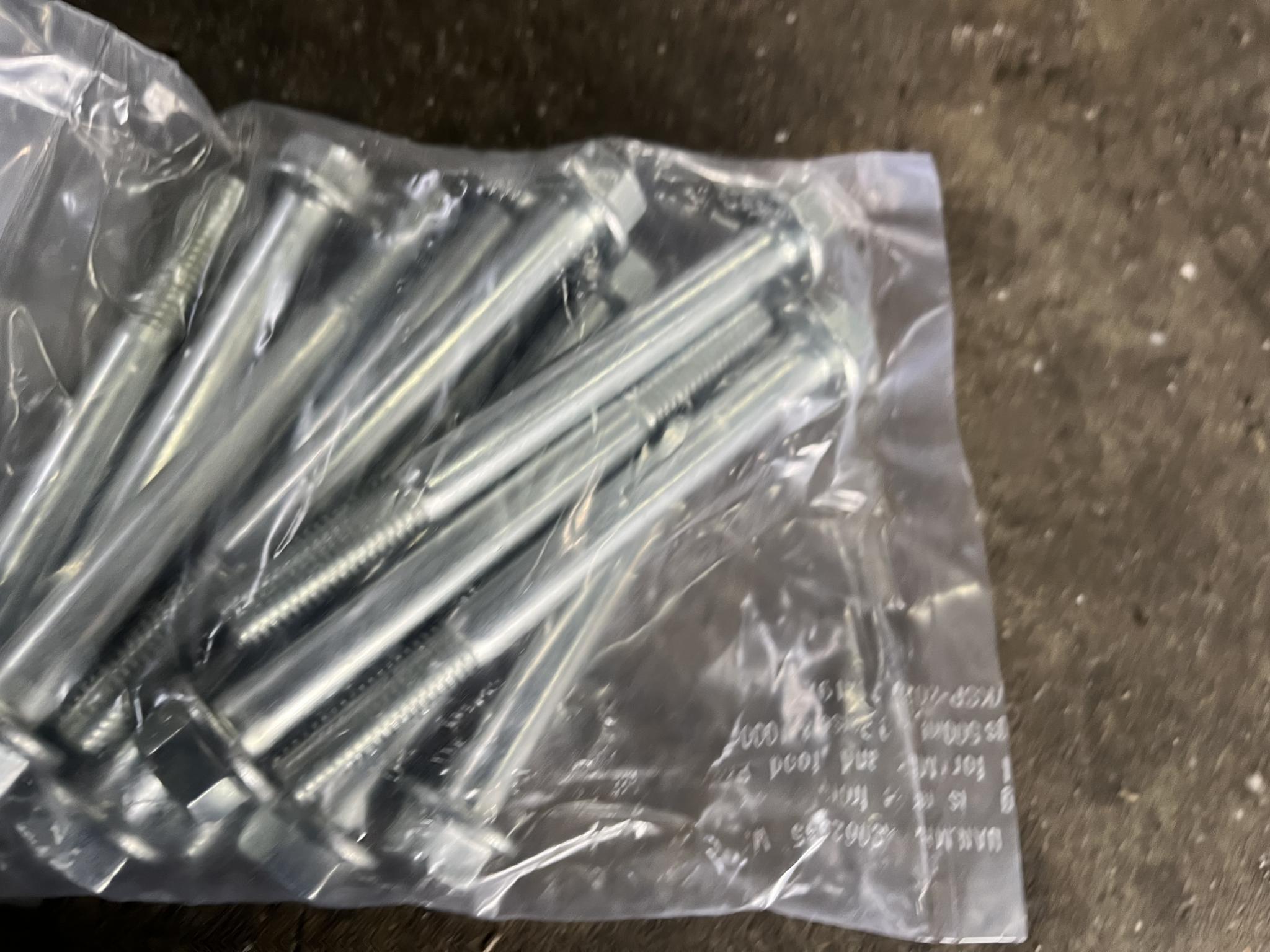

Just for reference mine was leaking too. First two from front of Engine. Replaced it with multilayer steel gaskets all studs and sleeve. Single piece Part number you are looking for without egr is 3682491.
