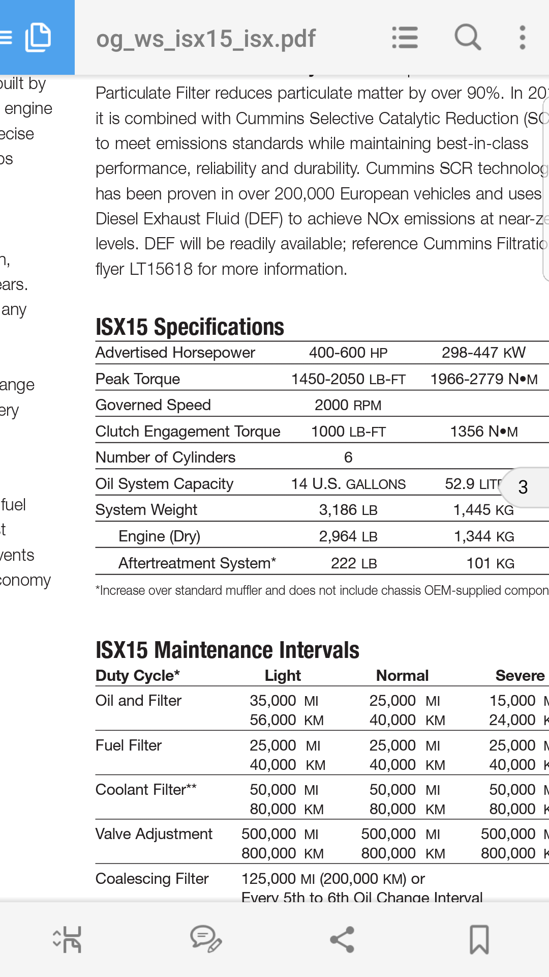

Everything I've found for oil capacity says 14 gallons for the ISX. I run 45 qts. and that puts it right at full so I'm clueless as to why Cummins says 56qts.or am I missing something???
RE: ISX, Oil check procedure? - JMBT - 05-20-2017
That's strange, must be a different spec then mine. My CM2250 manual shows total system capacity with filer and all residual 11gal....?
RE: ISX, Oil check procedure? - Signature620 - 05-20-2017
Dont confuse total system capacity with oil change capacity. A dry ISX, after assembly or rebuild, will take 50-52L. During a service, they will take about 45L inc. filter. The film of oil on everything really adds up, and depending on the angle of the engine there can be 2-3L retained in the shallower end of the oil pan and just below the drain plugs at the deep end.
