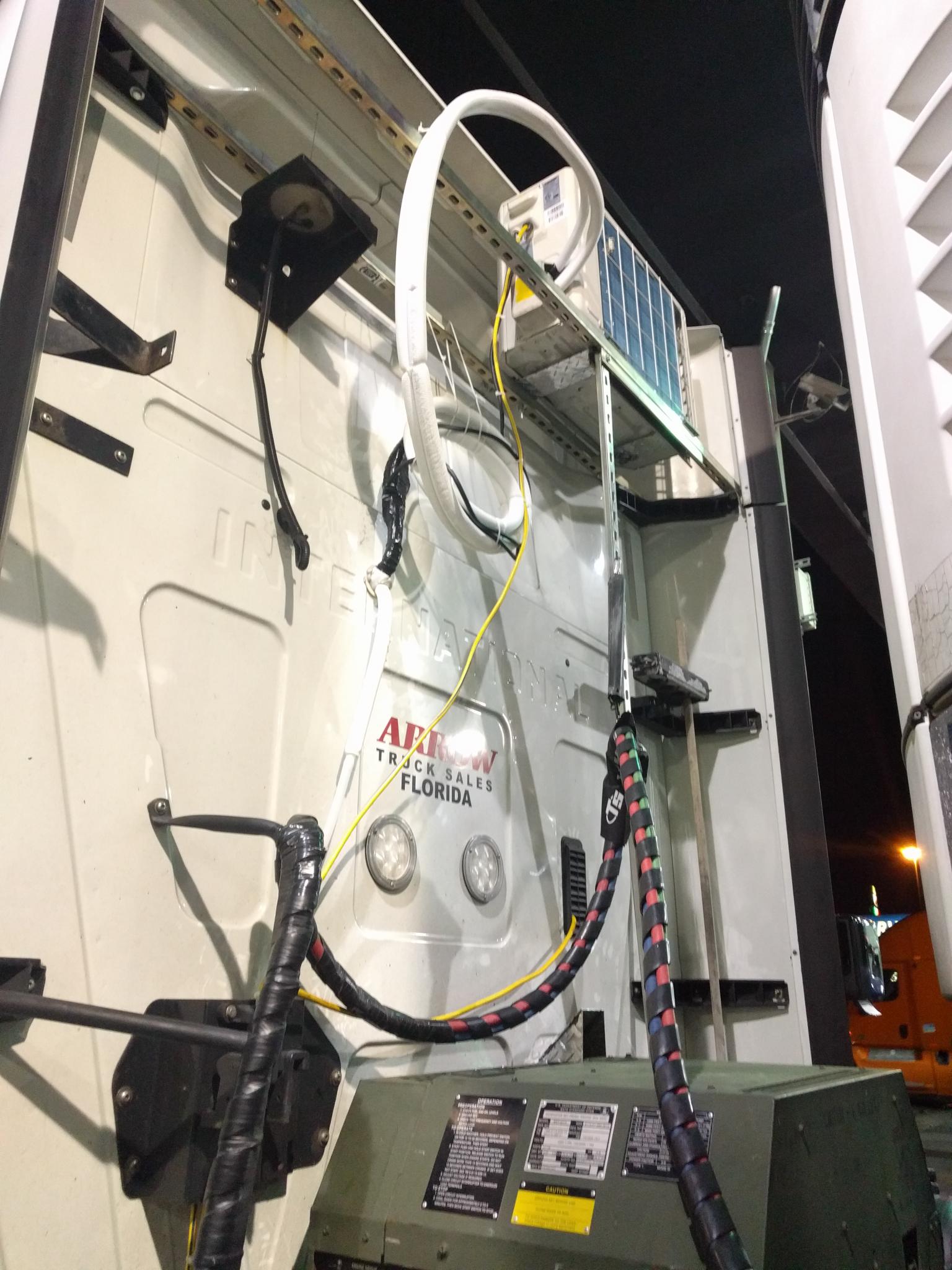

Alternative APU System I saw last night. - flying240 - 03-14-2019

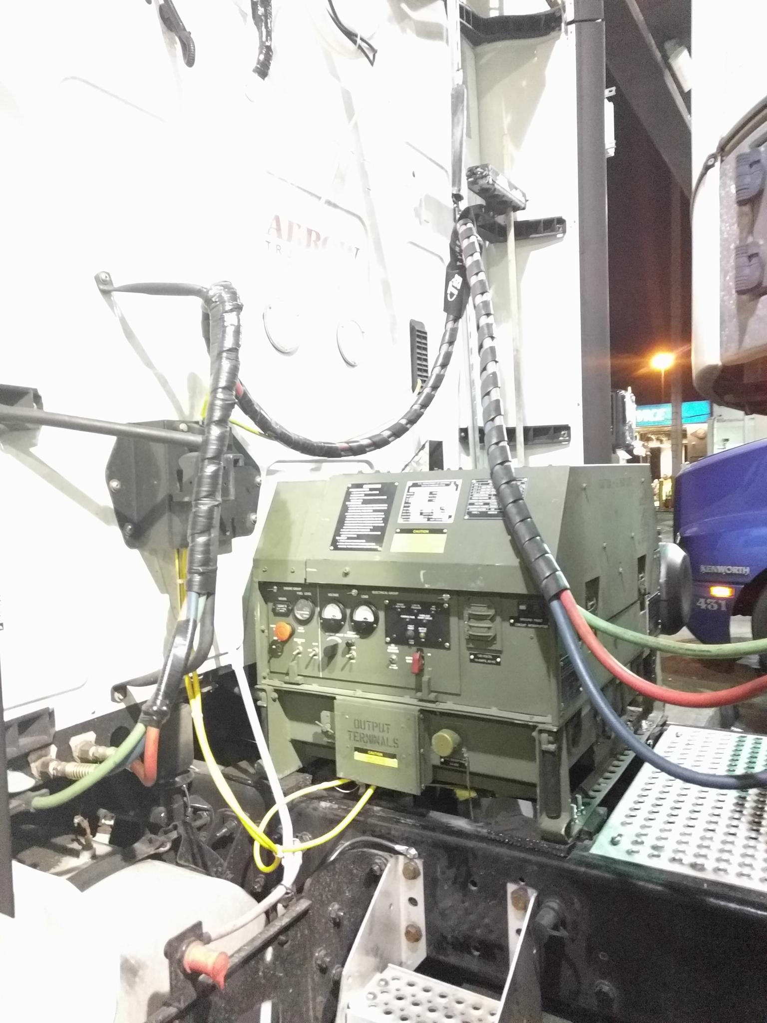

Not bad looking. What are your thoughts?
RE: Alternative APU System I saw last night. - Waterloo - 03-14-2019
Nice. Military surplus I take it?

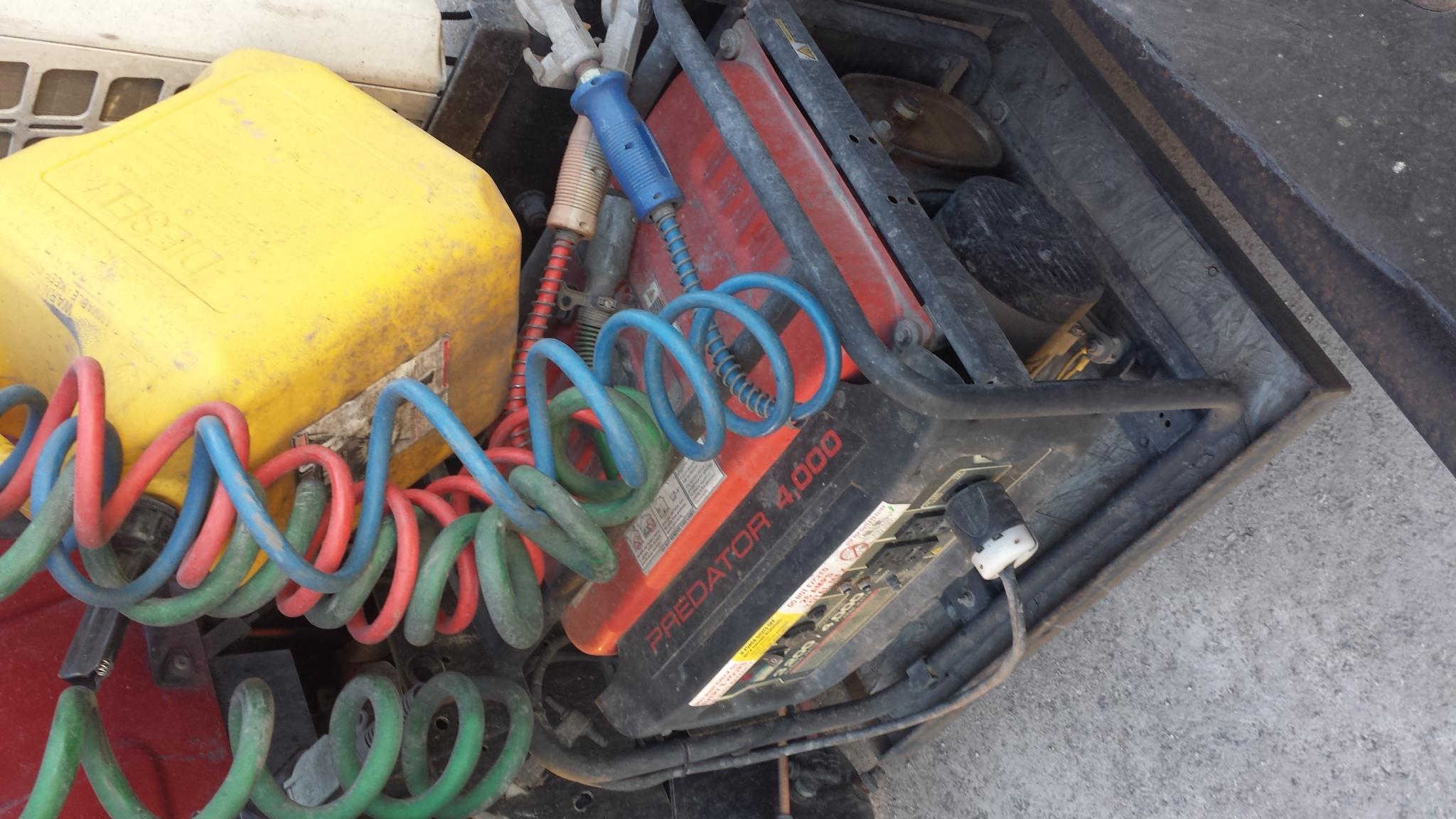

RE: Alternative APU System I saw last night. - Rawze - 03-14-2019

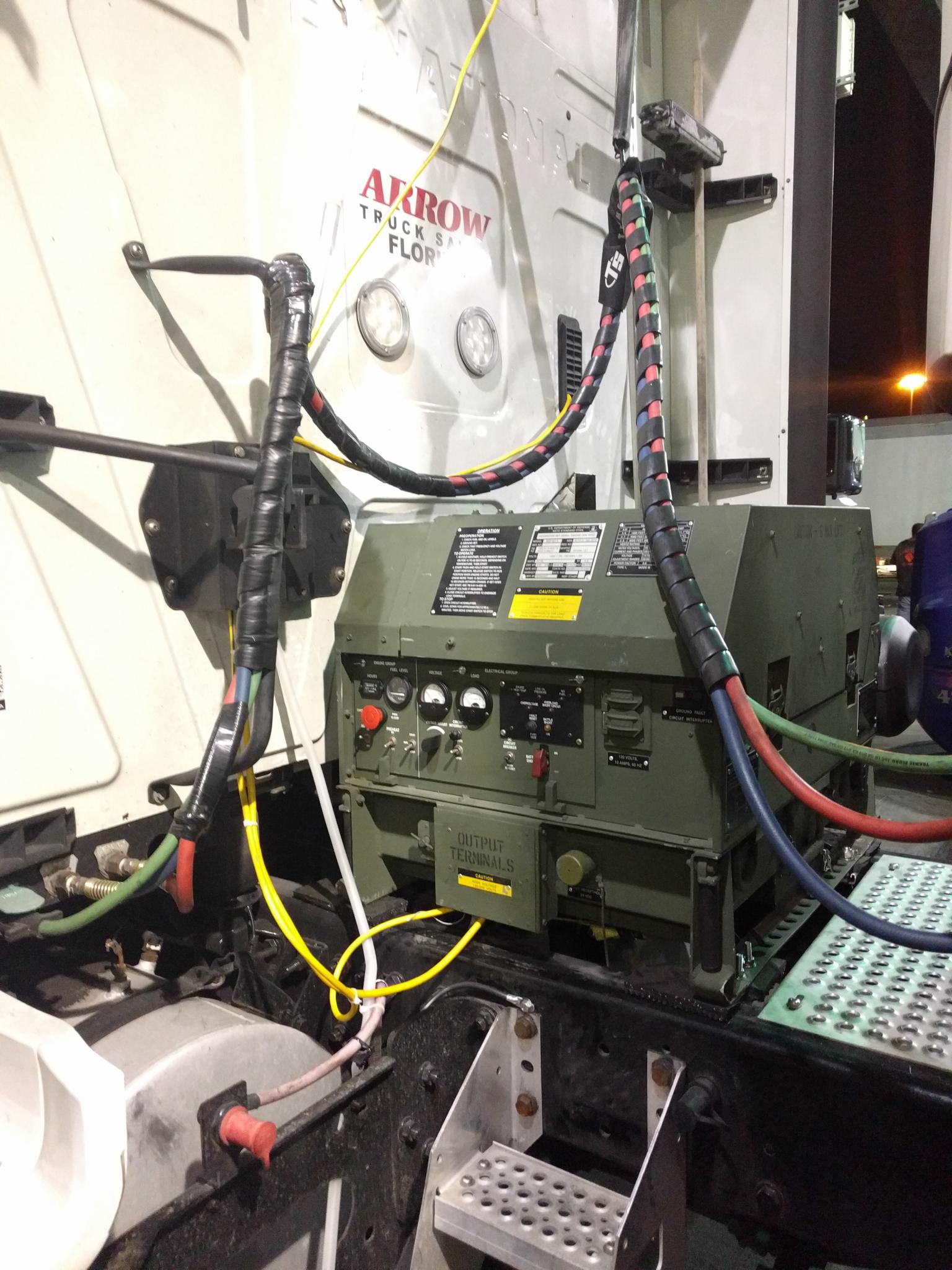

(03-14-2019 )flying240 Wrote:  Not bad looking. What are your thoughts?
[attachment=4733]
[attachment=4734]

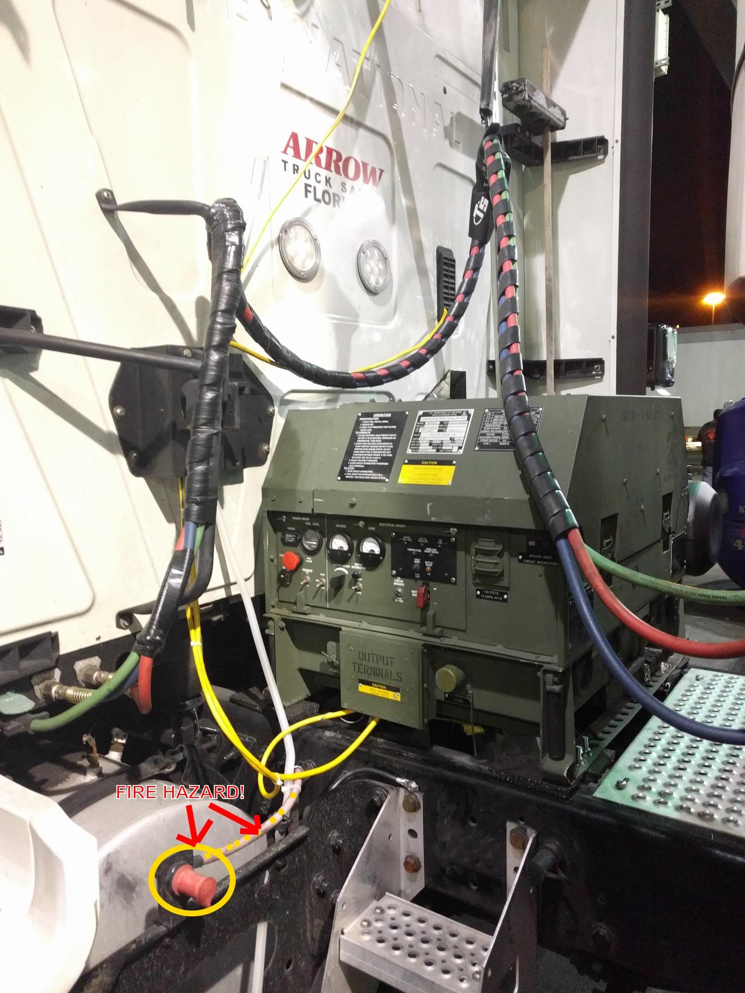

(see pic above)...
Had a carrier that has over 1,000 prostars in their fleet inform me a long time ago that I shoud remove/disconnect this same jump-start post at the battery terminals on my truck. They said they had several trucks burn to the ground over shorts due to corrosion, etc. getting into that same wire you have there. -- I removed mine entirely, all the way back to the batteries a long time ago.
Just thought I would mention it.
Also, all the wires you added need an outer layer of split-loom, or some other secondary protective sheeth to be D.O.T. compliant.

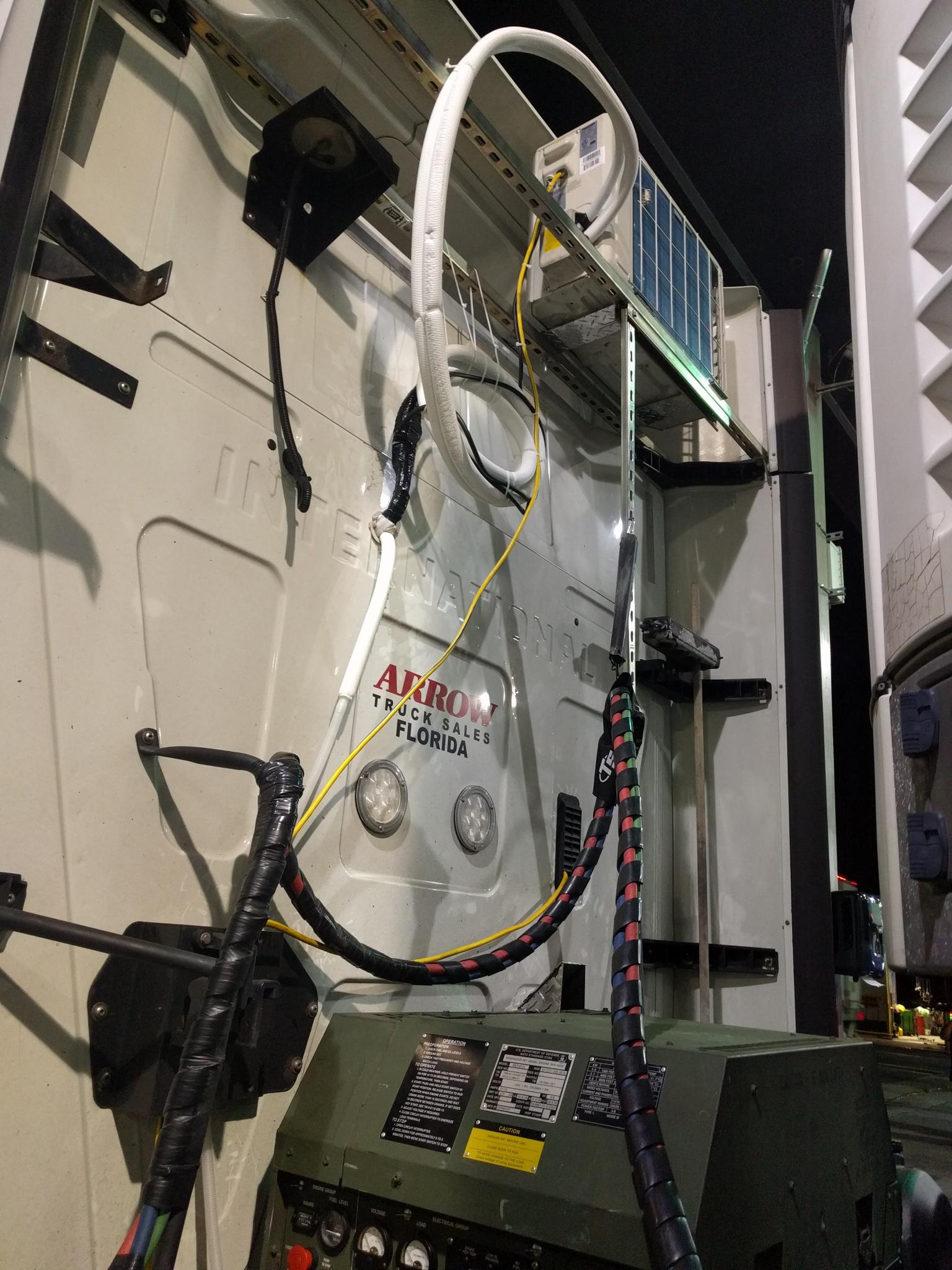

RE: Alternative APU System I saw last night. - snailexpress - 03-14-2019
I have it for almost 4 years now. Working good.
http://rawze.com/forums/showthread.php?tid=1569&page=2

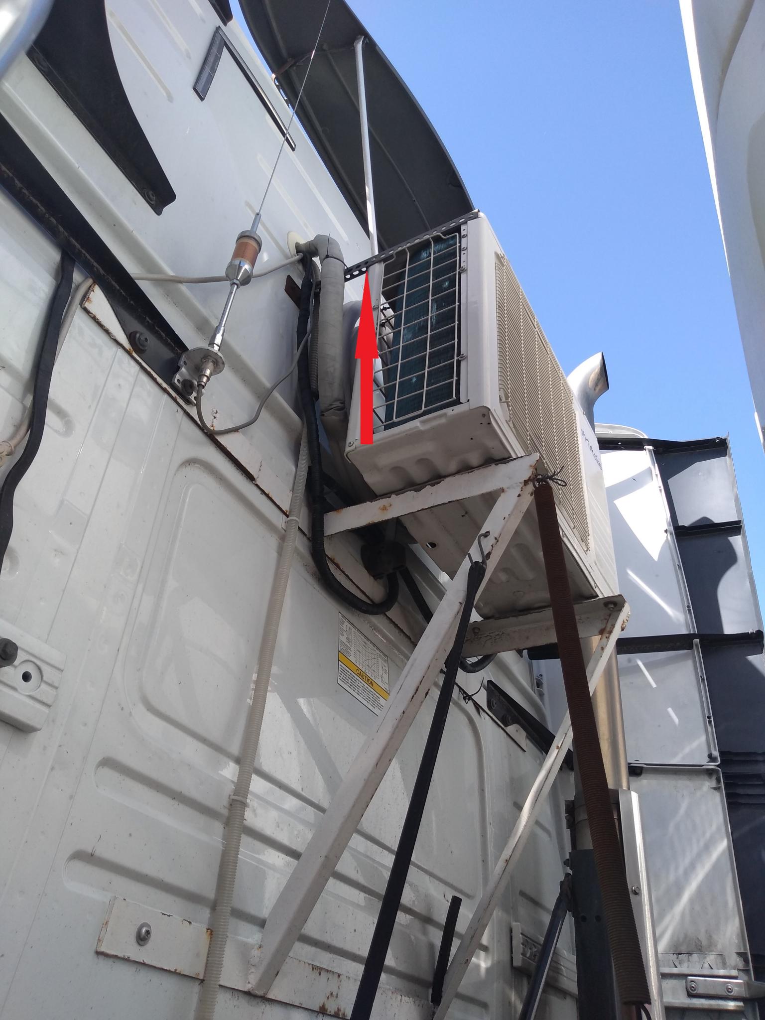

The pictured setup (in post#1) shows example of horrible dangerous craftsmanship or lack of it.
Supporting structure weak and will fail in case anything hit the side fairing.
Freon copper pipe has lot of play and vibration will brake it very soon.
Compressor unit sitting too high on the cab. This will move center of gravity point up and amplify side to side shaking.
No brackets to secure compressor from front-back inertia force.There is only 8 spot weld points hold the compressor unit to the rest of this mess.

Seen on the road
[attachment=4741]
[attachment=4742]
Aux jug is a little funky and I'd want a cover for the genset. Basic idea of setting it on the catwalk works for me.

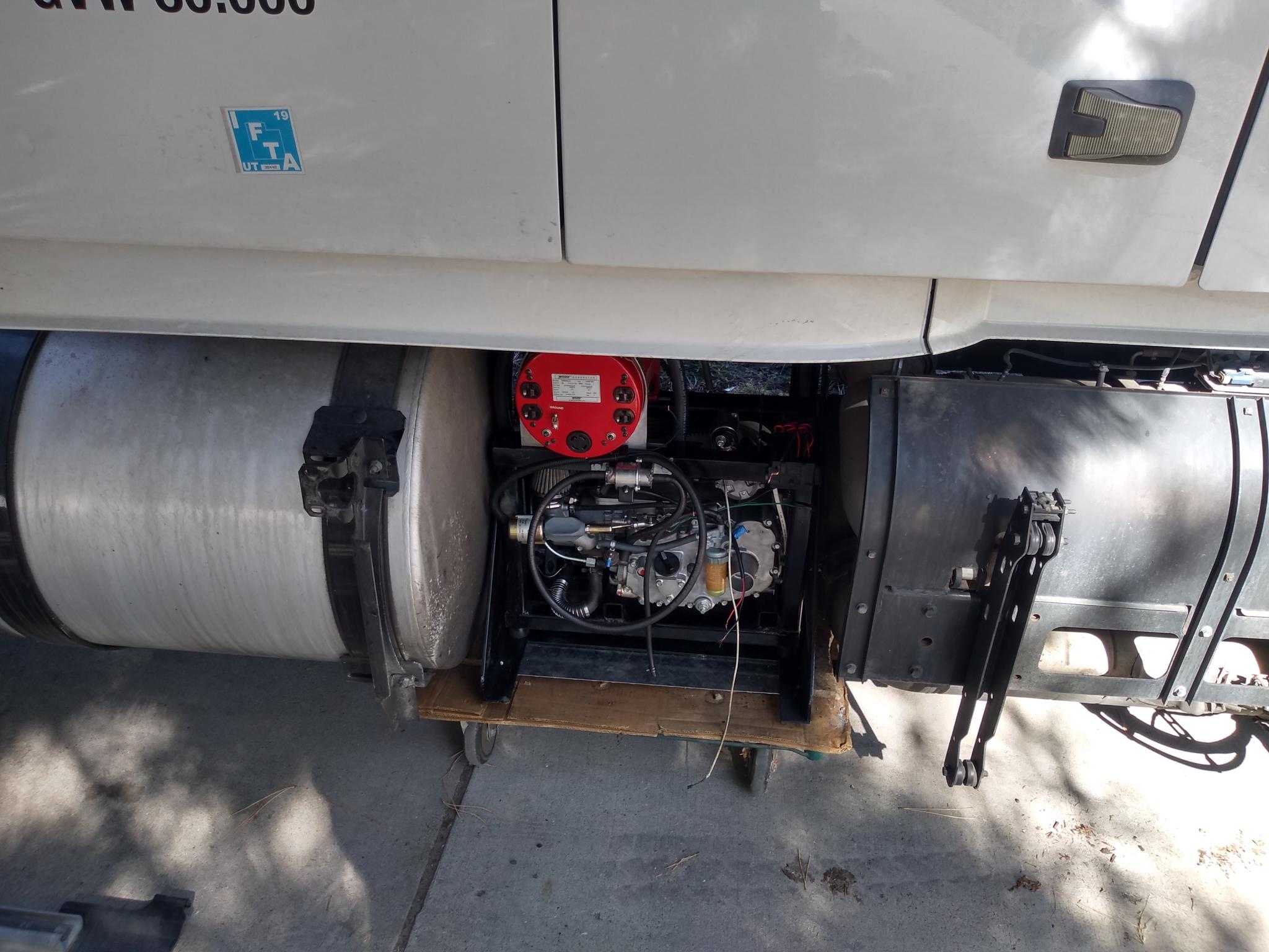

Have new design gen set installed. Now it's water cooled Kubota diesel engine with 4.5 KW gen head installed on the frame. Remote control with monitoring oil pressure, voltage, RPM, temperature, hours meter, batteries voltage and automatic start for battery charging from the sleeper.
[attachment=6518]
[attachment=6519]
Old air cooled diesel generator looking for new owner. Price is 1800 Reposado 0.75l. :big_smile2:
RE: Alternative APU System I saw last night. - Chamberpains - 04-18-2020
The securement of the tubing and wires of the OP pics shows that whoever put it together has a great idea on how to make thing LOOK good. But zero clue on how much abuse and vibration that stuff is gonna take.
The rope holding the tubing is gonna cut and break in no time. Snailexpress is right about the the copper tube failing rather quickly. All those fancy looking brackets are gonna tear the fairings apart and rip a hole in the back of the cab after a few good bumps. I forsee this guy being broke down with a tow bill and the cops on scene when it all comes crashing down while he's driving. Snails' set up is much simpler and secure. Less is better when mounting stuff to the back of the cab.
