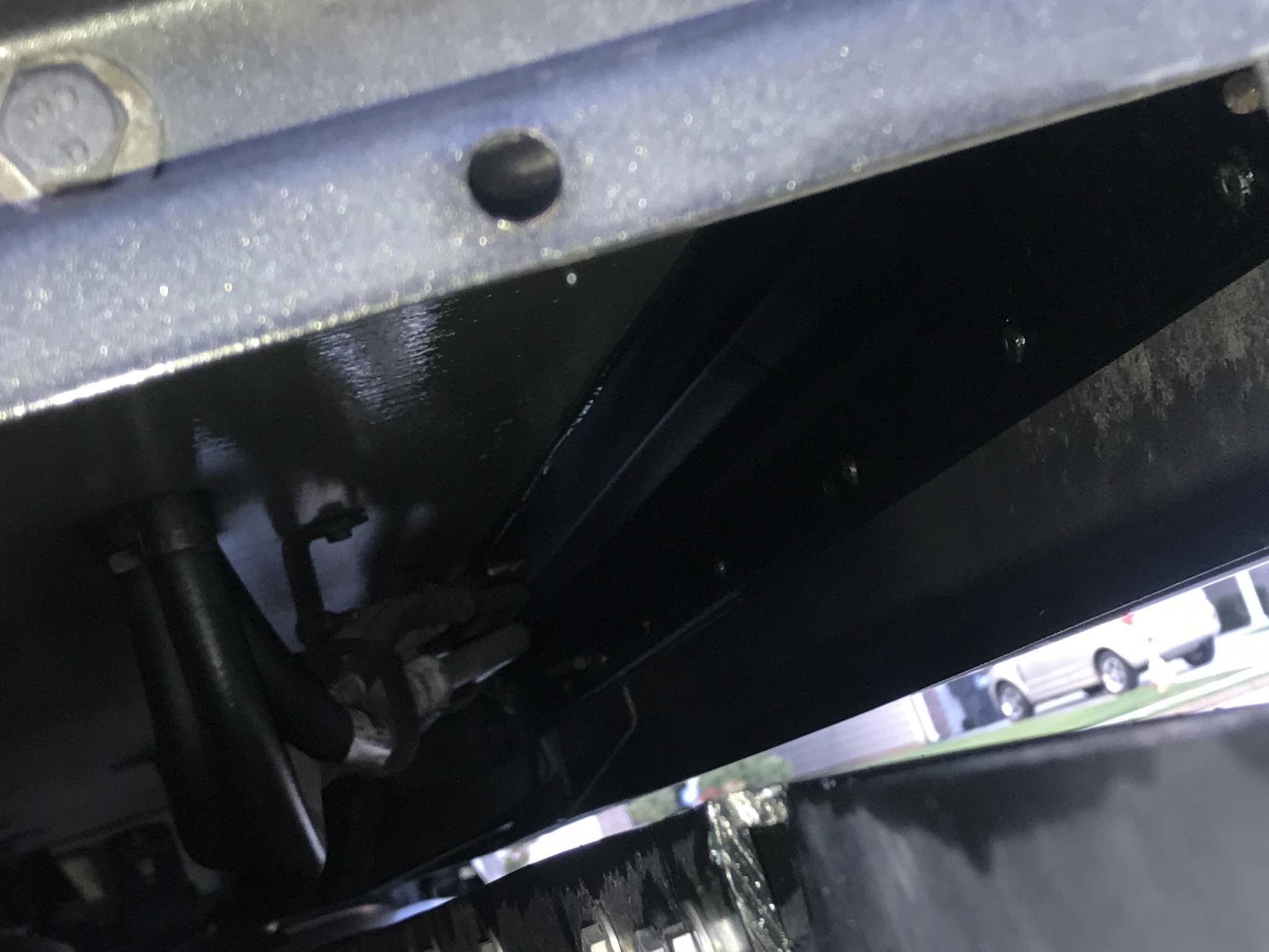

freon leak - fishermen13 - 06-22-2019 i have a 2013 kenworth t700 with a king thermo apu i noticed that it was freon on the side of my truck looked underneath and seen freon all under the bottom of the cab ac in the front cab still blows cold but the back where the beds are id blowing warm air ant help will be appreciated RE: freon leak - smorgan87 - 06-22-2019 Theres several places freon can leak. Either the evap has a hole in it, the oring seal at the connection is bad or a hose is bad. With that much oil blown oil id say probably a hose. Kind of strange the front is blowing cold but the sleeper isnt as that they are supplied by the same compressor. Unless your saying the apu air isnt blowing cold. RE: freon leak - fishermen13 - 06-22-2019 (06-22-2019 )smorgan87 Wrote: Theres several places freon can leak. Either the evap has a hole in it, the oring seal at the connection is bad or a hose is bad. With that much oil blown oil id say probably a hose. Kind of strange the front is blowing cold but the sleeper isnt as that they are supplied by the same compressor. Unless your saying the apu air isnt blowing cold. i think the hose might had went bad im lift the bed up and seen the blower but i didn't see any leak i am gonna take it off and see if the hoses had bust RE: freon leak - fishermen13 - 06-22-2019 (06-22-2019 )fishermen13 Wrote:(06-22-2019 )smorgan87 Wrote: Theres several places freon can leak. Either the evap has a hole in it, the oring seal at the connection is bad or a hose is bad. With that much oil blown oil id say probably a hose. Kind of strange the front is blowing cold but the sleeper isnt as that they are supplied by the same compressor. Unless your saying the apu air isnt blowing cold. where is the evap thats under the bed right RE: freon leak - fishermen13 - 06-22-2019 (06-22-2019 )fishermen13 Wrote:(06-22-2019 )fishermen13 Wrote:(06-22-2019 )smorgan87 Wrote: Theres several places freon can leak. Either the evap has a hole in it, the oring seal at the connection is bad or a hose is bad. With that much oil blown oil id say probably a hose. Kind of strange the front is blowing cold but the sleeper isnt as that they are supplied by the same compressor. Unless your saying the apu air isnt blowing cold. RE: freon leak - smorgan87 - 06-22-2019 The evap should be right next to the blower. U can look at where the refrigerant lines go into the cab as a reference. Are we talking about the apu a/c is leaking or the main engine on sleeper ac is leaking? RE: freon leak - fishermen13 - 06-22-2019 (06-22-2019 )smorgan87 Wrote: The evap should be right next to the blower. U can look at where the refrigerant lines go into the cab as a reference. Are we talking about the apu a/c is leaking or the main engine on sleeper ac is leaking? i seen it the evap i haven't been able to see if it the sleeper or the engine but the cab is still blowing kind cool and the sleeper is warm but i think they are all tied in RE: freon leak - smorgan87 - 06-23-2019 If engine is running and front ac is cold but rear ac is not id check the blend door for the rear ac. Id also hook up some gauges and check the pressure on both then main ac and apu ac. RE: freon leak - fishermen13 - 06-23-2019 ok ima try that and ill get back to you thanks sir |
