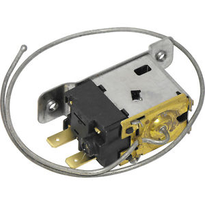

Lonestar you have pretty much everything right on. The last part your looking for is the thermostatic cutout switch to shut the compressor off when its to cold. One of these worked for decades.
[attachment=5187]
Shove the thermostat lead straight into the fins of the evaporator and wire it in to cut the power to the compressor.
They also make dual sensors (high\low) for controlling the compressor safety cutouts. Freightliner and International used them for decades also. If you want a simple system, just get the wiring diagram for an International 9400 or 9200.
