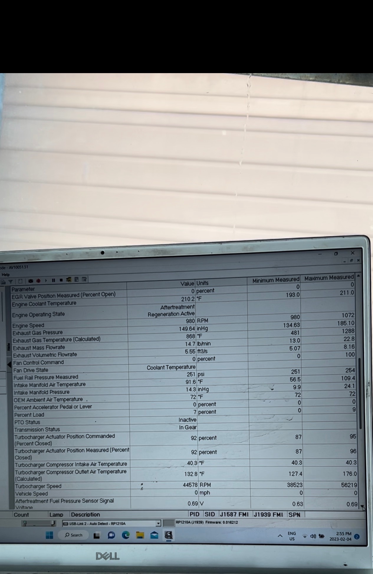

RE: Help! Cummins Isx CM871 Programming - mxmom777 - 02-04-2023
[attachment=8775]
RE: Help! Cummins Isx CM871 Programming - Rawze - 02-04-2023
(02-04-2023 )mxmom777 Wrote:  ...
why does your engine still show the AV10051.xx program?. This is the program for out-dated dpf components that are not even available any more.
what is the engine ser#?... and the DPF part# stamped on the side of the DPF itself?.
and is everything genuine OEM only parts?
79382815 is the engine serial number.
The DPF is an aftermarket Skyline emissions 1280.
What do you mean the AV10051.xx program
