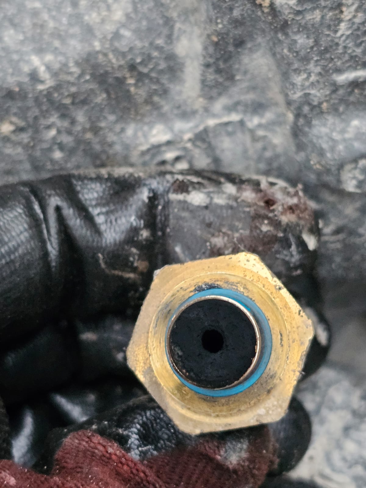

203 000 mile mx13 that had 25 000 miles ago EGR cooler washed, plugged imap sensor replaced, emap sensor replaced, new dpf doser fitted is having turbo related fault codeas as of lately.
Pulled turbo actuator, opened up regreased and calibrated. Turbo side lever felt little stiff, that improved with just wiggling it around some time. BUT imap sensor reading fluctuates with engine off and ignition on. Another IMAP ordered from dealership again. All parts that were replaced were purchased from official dealership and should be genuine parts.
Imap sensor was not plugged up. I did clean it still, nothing changed.

Today, (Subject: 2021 MX13 pac car dpf and scr efficiency issues in need of egr tuneup )
RE: 2021 MX13 pac car dpf and scr efficiency issues in need of egr tuneup
Engine OFF, ignition ON, pressure sensor reading was fluctuating between 0-12hPa.
I decided to pull sensor to see how it looks AFTER 25 000 miles (new imap is not stocked by paccar dealers around here, it has to be ordered), since it was off anyways I did clean it without solvents using tip of zip tie .
