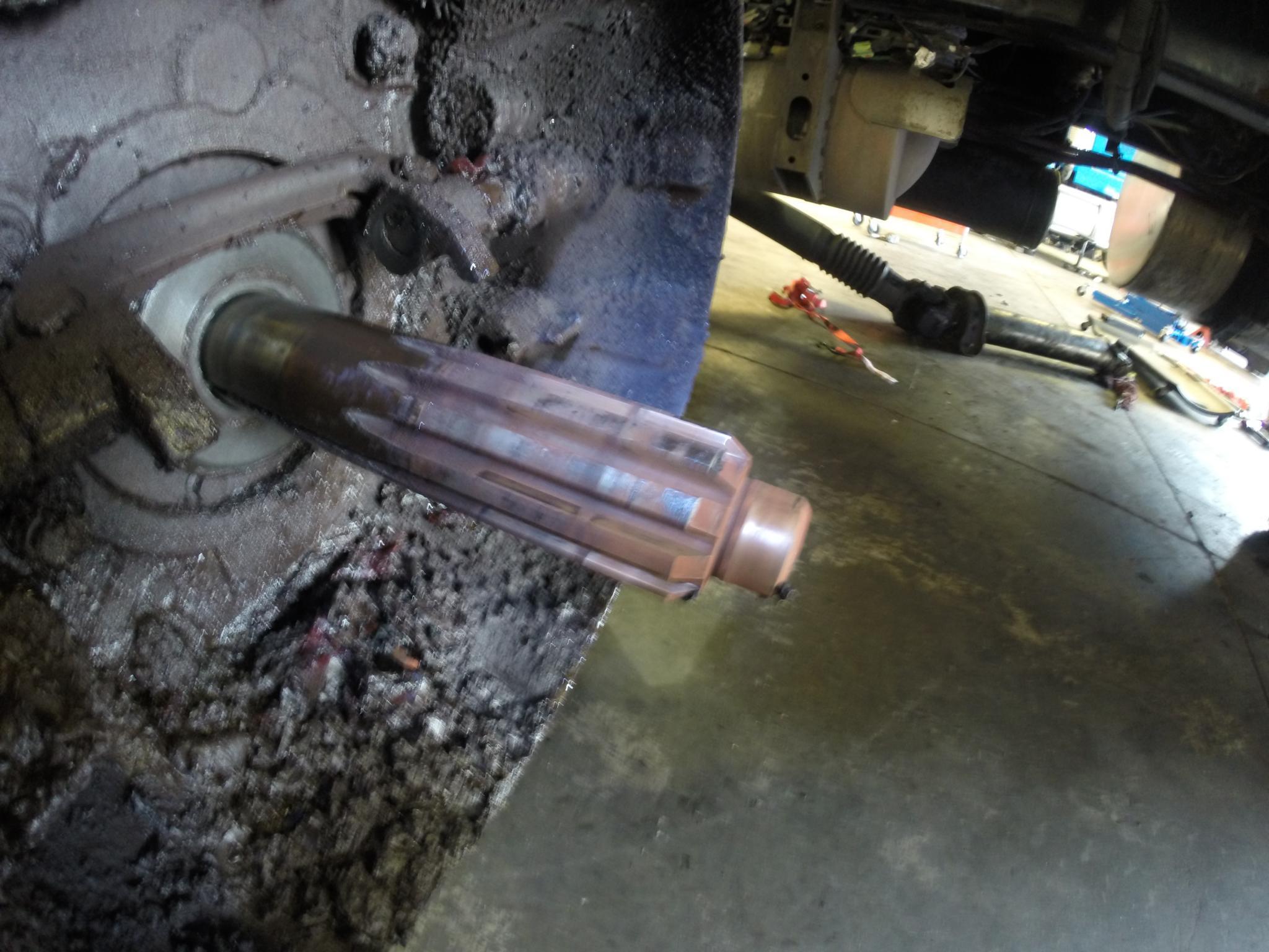

Input shaft after million miles+ ..

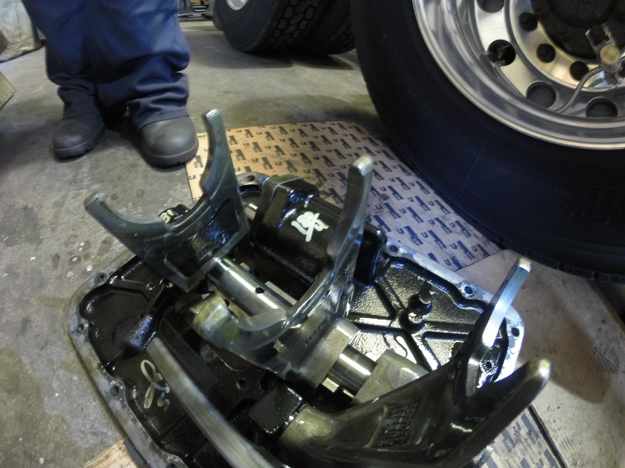

Forks, still no wear after million miles in mostly neutral ..

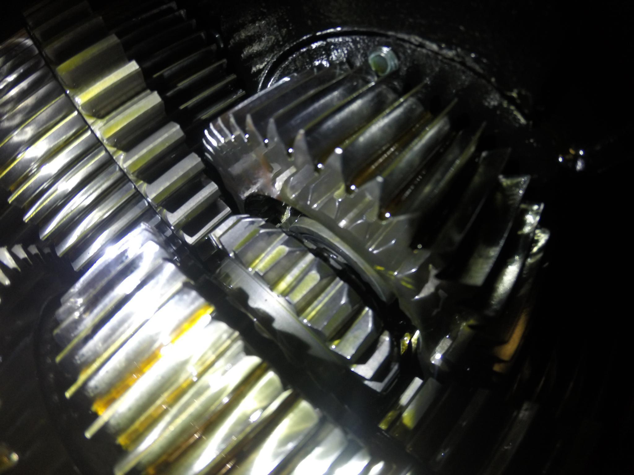

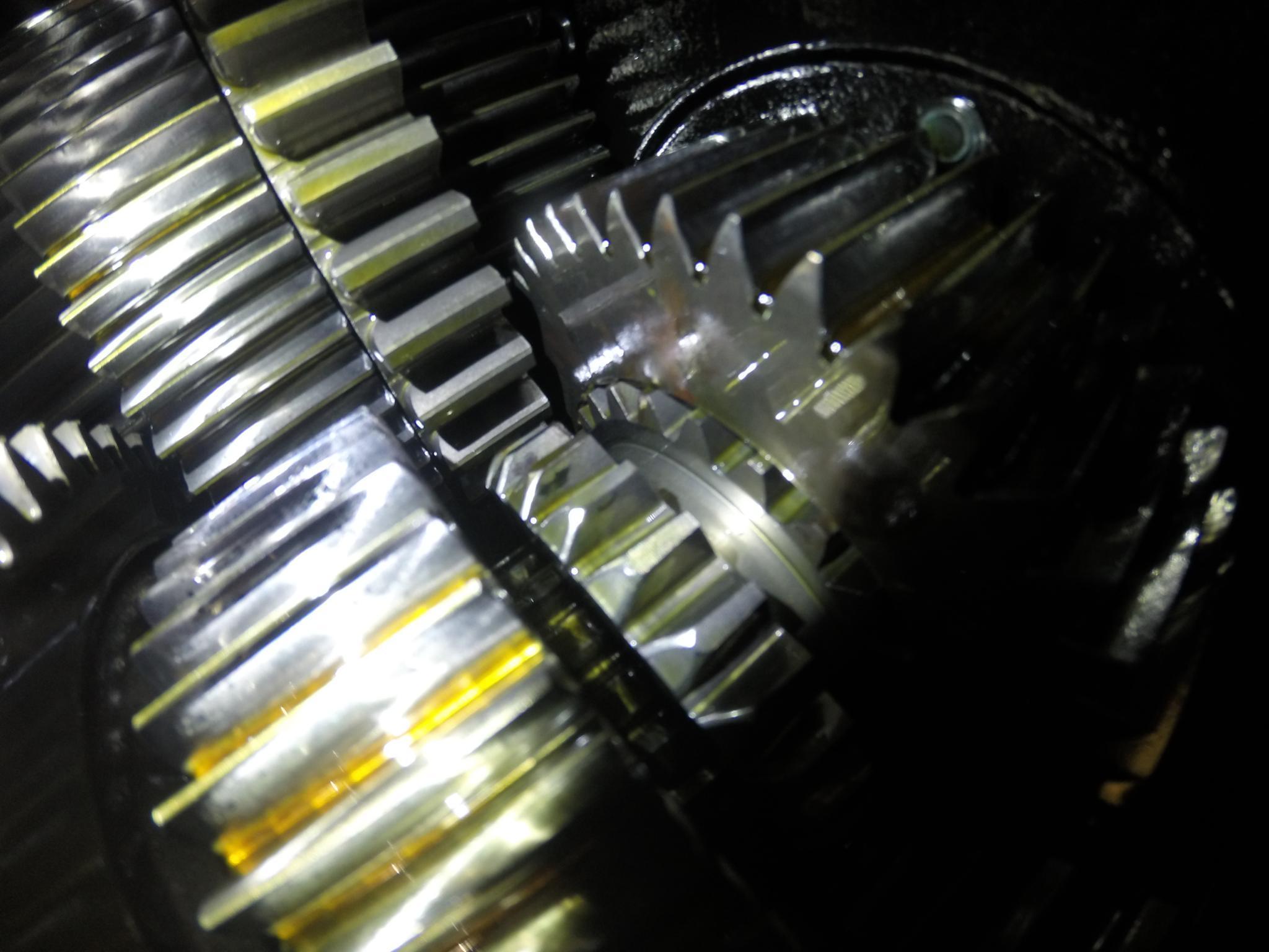

Close-up of 10th gear after million miles (the smaller gear in the middle) ..
Close-up of 9th gear after 1 million miles (the smaller gear in the middle) ..

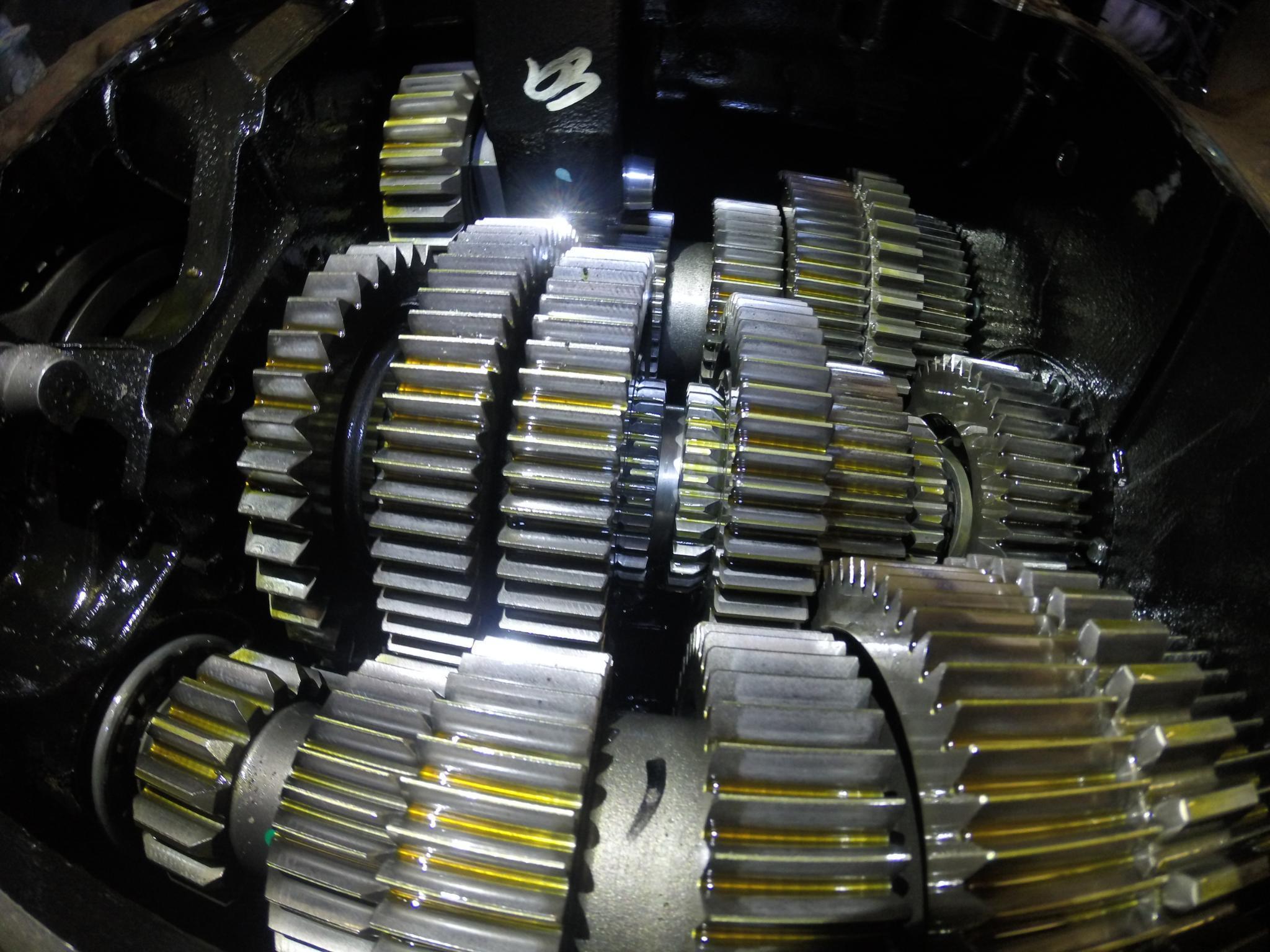

Here is an overview of the rest...
That is what the results are. You can see a tiny bit of wear from use, but nothing that would indicate anything harmful at all.

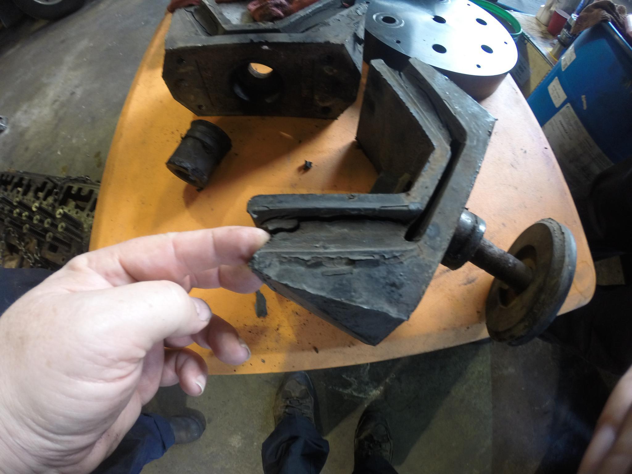

Just to let everyone know, it is a good idea to replac e rear engine mounts when tranny is out. it is a LOT easier to replace them that way. Here were mine after 1 million miles. The rubber on them was just starting to tear and crack. i suppose if we had driven the truck harder, they would have been much worse. Also the bottom bushings that hold them to the frame were worn down pretty badly.
