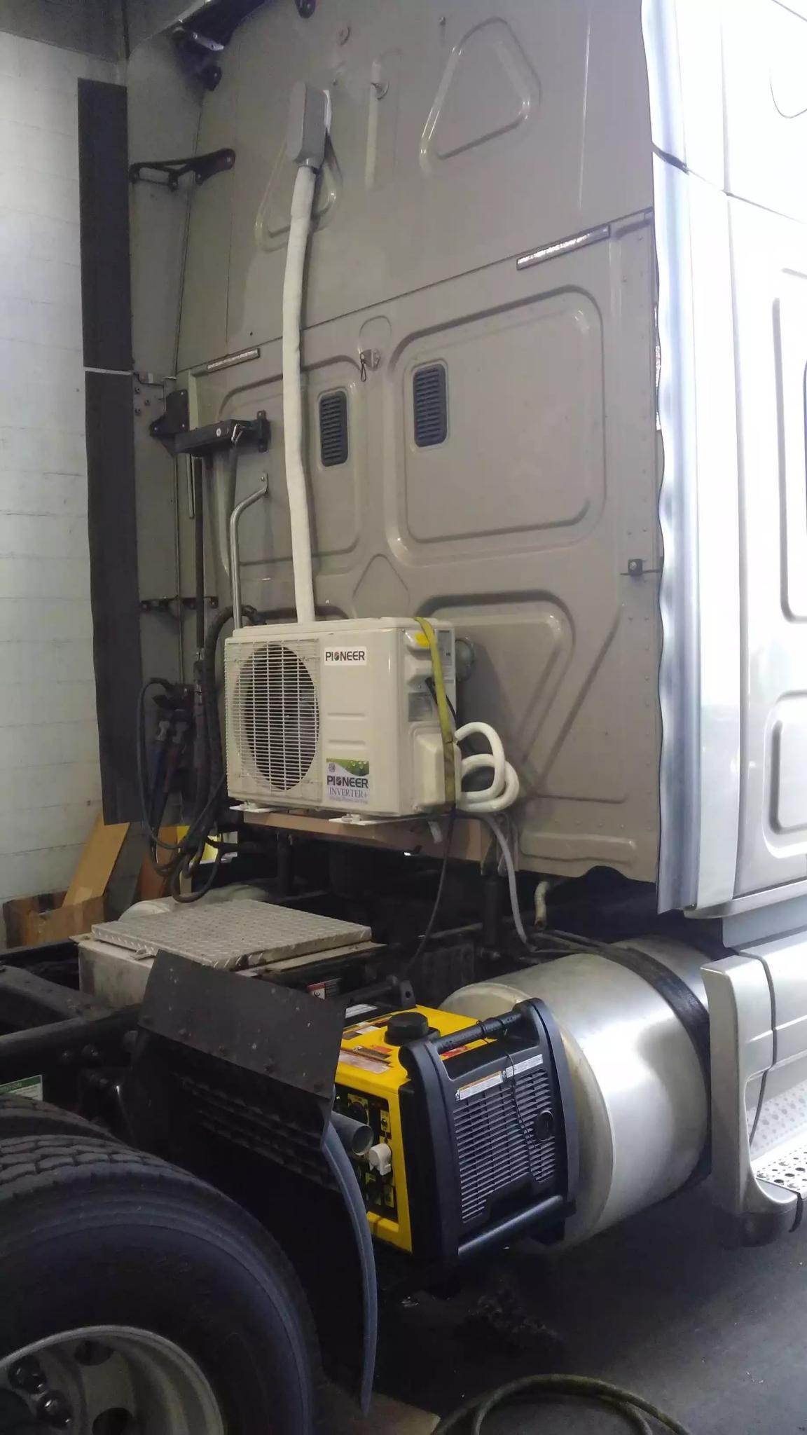

(03-12-2017 )snailexpress Wrote:  Here is my home brew setup.
Split system AC.
Powerful and quiet.
No weigh moving forth and back every stop.
No openings cutting.
All space inside sleeper still available.
Generator has fuel from truck fuel tank, remote start.
This is exactly what I was thinking about doing. I see them all the time on RV; I don't see why we don't have them on trucks.

That split AC system is pretty slick.

I mounted an 8000 btu house wall ac in the back wall of my Prostar and run it with a generator.It worked great for a year and then at the end of last summer the ac wouldn't blow cold. I could hear the compressor kick on but no cold.My guess is it has lost its freon. Bought a new one to slide in for $200 so I'll switch them and see if the old one can be charged for a spare.Used a 3500 watt generator ($400) the first year and built a box for it on the catwalk with vents and a cooling fan and insulation for noise. worked well and has a remote start so I could turn it on or off from the cab. I felt that the box still holds too much heat so I think I will replace it with an inverter generator this spring. All and all its still a good system for not much money. ( I'm cheap)
