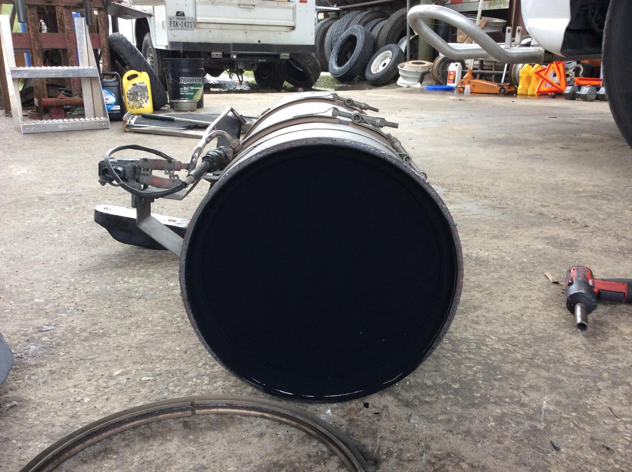

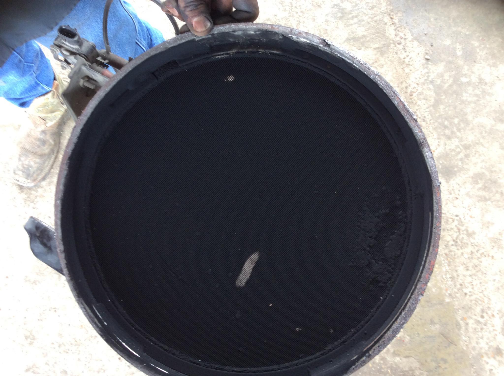

| RE: Regen light on Update: yesterday ran from Ardmore, ok to Kansas city then on to Joplin, mo. No regen light for the miles traveled. Next am after starting motor, regen light came on. Did forced regen. Made it to beaumont, tx, DPF light on again. Doing forced regen this am. Gonna drop can and inspect, will post some pics of doc face. Also found exhaust leak, just behind the doser. User's Signature: It's hard to win an argument with a smart person, but it's damn near impossible to win an argument with a stupid person | |||
