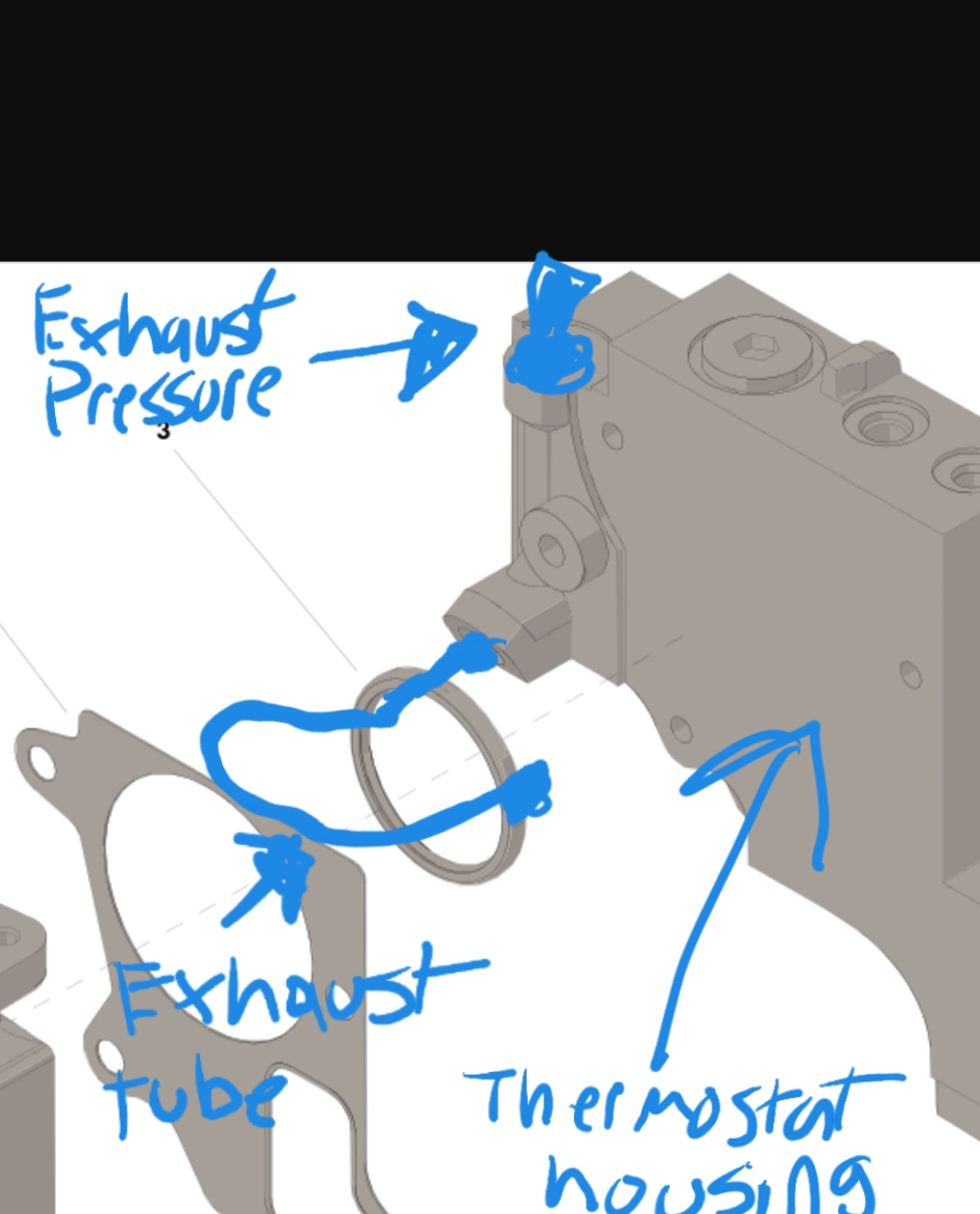

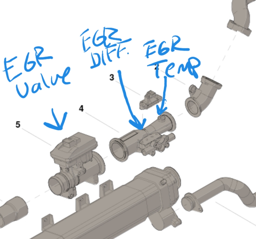

03-04-2020, (Subject: ISX egr tuneup vs X15 egr tuneup )
Post: #25
RE: ISX egr tuneup vs X15 egr tuneup
It's on the exhaust side above the exhaust manifold in front of the egr valve, one is on the thermostat housing and also has a tube directly below it going to the exhaust manifold that needs to be blown out with pressurized air.

03-11-2020, (Subject: ISX egr tuneup vs X15 egr tuneup )
Post: #26
Thank you!
I got all of those sensors replaced by myself, with the help of people here!
I'm not sure about that tube yet. I'll have to take another look at it.
What about that big tube that goes from the drivers side up over the top of the motor? Does that need to be blown out or cleaned also?
Thank you for your reply it has been a huge help!
