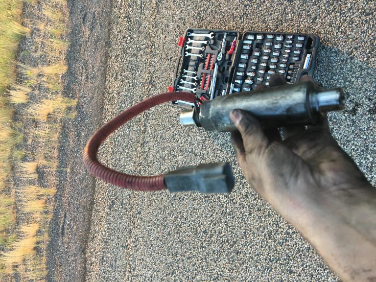

Replace the transfer fuel pump. Cheap inssurance, replace the electric transfer pump on Cm2250 isx It may save your engine, mine failed and looks like it starved the main pump broke the ceramic plungers, and I may need an engine now. Very easy took 30 min on the side of the road | |||

RE: Replace the transfer fuel pump. No shavings, and the main pump was the 2 piston with ceramic plungers, It didnt give a hint of going out, it was $ 220 at a volvo dealer in cheyenne, wy | |||

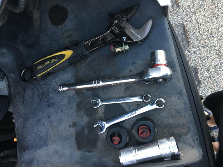

RE: Replace the transfer fuel pump. I changed the washers on the banjo bolts around $12 for 4 of them | |||

RE: Replace the transfer fuel pump. Tools used | |||

RE: Replace the transfer fuel pump. Truck died wile driving on highway, stopped and dindt want to start, Transfer pump was not turning on with ignition on, checked the voltage pump was getting 12+volts. Losend up the front banjo bolt no flow. Got a rentacar and located a pump, installed it started fllowing and still didnt start, Losend up the front banjo bolt on the rail to test the regulator it was good no fllow, Banjo bolt at the back of main pump was getting planty fllow, how ever primary rail very little perssure wile cranking, on insite the pressure was only 200psi wile cranking it should be thiusands. Did few more tests, all this with over the phone help of {***}. Towed it to dealer and the opened the pump cover plungers were shattered | |||
