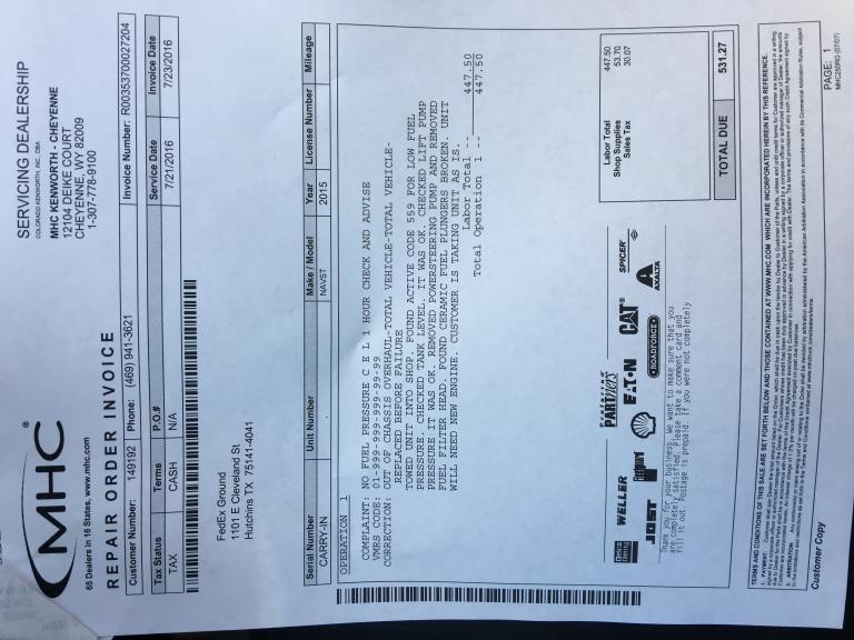

And the bill for the diagnostic./uploads/201607/post_1749_1469296771_450c31d95f59d1c9fe4dff0207936b8f.jpeg

It's probably junk because it's in that series of engine with the ceramic plungers and you only have their word it ran. It could be DOA from the same issue you just had. Bad plungers. Just my thoughts.
