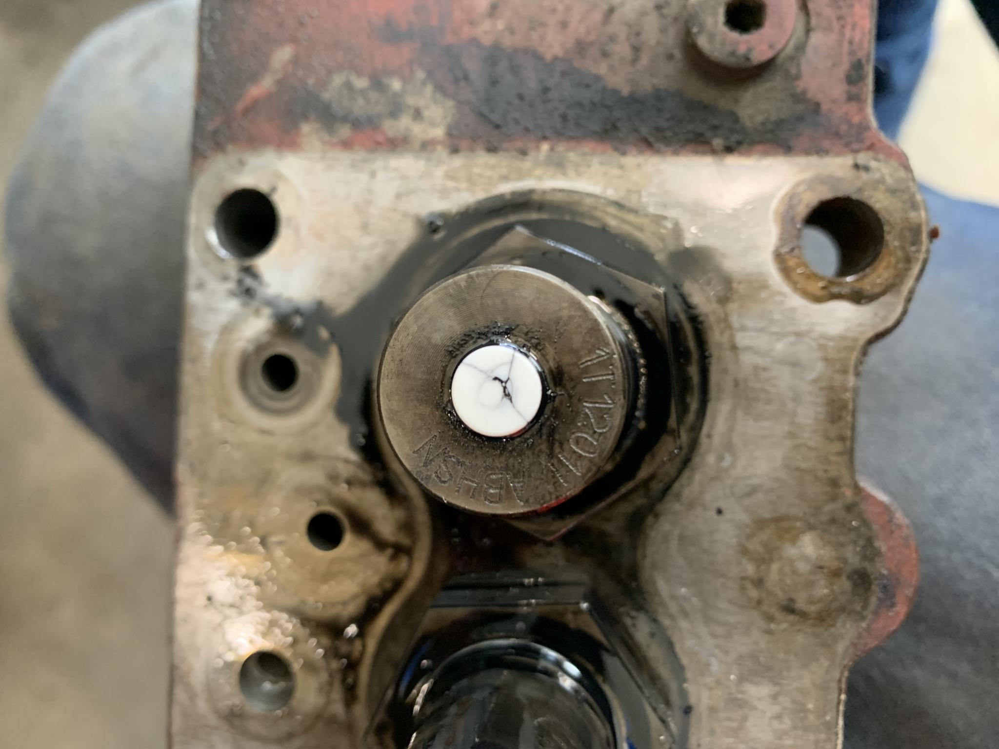

RE: ISX15 CM2250 fuel pump timeframe? (10-21-2021 )lwilder27 Wrote: Catching up with fuel pump rebuilds since finding this post and found this one yesterday. Thanks for all the good information on here. I think I am safe from any engine damage on this one since it did not break apart. This was an ISX12 CM2250. someone got lucky on that one. User's Signature: ->: What I post is just my own thoughts and Opinions! --- I AM Full Of S__T!. | |||

| RE: ISX15 CM2250 fuel pump timeframe? Damn!, just in time....I'd like to see the condition of the lobes and the rollers. Still curious if the erratic motion they cause upon failure is what begins this whole process. What was the mileage on that one? | |||

RE: ISX15 CM2250 fuel pump timeframe? (10-21-2021 )SquareOne Wrote: Damn!, just in time....I'd like to see the condition of the lobes and the rollers. Still curious if the erratic motion they cause upon failure is what begins this whole process. They looked fine. Mileage was 595,000. I know, borrowed time. Still catching them all up! | |||
