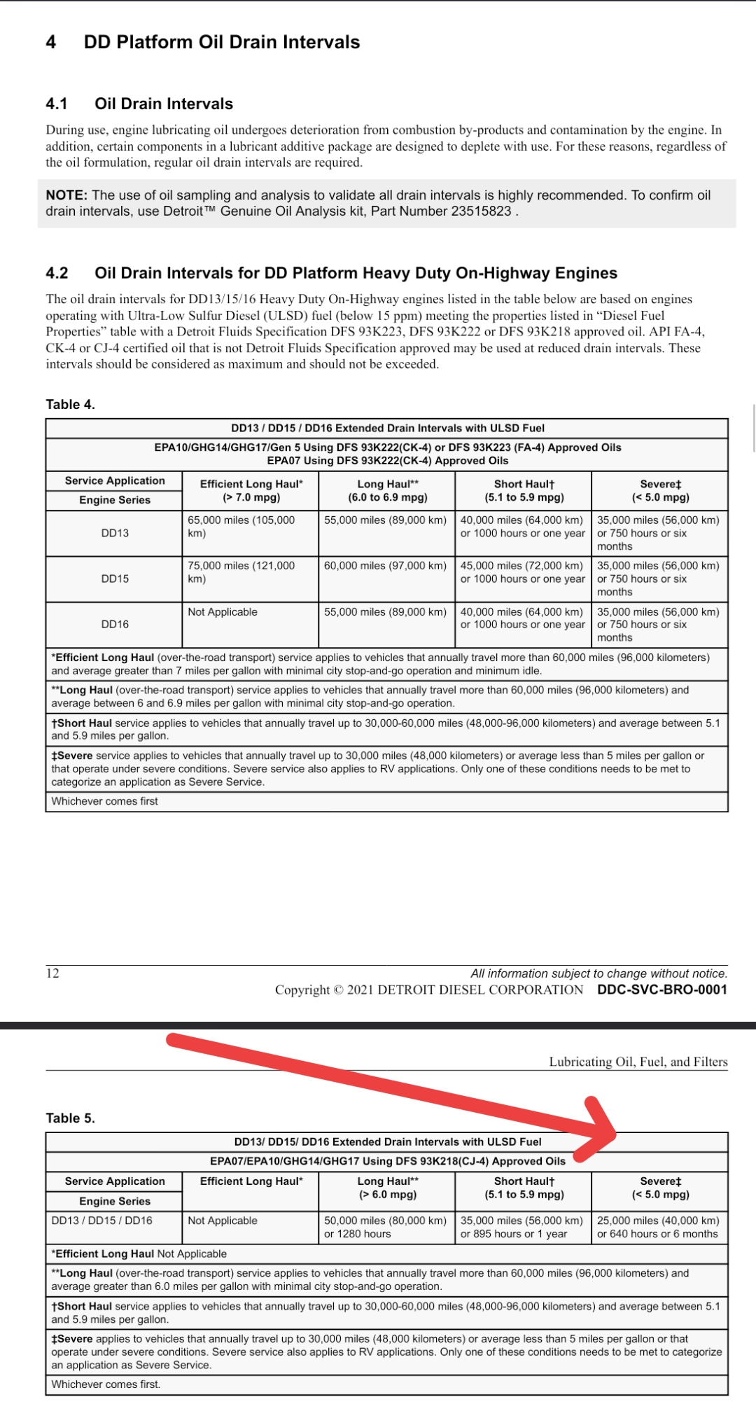

RE: 2016 DD13 GHG17 Cascadia - DPF filter longevity (01-09-2026 )mikkhh Wrote: How long oil change intervals? Every 40.000km. I could go more, according to freightliner, but I prefer to follow the severe duty cycle. I do OTR/regional. Midwest/east coast. https://www.summitracing.com/parts/vlv-818289 This is the oil I use. Couldn't vouch for this oil enough! I am going to look at those videos, but I am presuming you guys will agree that mineral oil on these newer engines is a no go? | |||
| Yesterday, (Subject: 2016 DD13 GHG17 Cascadia - DPF filter longevity ) Post: #8 | |||
| RE: 2016 DD13 GHG17 Cascadia - DPF filter longevity 40 000km is way way way too long oil change interval especially on mandated engine. How the engine looks inside? Really nasty and sooty? I buy my oil usally in 208l drums. I use cheap 10w40 semi sythetic oldschool truck oil with added gear lube in all my equipment - mandated or pre mandate diesel cars, mini excavator, telehandler, even toys like PWC that have 1.5l 260hp supercharged gasoline engine. I used to buy 15w40 mineral, but it is not stocked anymore at the place where I buy oil and drum of 10w40 costs 10 bucks more than 15w40 drum. Winters can get -25c in my area that is also why I chose 10w40 this time. That super fancy fully symthetic oil costs 2-4x more, I buy cheap 15w40 mienral or 10w40 semi synthetic and do 2-4x more oil changes. I used to run 15w40 in early 2000s diesel german cars year round even at winter for like last 7 years without any issues, also even to this day 15w40 oil in on oldschool diesel loader 12valve 5.9 engine is working with that oil for more than 15 years, max 2000hr farm use time, in it's former life it had 30 000 hours, no rebuilds, worked in a mine, had pretty hard life. Most likely it had 15w40 in it since day one. | |||
| Yesterday, (Subject: 2016 DD13 GHG17 Cascadia - DPF filter longevity ) Post: #9 | |||
RE: 2016 DD13 GHG17 Cascadia - DPF filter longevity (Yesterday )mikkhh Wrote: 40 000km is way way way too long oil change interval especially on mandated engine. I believe you! But as much as I know that older equipment runs well with those oil and mixtures, from all I have read and seen freightliner strongly discourages mineral oil or additives in the oil, especially on the newer Detroit engines. https://dtnacontent-dtna.prd.freightline...1_2021.pdf check here for The official Detroit info. Full synthetic for lubricity, low ash count to extend the life of the dpf, and extended oil drains (if you want to. I don't.) but aren't you confusing km with miles? 40k km is severe duty and the oil samples are perfect. One time I even did TBN/TAN and it was all good. Check the included attachments for proof. | |||
