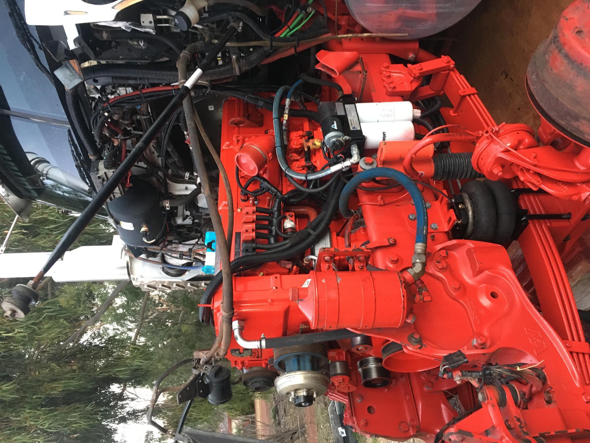

| 07-26-2017, (Subject: Cm570 build ) Post: #27 | |||
| RE: Cm570 build Bit of progress the last couple of days. Should be making noise by the weekend. Fitted up a new 2050 easy pedal clutch and did a heap of re-ferb work on the harness. Re bushed the spring mounts on the chassis and painted and fitted new springs while the engine was out . Still need to strip and clean the radiator and fit new gaskets on the tanks | |||
