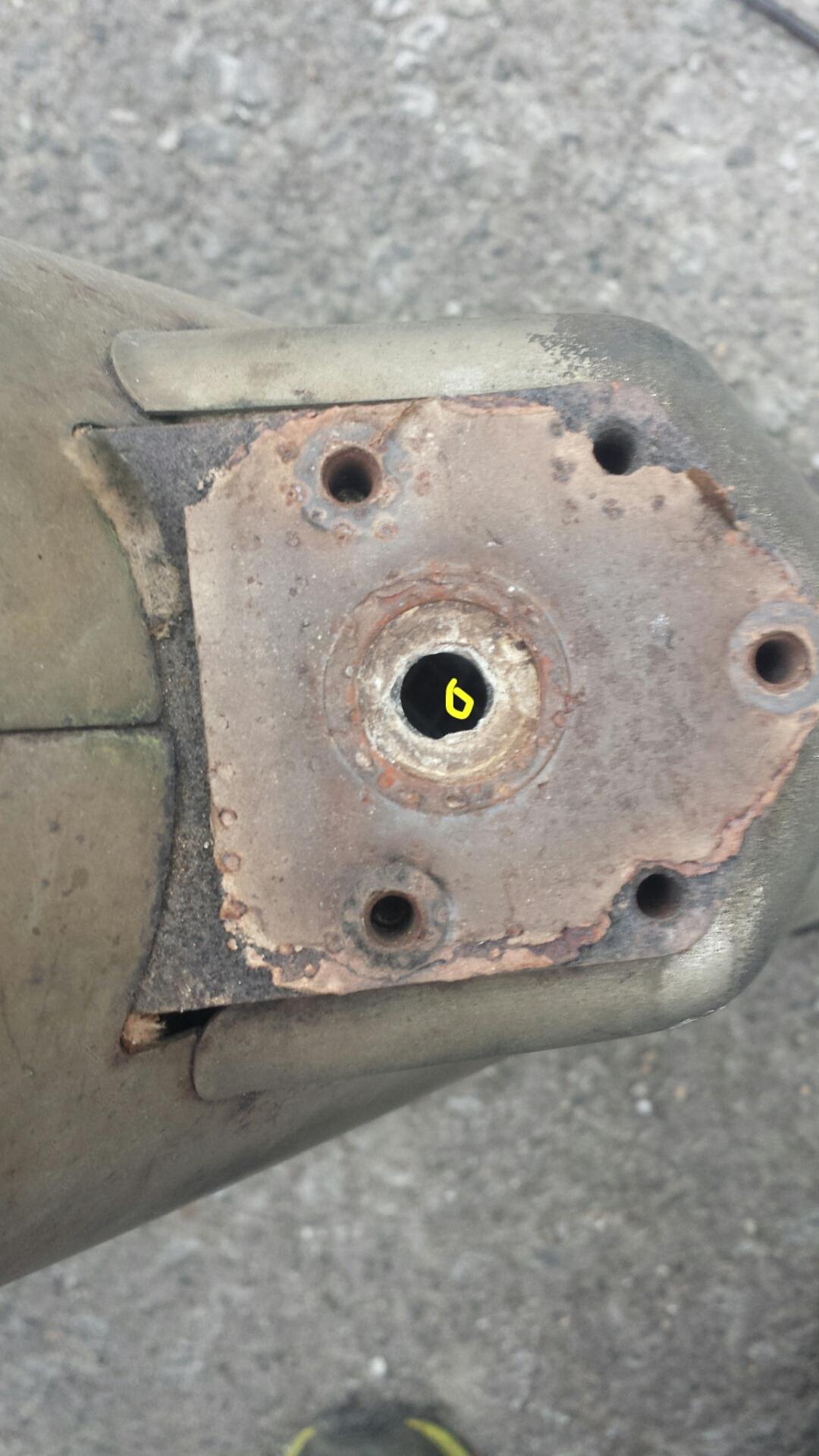

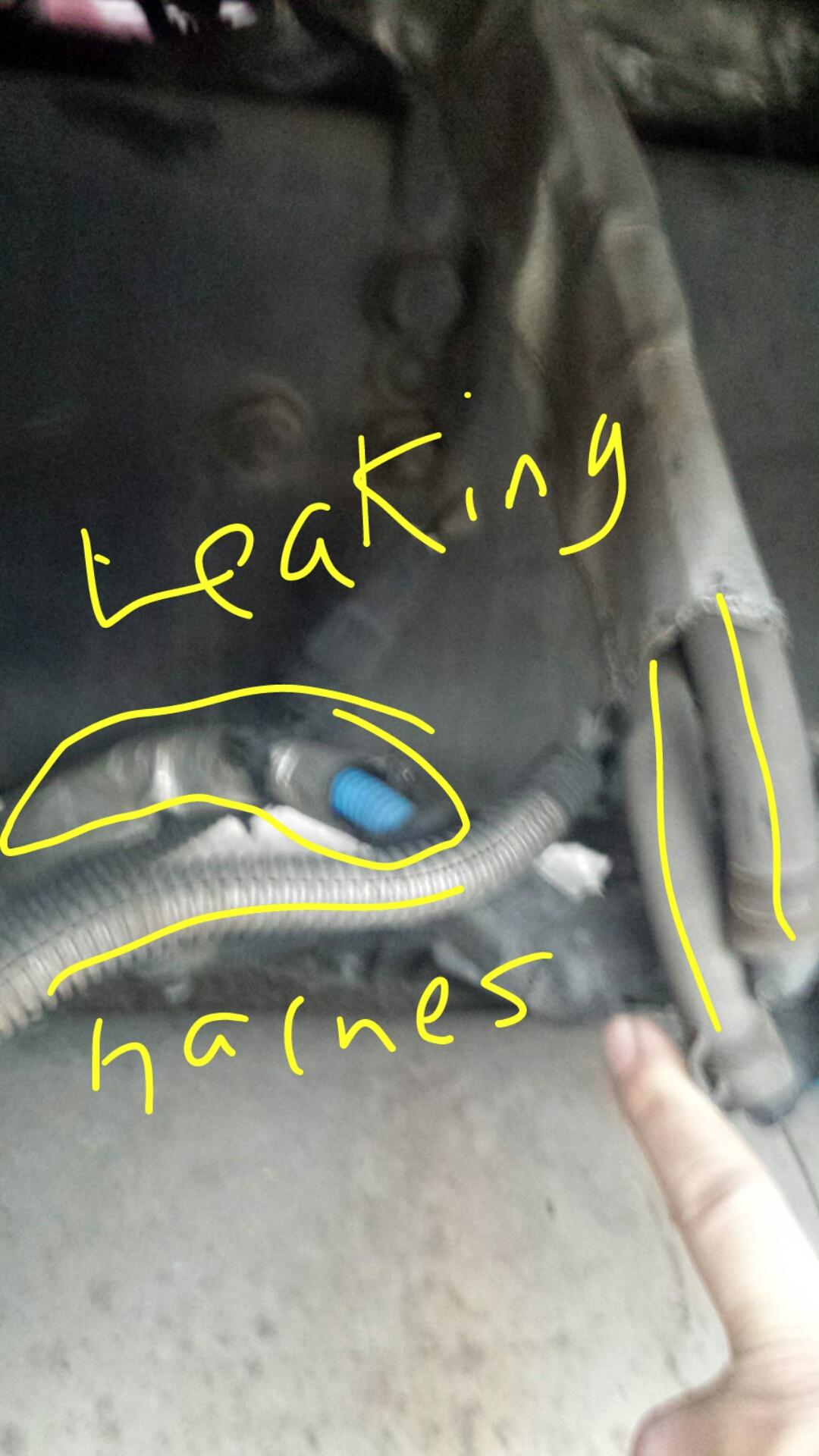

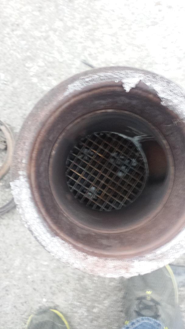

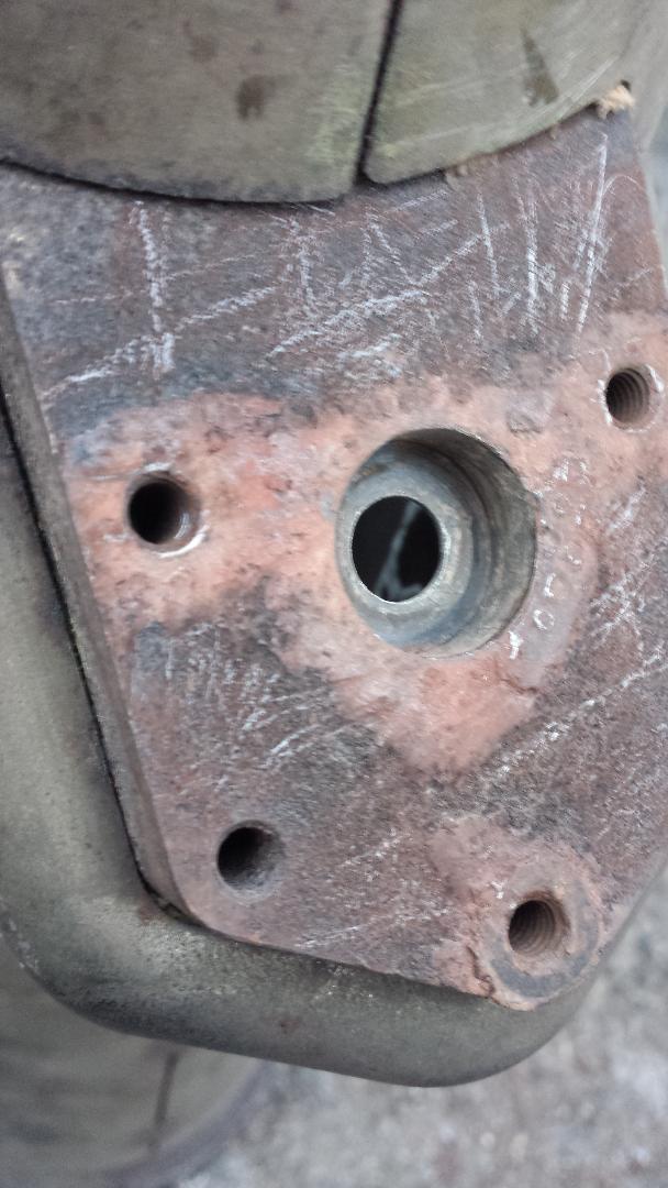

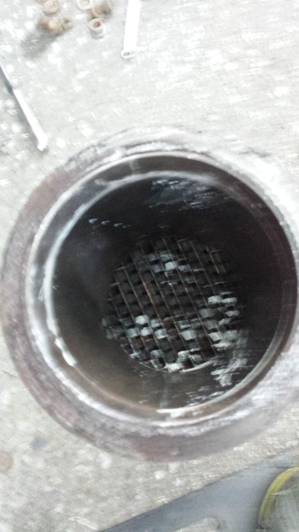

| Def leak code 4364 fmi 18 I had the code 4364 fmi 18 pop up so i did some searching, and did my diagnostics according to what i found. I found a leak, theres an image attached. Also took off def injector, found it pretty plugged up. The decomp tube wasn't plugged but the hole where the injector goes was plugged up. ![]() ![]() Picture with the yellow circle show how small the hole was before i poked it through. I cleaned it out. Will get some new clamps and gaskets for the scr tube and try to run it tomorrow to see where the leak is coming from for sure. I will also be replacing the def filter. Any advice is appreciated. | |||
