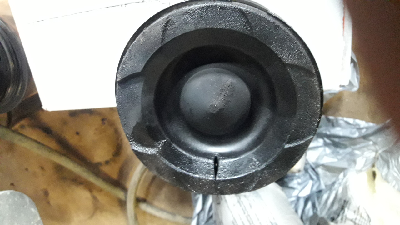

| RE: Massive oil leak... Do you happen to have a misfire? Reason i ask i just rebuilt a 2350 couple weeks ago and it did exactly the same thing. Oil was heavily blowing out the breather pipe and the valve cover gasket and made a huge mess. Ran perfect before it blew. Ended up being a hole in the piston. Sorry, no intention to freak you out, its just eerily similar to what i recently saw. | |||
