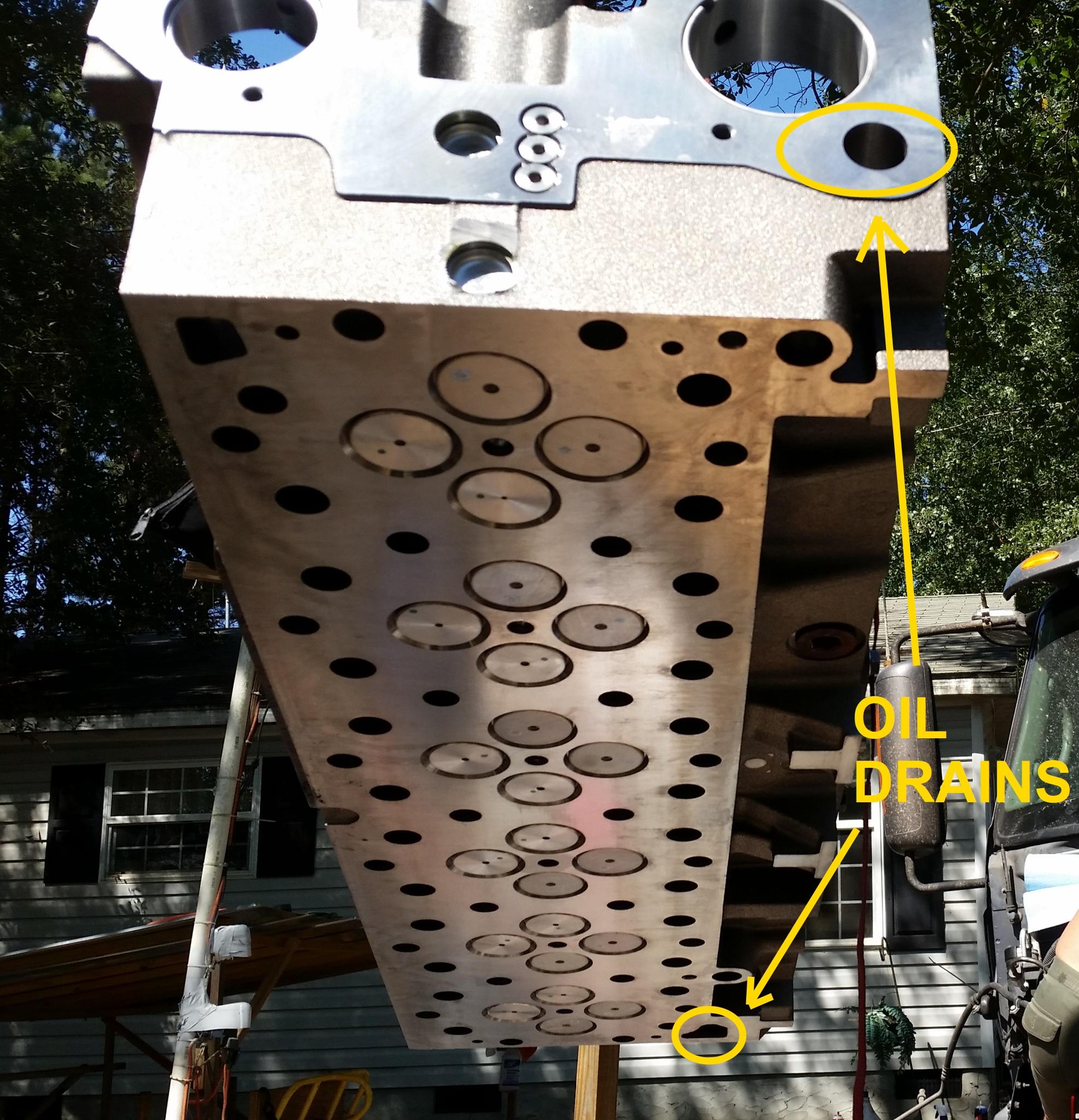

Oil pooling in top of cylinder head. |
08-15-2018, (Subject: Oil pooling in top of cylinder head. ) Post: #3 | |||
RE: Oil pooling in top of cylinder head. Signature620 is correct. There are 2 fairly large drains so that oil does not pool up in the head. Those openings/drains are fairly large so something does not sound right. You say it was recently re-manned,... did someone make a mistake with the head gasket? did they block them on purpose like a complete fool? -- did they forget a rag stuffed into them? User's Signature: ->: What I post is just my own thoughts and Opinions! --- I AM Full Of S__T!. | |||
