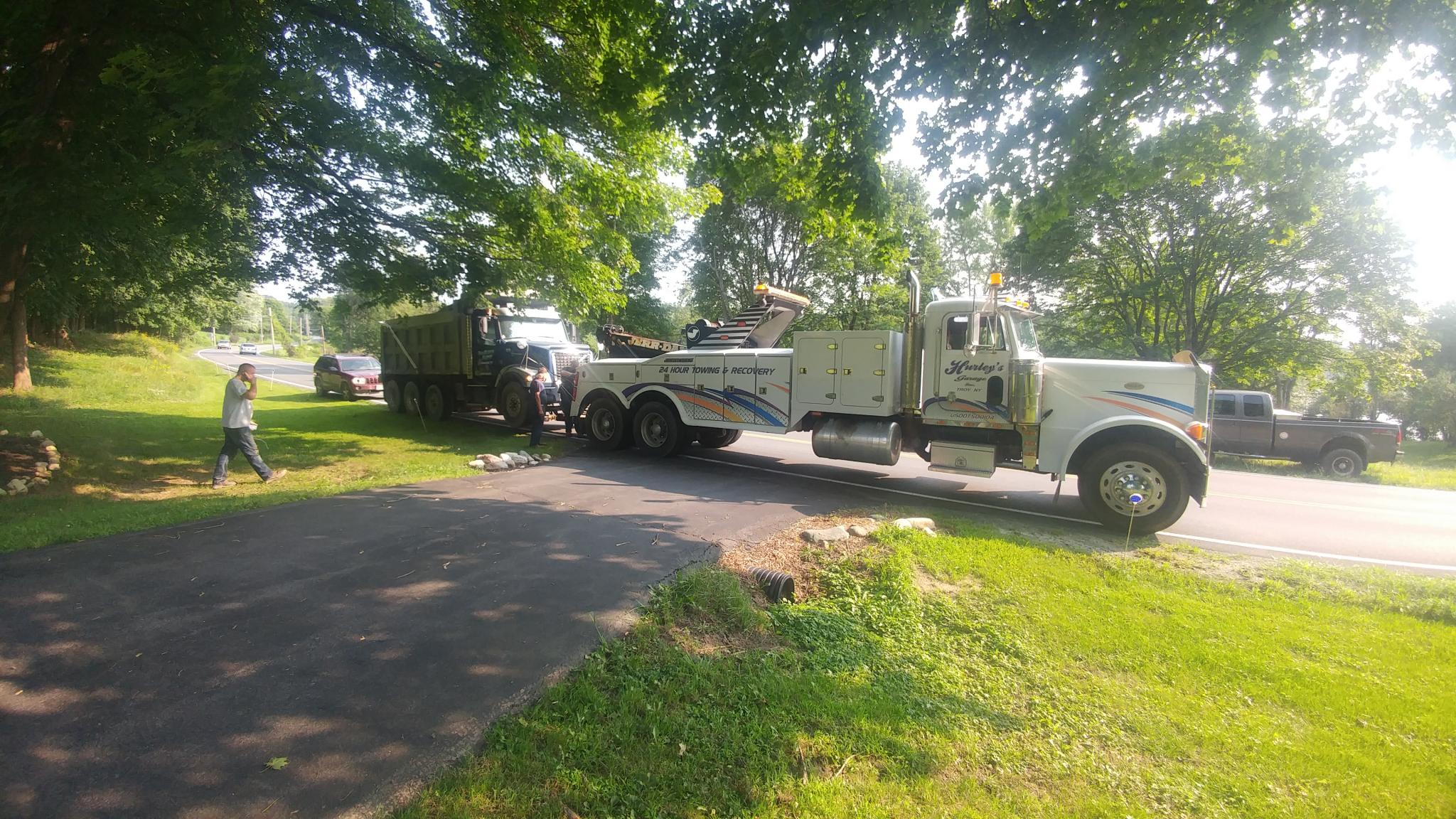

This gem of a d13 had a air compressor go bad with a load of black top on. A cummins or cat could be chan changed out before the load set up. Not on this chitball. Its a 6-10 hour job to do that. No thanks
