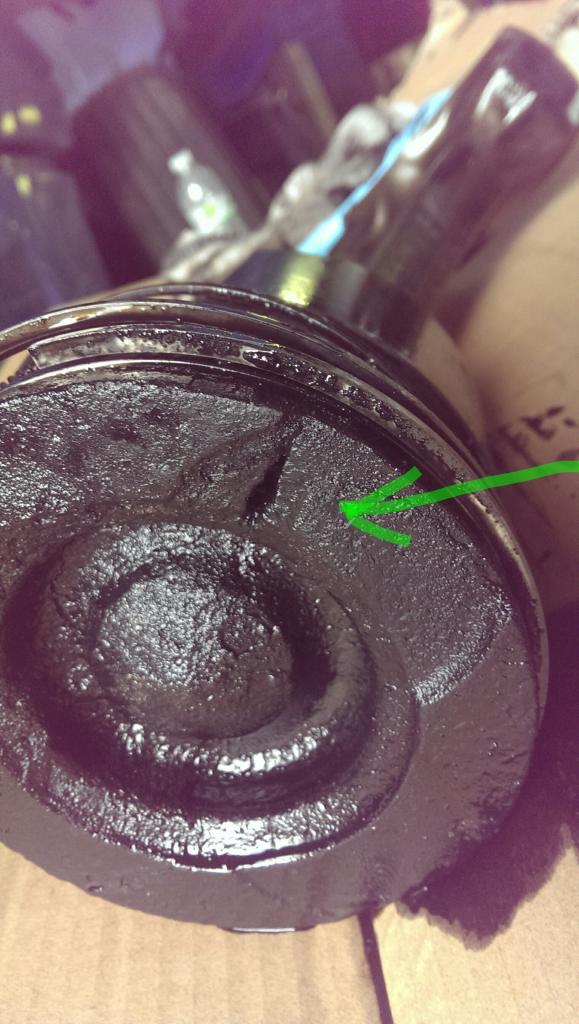

Don't want to scare you slowpoke but from my experience you have really bad sign. What is crank pan pressure (blow-by)is on this engine? can you check it at idle state and hard-hard pull.
ISX 871 I had did the same. Same as you did money waste with re builders. Probably 2 month later mystery was unveil
./uploads/201602/post_1794_1456590739_28a96dc50933de6cdb49dec5a3694776.jpg
