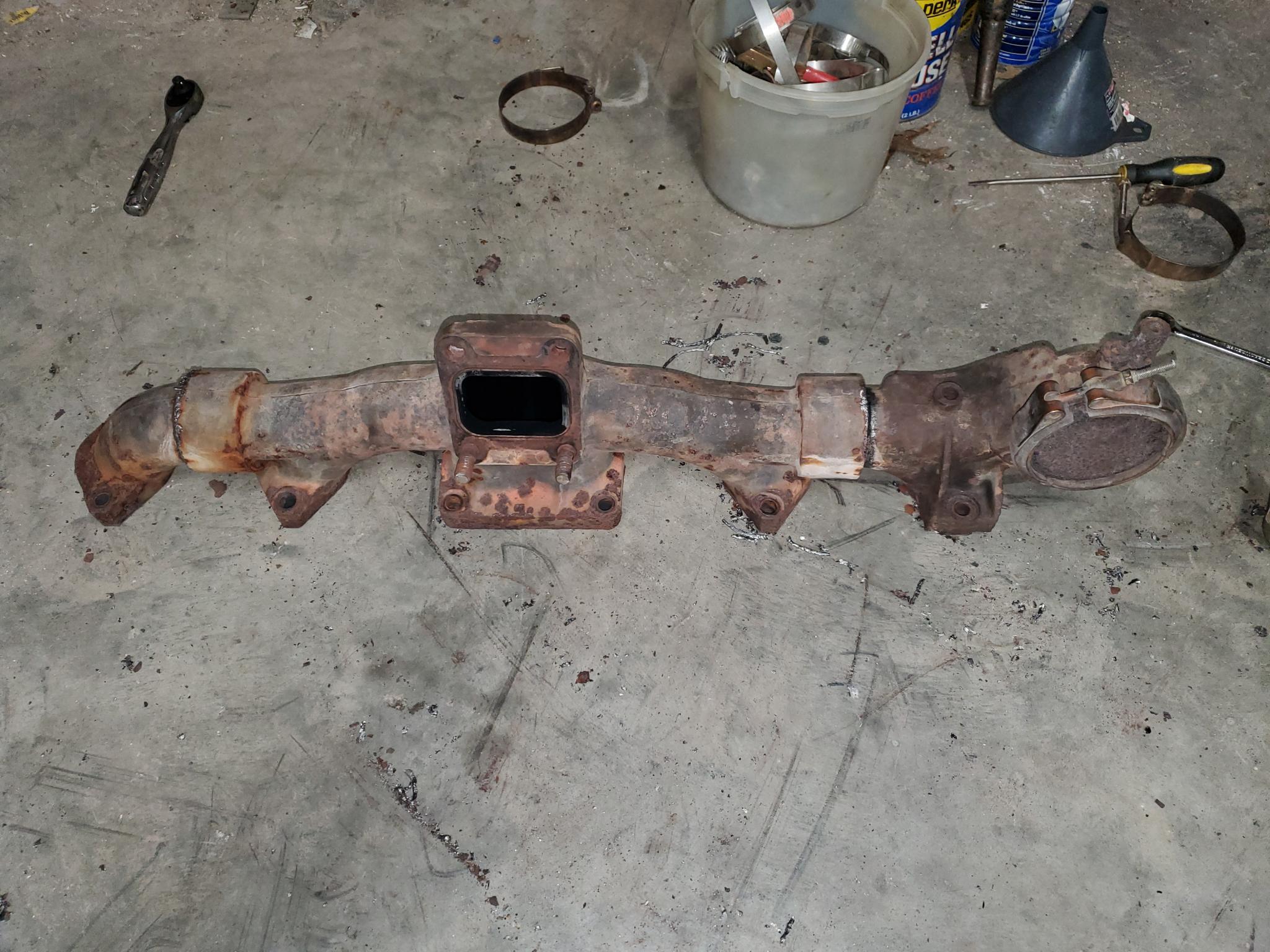

The manifold that I took off. The EGR end wasn't sealing anymore to the center section. So I replaced all of it.

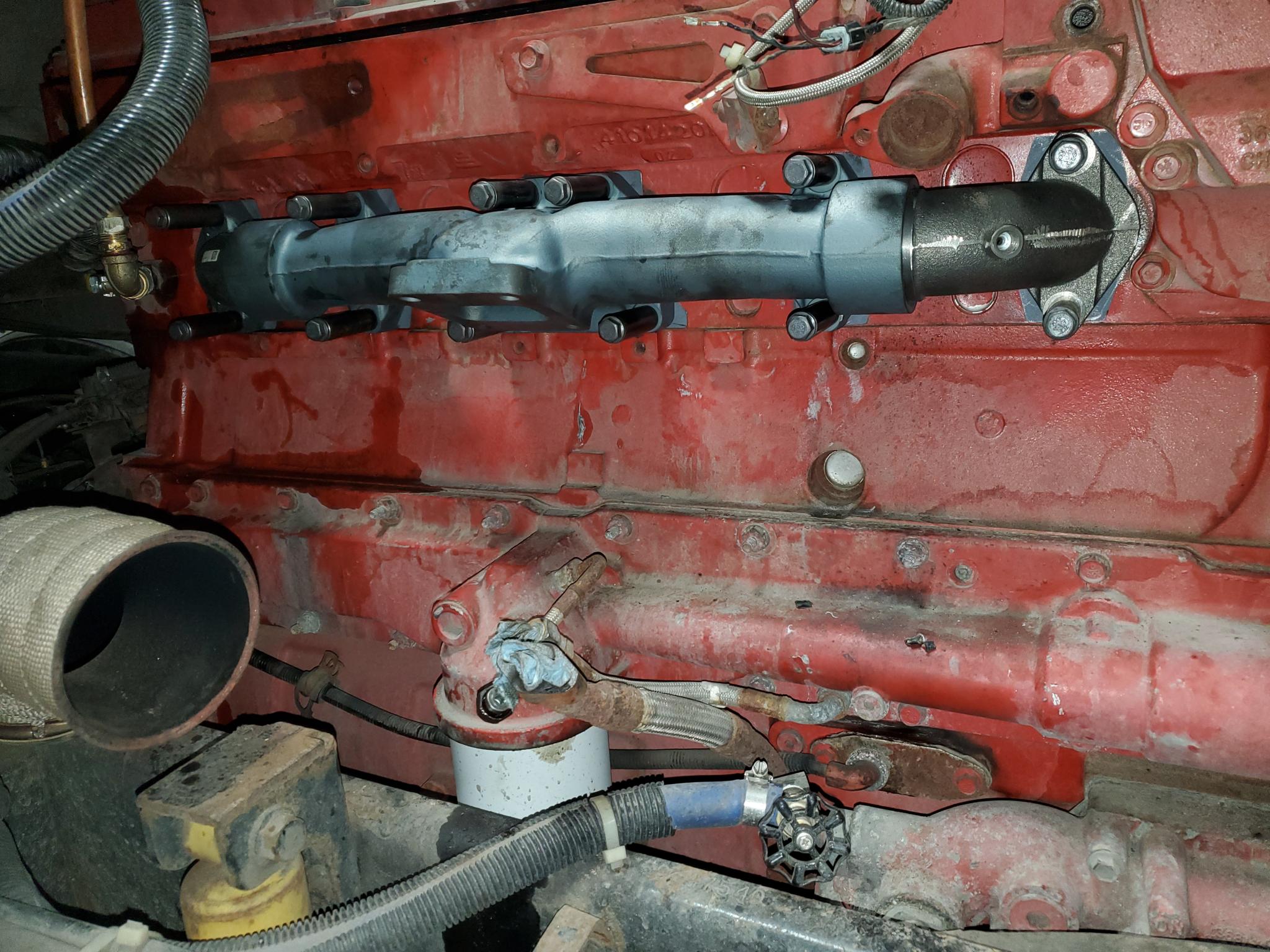

The new manifold with the EGR port gone. Uni hooked me up with a guy. Thanks again. Slid right in and worked perfectly. Bolts get torqued in sequence @ 44 ft/lb

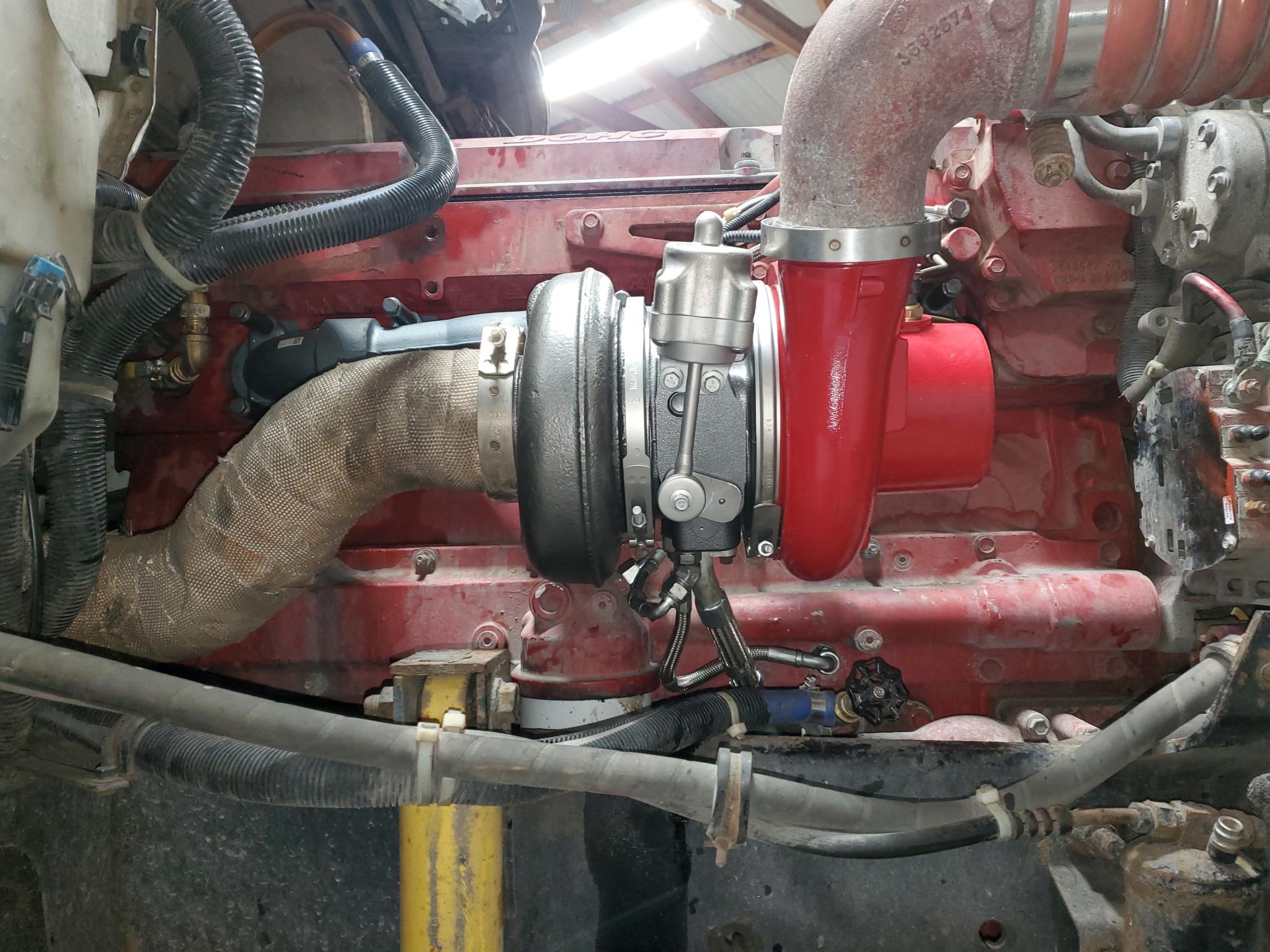

The YTS turbo showed up today. Looks and sounds great. I replaced all hoses and pipes even though some were still good. I'm not planning on dealing with them "piece meal" failing on the road.
This whole job can be handled by anyone with patience, a few torque wrenches and ambition to keep your money in your pocket.
