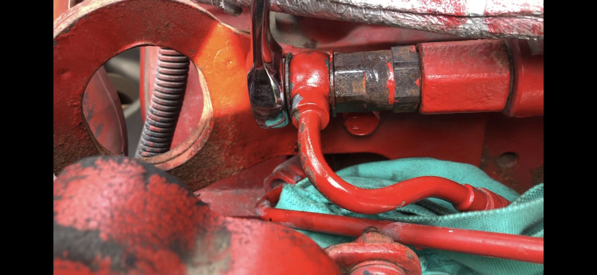

| 03-02-2020, (Subject: Isx 2350 485hp. Surges has no power ) Post: #32 | |||
| RE: Isx 2350 485hp. Surges has no power Hey, I did check the fuel return valve and I think is bad. I turned on the engine allowed to run for a bit and I loosened the hollow bolt it did started to leak fuel. I also turned off the engine and as soon as as it stop I loosened the bolt and it did leak less but it did. Did I do it right? https://youtu.be/A0z8JZMdlbE | |||
