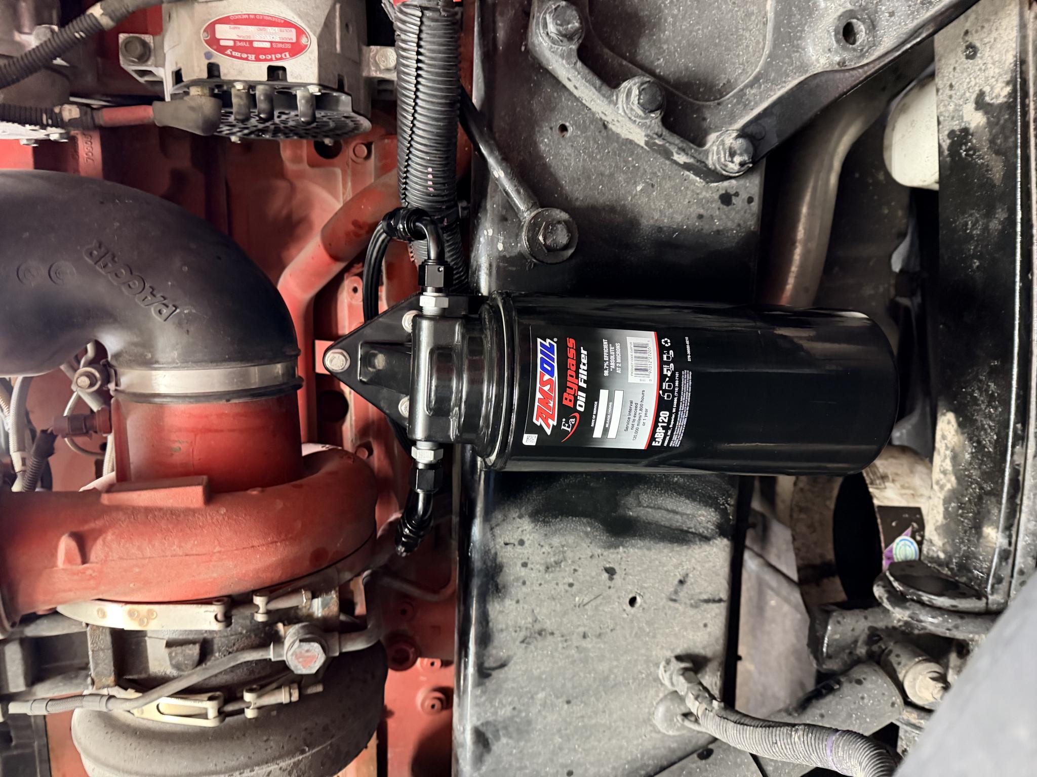

Only took me 7 years to finally install mine.
I used Evil Energy fittings and their PTFE hose for mine. They even had the M18x8an and m14x8an fittings, and any -an swivel end you could want. Soot/insoluble was never bad number on OA, but I'm just sick of seeing black oil haha.
