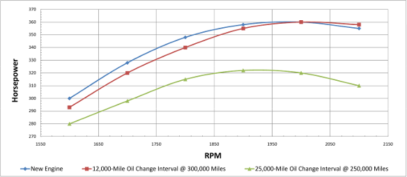

For those blind optimists reading this who think there is no engine life penalty associated with extended oil change intervals, the best data available disagrees strongly. In a study performed by the Cummins Inc., where 9 engine power tests were performed on engines which had different oil change intervals of 12,000 and 25,000 miles. Diesel road tractor engines have very large sump capacities, and their oil change intervals are naturally longer than for other consumer vehicles, so optimum intervals needed to be tested. Here are their results...
[attachment=1182]
Figure 1 - Engine Power Loss as a Function of Oil Change Interval
Figure 1 graphically illustrates how after 300,000 miles with regular 12,000-mile oil changes there is a small 2% average across the board power lost due to wear. Also the overall parasitic friction loss is lower, which raises the available power at high rpms. On the other hand, When the oil change interval was only done at 25,000 miles, even at a lower total accumulated mileage of 250,000, the power loss at all engine speeds due to engine wear is dramatically higher, averaging over 10%!. This means there roughly, is a 10% loss in power due to wear alone over time simply because of not changing your oil often enough, especially as the engine gets older. Cummins themselves, clearly show that their recommendation to change the oil every 25,000 miles CAUSES MORE THAN NORMAL WEAR!.
Do the right thing,.. change your oil based on your fuel consumption instead of regular mileage intervals.
[attachment=1182]
