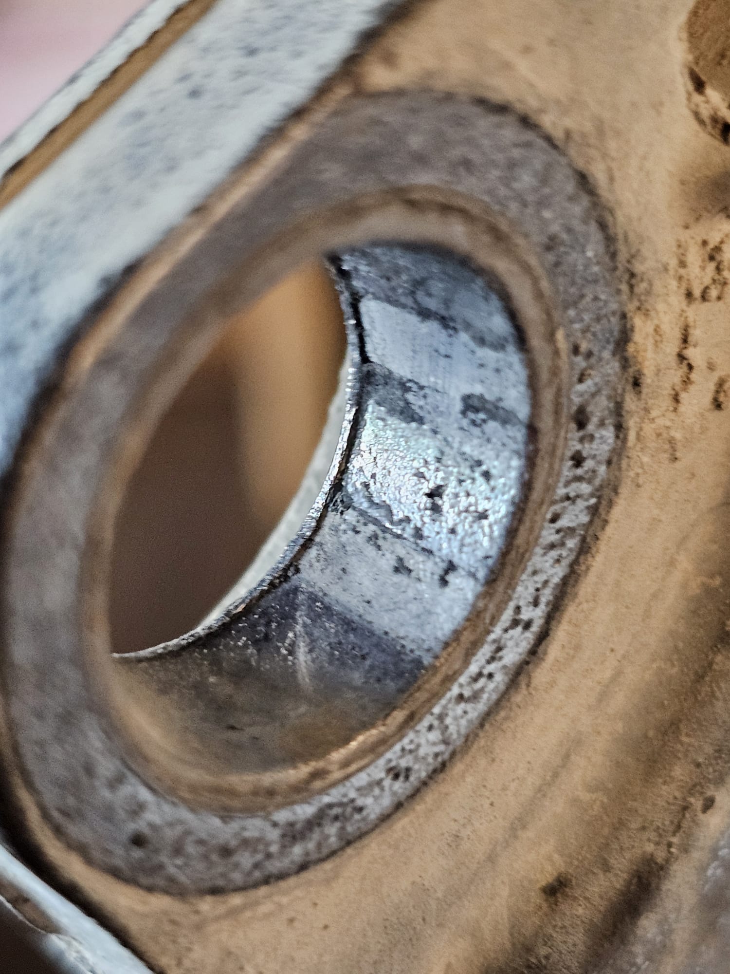

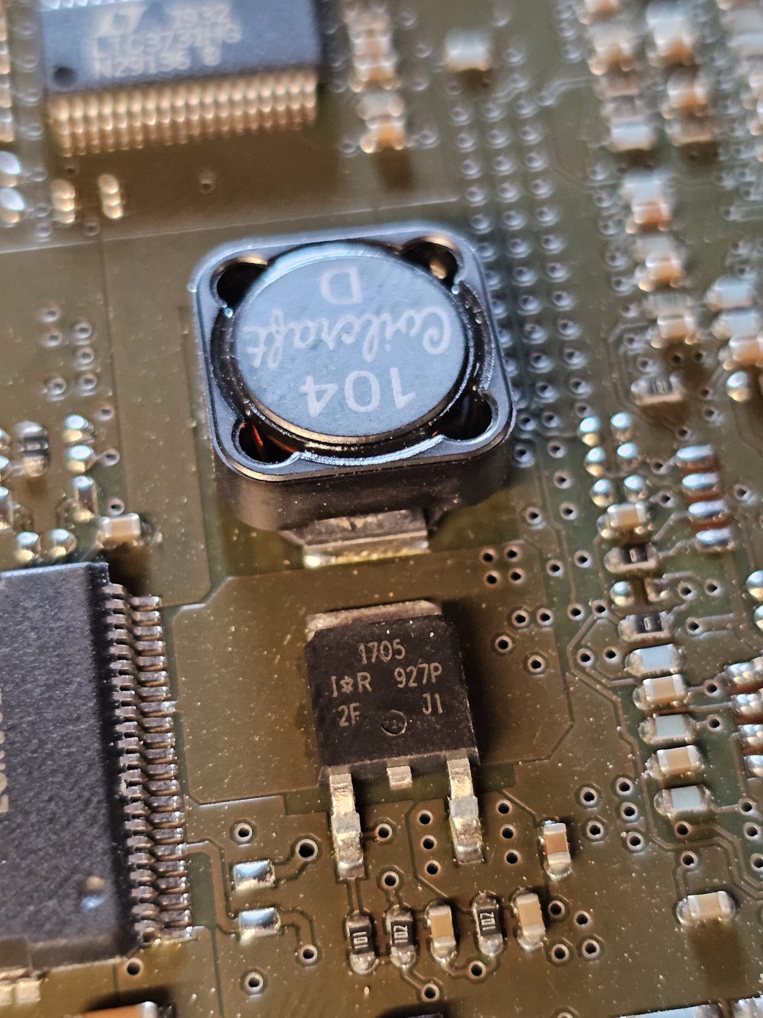

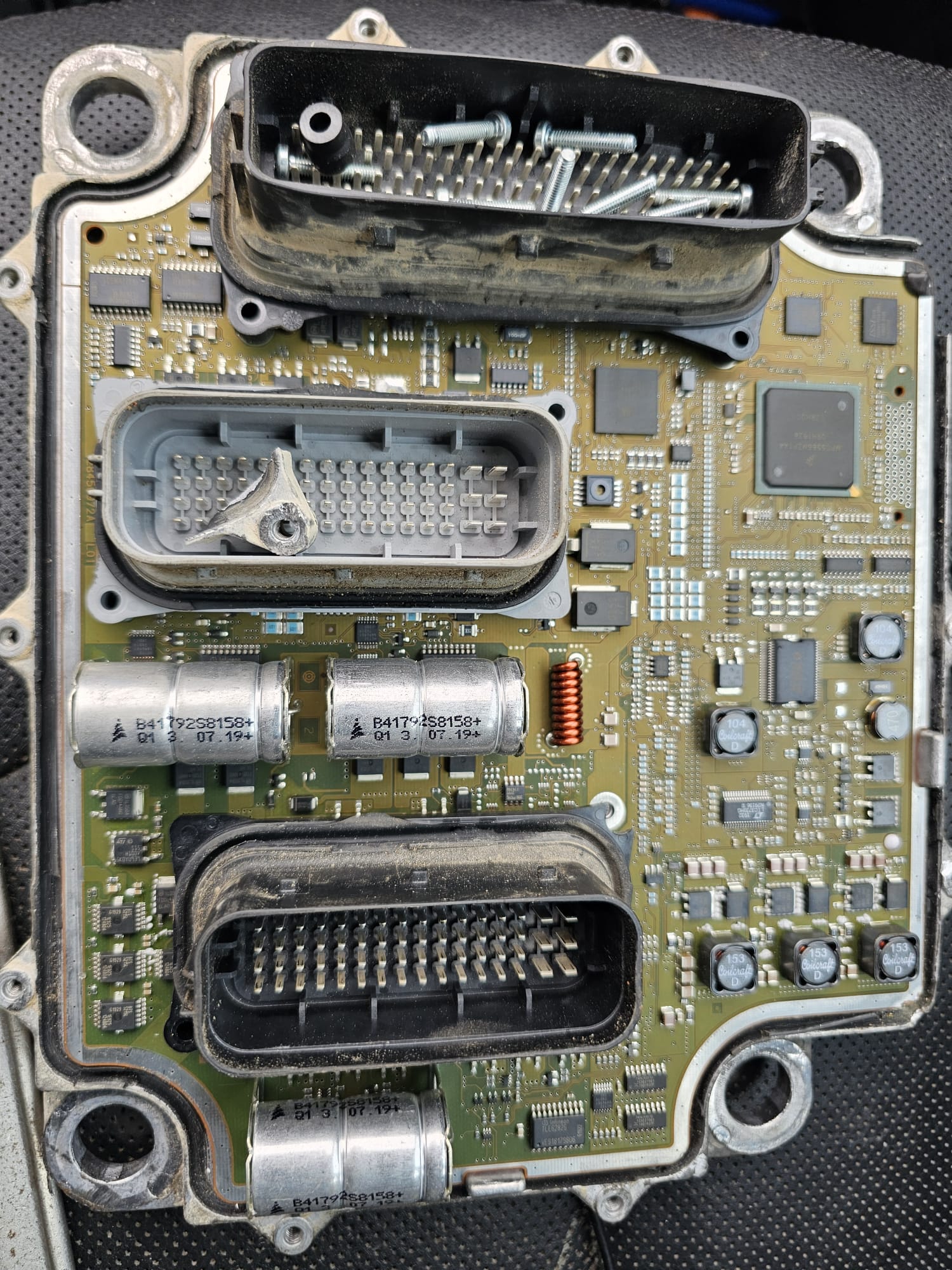

| RE: 2021 MX13 pac car dpf and scr efficiency issues in need of egr tuneup ECM is damaged. Opened up found one ceramic capacitor damaged and also more things. I did damaged ecm a bit taking it apart. New ecm would be 2k + 1k fitting (truck is not moving and dealer guy has to drive there). I am going to fix it for less then dealer guy is charging for fitting and the towing would cost. I am not going to give any warranty for that work, that is going to be so they could drive truck to dealer and get ecm fixed. Total time for me to fix the ecm is less than four hours, but these ECM s are really hard to take apart. ECM mount bushes are completely shot. There is one inductor cover that is loose from all the vibration. ![]() ![]() | |||
